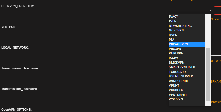

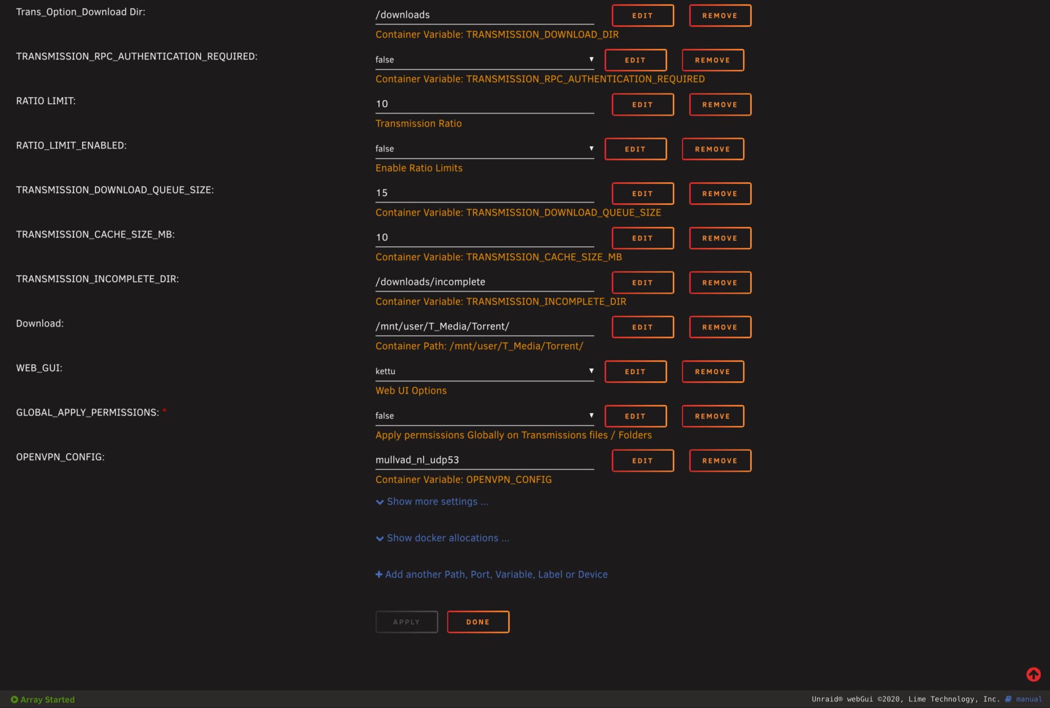

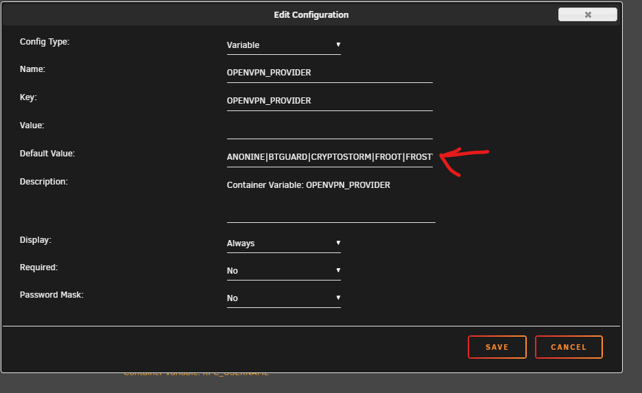

Hi there! I am attempting to setup the transmission VPN container with a mullvad VPN connection. I am getting the following error in the logs:
Using OpenVPN provider: MULLVAD
Starting OpenVPN using config mullvad_au_udp.ovpn
Setting OPENVPN credentials...
adding route to local network 10.0.1.0/24 via 172.17.0.1 dev eth0

I think you are missing settings in your VPN variable.
I'm using PIA, check the settings I have posted earlier, might find your answer. Probably need to declare additional values

I cannot figure the Transmission_VPN out for the life of me. I'm trying to use it with Mullvad.
I've tried renaming the ovpn file "mullvad_nl_ams.ovpn", I've tried "Netherlands.ovpn", as well as just default.ovpn and always make sure it matches up. Every time I get "Wed Jul 8 17:56:42 2020 Linux ip -6 addr add failed: external program exited with error status: 2". Any help? I can provide full logs if needed.
full log and your run command without your username/password would help

I removed the first OpenVPN variable and added this. Then went to Mullvad and ensured I grabbed the .ovpn from NL, UDP 53. Is this what I’m supposed to do?

@drogg can you post your run command (remove your username password, you can click force update and copy it from the window. Should look something like this:
root@localhost:# /usr/local/emhttp/plugins/dynamix.docker.manager/scripts/docker run -d --name='Transmission_VPN' --net='bridge' --privileged=true -e TZ="America/Denver" -e HOST_OS="Unraid" -e 'OPENVPN_USERNAME'='XXXXXXX' -e 'OPENVPN_PASSWORD'='XXXXXXX' -e 'VPN_REMOTE'='nl.privateinternetaccess.com' -e 'OPENVPN_CONFIG'='Switzerland' -e 'OPENVPN_PROVIDER'='PIA' -e 'LOCAL_NETWORK'='192.168.0.0/24' -e 'TRANSMISSION_RPC_USERNAME'='XXXXXXX' -e 'TRANSMISSION_RPC_PASSWORD'='XXXXXXXXX' -e 'OPENVPN_OPTS'='--inactive 3600 --ping 10 --ping-exit 60 --mute-replay-warnings' -e 'PUID'='99' -e 'PGID'='100' -e 'TRANSMISSION_DOWNLOAD_DIR'='/downloads' -e 'TRANSMISSION_RPC_AUTHENTICATION_REQUIRED'='true' -e 'TRANSMISSION_RATIO_LIMIT'='1.1' -e 'TRANSMISSION_RATIO_LIMIT_ENABLED'='true' -e 'TRANSMISSION_DOWNLOAD_QUEUE_SIZE'='15' -e 'TRANSMISSION_CACHE_SIZE_MB'='10' -e 'TRANSMISSION_INCOMPLETE_DIR'='/downloads/incomplete' -e 'TRANSMISSION_WEB_UI'='transmission-web-control' -e 'GLOBAL_APPLY_PERMISSIONS'='false' -p '9091:9091/tcp' -p '1198:1198/udp' -v '/mnt/user/T_Media/Torrent/':'/data':'rw' -v '/mnt/user/T_Media/Torrent/':'/downloads':'rw' -v '/mnt/user/T_Media/Torrent/watch/':'/watch':'rw' -v '/mnt/user/T_Media/Torrent/':'/mnt/user/T_Media/Torrent/':'rw' --restart=always --log-opt max-size=50m --log-opt max-file=1 'haugene/transmission-openvpn:dev'
c591f29ccbf40330ecaf6f27773c81bf446708dd34da7936d0e95336f487cf72
The command finished successfully!
Can you give me the command to run? Sorry, not super advanced in the terminal side yet.
EDIT: adding --sysctl net.ipv6.conf.all.disable_ipv6=0 as mentioned above fixed it!
Edited by drogg

On 5/28/2020 at 9:54 AM, latitudehopper said:
I can see SURFSHARK in the list of OpenVPN providers but it is not in the Unraid template dropdown. Is this just me?
I have the same issue. I'm using Surfshark and see the config listed on the GitHub but not in the drop down for selection in the Docker config. In fact I see 55 providers listed in the GitHub list, but only 48 in the dropdown.
Any providers that are new since MT last update to the template can be added by editing the field in the unraid template, it's been a while since I have updated my template.  I Cam have a look this weekend and add Amy me ones that are missing since my last update.

this field, add in your provider:
once added, choose your provider from the drop down:
