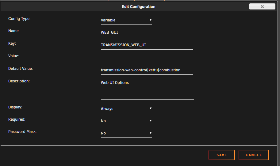

Another option would be to switch to a different UI ALTERNATIVE WEB UI'S . This is my current use, as some of the alternate UI's are very close to Transmission remote!!
I connect to my server with wireguard from my phone, or laptop, or whatever i have at the time!!
you can do this by adding the following variable:
Edited by clowrym
added alt UI's

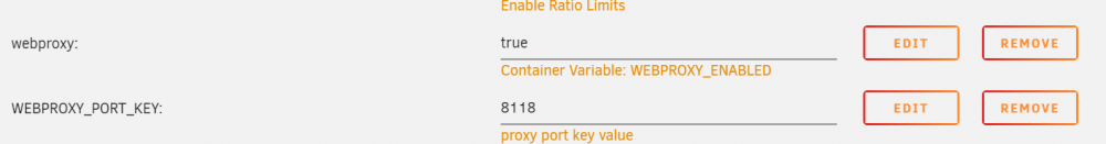

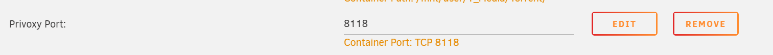

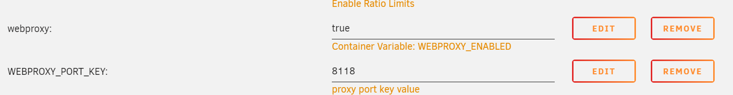

Would it be possible to add some sort of an socks proxy or ssh server to be able to also use the VPN connection to route other trafic through that docker? Such as another computer on the same network?
Thanks for any advice on how to achieve that.
The docker has tiny proxy built in. Just add the port to make it visible and you are set. This are my settings whenever I search for torrents using Jackett. Warning a proxy might still do dns leaks, because you are still using your house dns server, but for my usage it's okay.
image.thumb.png.35f6aebcd114098579c07932e039ccd2.pngimage.thumb.png.8a1ca17d5f82dd57c8e21e7fb0d1ac55.png
Reference :
https://haugene.github.io/docker-transmission-openvpn/arguments/#web_proxy_configuration_options
