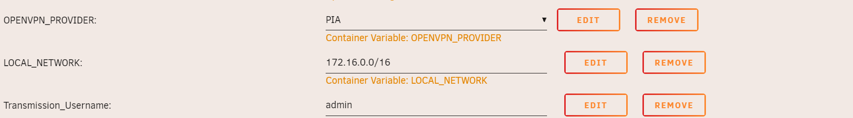

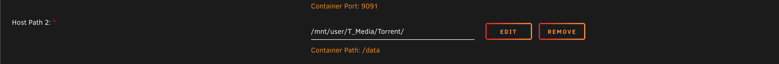

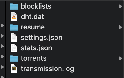

I am new to Unraid and trying to figure out this plugin I keep getting this error no mater witch option for guidance I pick
403: Forbidden
Unauthorized IP Address.
Either disable the IP address whitelist or add your address to it.
If you're editing settings.json, see the 'rpc-whitelist' and 'rpc-whitelist-enabled' entries.
If you're still using ACLs, use a whitelist instead. See the transmission-daemon manpage for details.
403: Forbidden

Lol that one is easy though.
Add your IP space in here
My house uses 172.16.1.0/24 however, my unraid dockers use 172.17, 172.18 and like that so. I added 172.16.0.0/16 for the bigger scope.
If you are using 10.0.0.0/24 then do the same as me

38 minutes ago, bradywang said:
The only files i see in the /mnt/user/appdata/Transmission_VPN are 2 files that contain only 2 lines witch are username and password
and i have set the local_network to 10.1.1.0/24 any other setting and it wont start
Let me help you a little bit. Currently there's a bug with the transmission ratio. You have to modify that manually in the settings.json file or don't it's okay as long as you don't use it in the template. And you don't see the data because is somewhere else not in config.
I'm attaching picture from a previous post that might help you go the right path, and my custom variables are optional.
the settings.json file is in whatever location you set for image.thumb.png.5d8895f68b60880ac789310714aa359c.png:
in my case its located at /mnt/user/T_Media/Torrent/transmission-home, and should look similar to this:image.png.cdcbe944838442859d7cff9e65e89033.png
