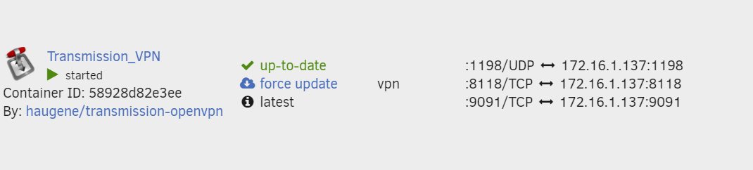

I seem to be having an issue with the transmission docker when it does not show any of the other ports. I starts fine with PIA but things like Proxy 8118 do not show up and I cannot connect to it with Sonarr or Radarr. Any help please? Thanks
Can you post your run command (remove passwords/usernames etc)
root@localhost:# /usr/local/emhttp/plugins/dynamix.docker.manager/scripts/docker run -d --name='transmission' --net='proxynetwork' --privileged=true -e TZ="Europe/London" -e HOST_OS="Unraid" -e 'OPENVPN_USERNAME'='*******' -e 'OPENVPN_PASSWORD'='*******' -e 'OPENVPN_CONFIG'='netherlands' -e 'OPENVPN_PROVIDER'='PIA' -e 'LOCAL_NETWORK'='10.0.0.0/24' -e 'TRANSMISSION_RPC_USERNAME'='******' -e 'TRANSMISSION_RPC_PASSWORD'='*******' -e 'OPENVPN_OPTS'='--inactive 3600 --ping 10 --ping-exit 60 --mute-replay-warnings' -e 'PUID'='99' -e 'PGID'='100' -e 'TRANSMISSION_DOWNLOAD_DIR'='/downloads' -e 'TRANSMISSION_RPC_AUTHENTICATION_REQUIRED'='true' -e 'TRANSMISSION_RATIO_LIMIT_ENABLED'='true' -e 'TRANSMISSION_DOWNLOAD_QUEUE_SIZE'='15' -e 'TRANSMISSION_CACHE_SIZE_MB'='10' -e 'TRANSMISSION_INCOMPLETE_DIR'='/downloads/incomplete' -e 'TRANSMISSION_WEB_UI'='transmission-web-control' -e 'GLOBAL_APPLY_PERMISSIONS'='false' -e 'WEBPROXY_ENABLED'='true' -e 'PIA_OPENVPN_CONFIG_BUNDLE'='openvpn-tcp' -p '9091:9091/tcp' -v '/mnt/user/appdata/transmission_VPN':'/data':'rw' -v '/mnt/user/Media/torrents/':'/downloads':'rw' -v '/mnt/user/Media/torrents/Watched/':'/watch':'rw' -v '/mnt/user/Media/torrents/':'/mnt/user/T_Media/Torrent/':'rw' --cap-add=NET_ADMIN --restart=always --log-opt max-size=50m --log-driver json-file --dns 8.8.8.8 --dns 1.1.1.1 'haugene/transmission-openvpn:dev'
Edited by AlexGreenUK
You have only specified one port:
-p '9091:9091/tcp'

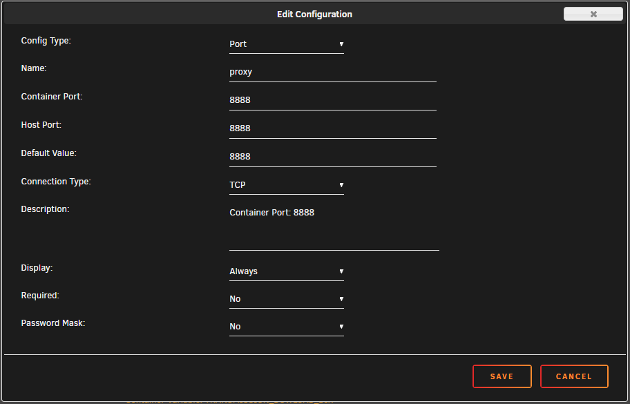

If you enable tiny proxy, you also have to add the port mapping:
Sonarr and radarr should connect to 9091 if you have set them properly
Edited by clowrym
added image

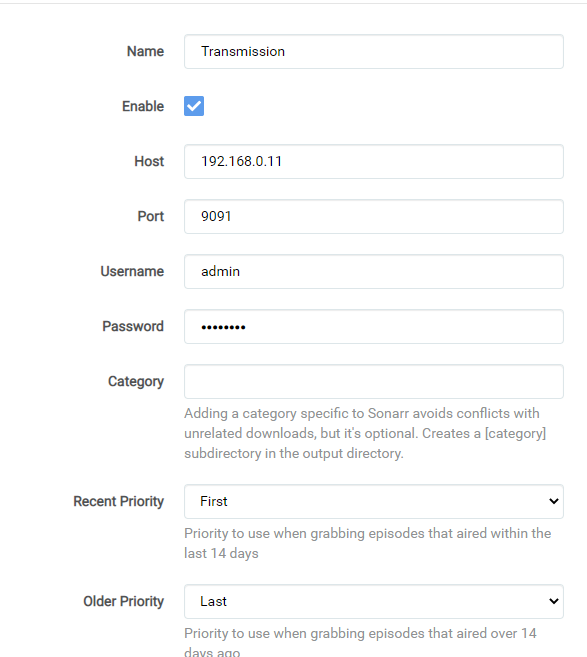

I have added the port for the Proxy. Still have issues with Radarr and Sonarr though. I have tried IP and my reverseproxy.
[v3.0.1.4259] NzbDrone.Core.Download.Clients.DownloadClientUnavailableException: Unable to connect to Transmission, please check your settings
 ---> System.Net.WebException: Connection refused Connection refused: 'http://10.0.0.2:9091/transmission/rpc'

2020-12-16 01:39:08.1|Warn|RadarrErrorPipeline|Invalid request Validation failed:
 -- Host: Unable to connect to Transmission

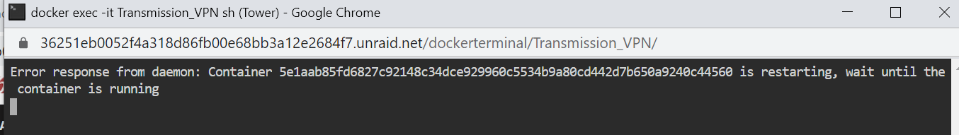

Hi there - Firstly, thank you for the great docker - It is very much appreciated :)
I am having an issue with Transmission VPN that seems to have started recently (I don't remember exactly when), but the TRANSMISSION_SPEED_LIMIT_UP_ENABLED option within the docker config is no longer doing anything for me.
Each time I restart the docker I have to go into it, launch settings and tick the option to enable the speed limit.
Is there a way I can force this option to be set each time the docker starts?  Thanks :)
can you drop your settings.json file?
Also do you have any issues connecting to the transmission gui?
can you also post the log for transmission
are there any proxy settings in Radarr that you have set?

Hi there
My run command:
root@localhost:# /usr/local/emhttp/plugins/dynamix.docker.manager/scripts/docker run -d --name='Transmission_VPN' --net='bridge' --privileged=true -e TZ="Europe/Berlin" -e HOST_OS="Unraid" -e 'OPENVPN_USERNAME'='XXX' -e 'OPENVPN_PASSWORD'='XXX' -e 'OPENVPN_CONFIG'='default' -e 'OPENVPN_PROVIDER'='PIA' -e 'LOCAL_NETWORK'='192.168.0.0/24' -e 'TRANSMISSION_RPC_USERNAME'='admin' -e 'TRANSMISSION_RPC_PASSWORD'='XXX' -e 'OPENVPN_OPTS'='--inactive 3600 --ping 10 --ping-exit 60' -e 'PUID'='99' -e 'PGID'='100' -e 'TRANSMISSION_DOWNLOAD_DIR'='/downloads/Transmission' -e 'TRANSMISSION_RPC_AUTHENTICATION_REQUIRED'='true' -e 'TRANSMISSION_RATIO_LIMIT'='2' -e 'TRANSMISSION_RATIO_LIMIT_ENABLED'='true' -e 'TRANSMISSION_PEER_LIMIT_GLOBAL'='200' -e 'TRANSMISSION_PEER_LIMIT_PER_TORRENT'='50' -e 'TRANSMISSION_SPEED_LIMIT_UP_ENABLED'='1' -e 'TRANSMISSION_SPEED_LIMIT_UP'='1024' -e 'TRANSMISSION_PEER_PORT_RANDOM_LOW'='51413' -e 'TRANSMISSION_PEER_PORT_RANDOM_HIGH'='51613' -e 'TRANSMISSION_DOWNLOAD_QUEUE_SIZE'='20' -e 'TRANSMISSION_CACHE_SIZE_MB'='10' -e 'TRANSMISSION_INCOMPLETE_DIR'='/downloads/incomplete' -e 'TRANSMISSION_WEB_UI'='transmission-web-control' -e 'GLOBAL_APPLY_PERMISSIONS'='false' -e 'WEBPROXY_ENABLED'='false' -e 'PIA_OPENVPN_CONFIG_BUNDLE'='openvpn-tcp' -p '9091:9091/tcp' -p '1198:1198/udp' -v '/mnt/user/Downloads/':'/data':'rw' -v '/mnt/user/Downloads/':'/downloads':'rw' -v '/mnt/user/Downloads/watch/':'/watch':'rw' -v '/mnt/user/T_Media/Torrent/':'/mnt/user/T_Media/Torrent/':'rw' -v '/mnt/user/appdata/Transmission_VPN':'/config':'rw' --restart=always --log-opt max-size=50m --log-opt max-file=1 'haugene/transmission-openvpn'
Log immediately after restart:
Starting container with revision: a4d65774f855a04070766e53346661f48c76fa0e

6 minutes ago, PureLoneWolf said:
Overriding speed-limit-up-enabled because TRANSMISSION_SPEED_LIMIT_UP_ENABLED is set to 1
I believe this should be 'true', not '1' ?
Welp...that was easy :/  Thank you.  I have never changed it since install...so not sure why it worked for so long - but thanks :D
Anytime!! Almost every problem it seems is related to some kind of variable / port / path mapping issue!! why it changed.....I can't answer that one!!
Cheers!!

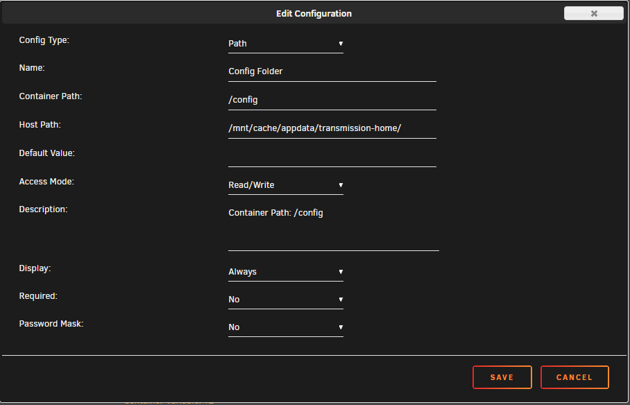

Using existing settings.json for Transmission /data/transmission-home/settings.json
Somethings else, doesn't look like this folder mapping is doing anything? this container has always used /data/transmission-home as its base directory, I have tried to separate the config files from this folder on my array, to my cache drive where all my other docker files are stored, but I have been unsuccessful so far! check and see if anything is in that folder before removing it just incase.....Git posting on the issue - you may have to set another variable for this to me used
-p '1198:1198/udp'
you can also remove the 1198 port. The new PIA configs don't use it anymore.
ed Dec 16 06:42:34 2020 [southampton409] Peer Connection Initiated with [AF_INET]IP:502
Edited by clowrym
Thanks for the tips - The transmission-home folder definitely contains the settings and some other stuff, so the /config mount is definitely not being used.  I'll get rid of the port :)

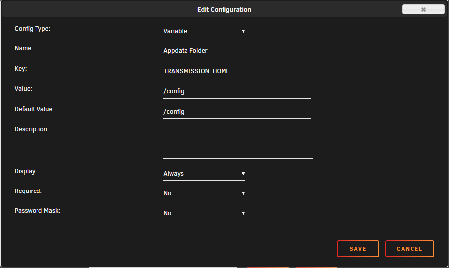

For those that would like to keep the home folder in the appdata folder, the following will need to be added:
