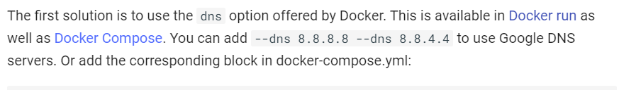

Hi all, I am receiving the error:
WARNING: initial DNS resolution test failed
curl: (6) Could not resolve host: www.privateinternetaccess.com
per others suggestions here and from on this thread I have tried:
  • -dhcp-option DNS 8.8.8.8 to OpenVPN_OPTIONS
  • --dns 8.8.8.8 --dns 8.8.4.4 to the container's Extra Parameters
  • mapping /etc/resolv.conf and populating the file with either:
    • OVERRIDE_DNS_1=8.8.8.8
      OVERRIDE_DNS_2=8.8.4.4
    • nameserver 8.8.8.8
      nameserver 8.8.4.4
None seem to correct the issue.  Any other troubleshooting steps I can take?

2 hours ago, DeadDjembe said:
DNS 8.8.8.8
I believe this should be --dns 8.8.8.8 ..... If that doesn't help, try moving off the :dev branch
Edited by clowrym
Changed DNS to dns
changing the dns to lowercase did not seem to help, but moving off the :dev branch did the trick.  I'm up and running again!  thanks for your help!

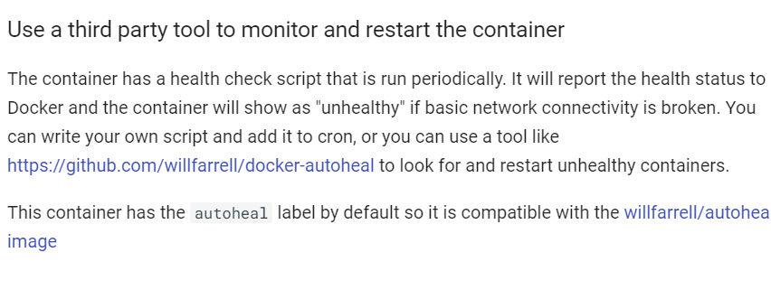

What does uptime 5 days unhealthy mean?
On 4/2/2021 at 10:29 AM, clowrym said:
did you also add the "--" to --dns ? is was missing in your run command....at least compared to mine.
currently it does not include the "--".  It's working so I'm not going to change it now, but will keep in mind if something breaks again.  My config currently states:
OpenVPN_OPTIONS:
--dhcp-option dns 8.8.8.8 --inactive 3600 --ping 10 --ping-exit 60 --mute-replay-warnings
OpenVPN_OPTIONS:
i believe you require --dns ....but i could be wrong i guess!!

added Frequently asked questions screenshot

Is anyone experiencing the downloads stopping after some time (couple hours to couple days)? The container seems to work fine after restarted and then I'll notice the next few days when a new tv release gets added to transmission and they stay at 0% until I restart and they download just fine... I wonder if this is an issue with the vpn?
I use Netherlands PIA currently...
Seems there is something causing a connection issue 🤔
I have this issue now and again with PIA, I run the following script every ~15 minutes to look for the error and restart the containeer
#!/bin/bash
#Check for error in Transmission log and restarts docker if found
#change /Search_String/ to suit the required error
echo checking for Transmission_vpn Fatal Error
docker logs --tail 50 Transmission_VPN 2>&1 | awk '/fatal_error/ {print | "docker restart Transmission_VPN"}'
