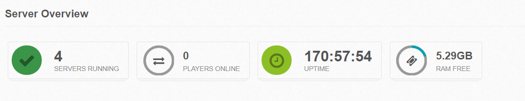

Any idea why my uptime shows like this?
Also, how can I enable terminal? I don't see it under Logging @clowrym
I dont know the issue with the uptime, as I didnt create the app, just the Docker template, To be honest a few commits ago I had the same issue, but I though Hexparrot had fixed it...... I'm not sure what you mean by enable terminal? you can access the docker with

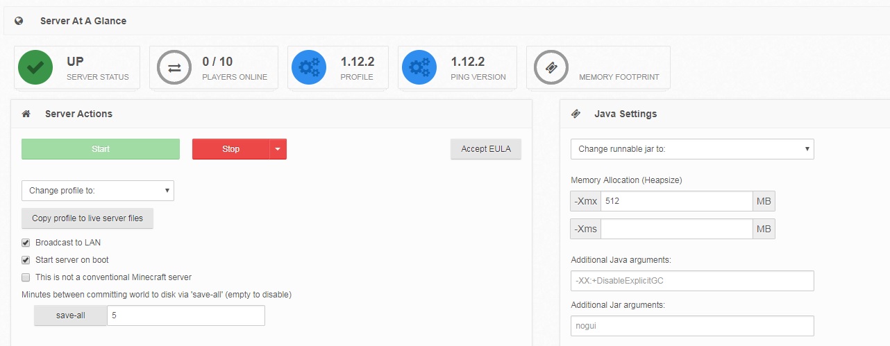

Does anyone happen to have an idea on why the memory footprint of my single server in the MineOS GUI is blank? Also it seems it does not adopt the -Xmx setting. The available free memory always corresponds to Unraid's memory. It used to be the same as the -Xmx setting. I suspect it changed with an Unraid update a while back.
Thanks!

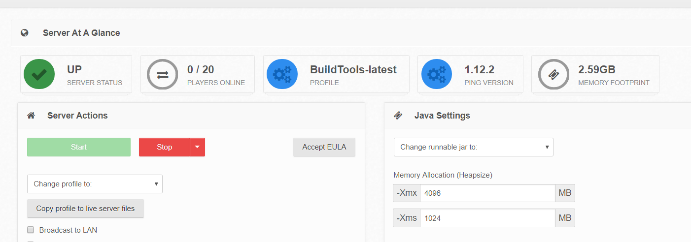

Are you taling about the Server overview? I belvive it will always show unraid's memory value unless you specify the max amount of mem docker is allowed
When you look at an indivdiul server it should be different:

Thanks for your response, I mean the "memory footprint" shown in the server overview. Mine looks like this:
The field is empty no matter what I do. Depending on the xmx settings the total available memory shown in the server view seems to change, but knowing the actual footprint would be helpful. As I said, it used to work. I googled around, after all it might be a Mineos issue, but I wasn't able to find something useful.
Can you add a value to Xms and see if it makes a difference?
Unfortunately, it makes no difference. :/

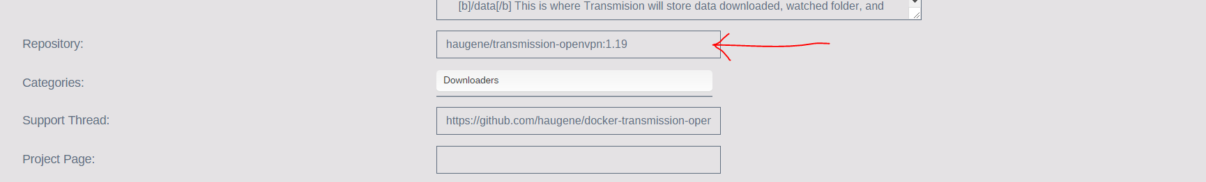

How exactly do I revert to that version in Unraid?
Change the tag:
25 minutes ago, clowrym said:
Change the tag:
Thanks!
