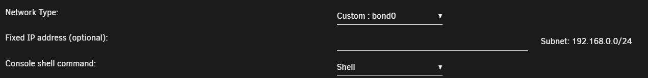

22 hours ago, Arbadacarba said:
I'm trying to figure out how to get ALL transmission traffic to go through one of my internet connections rather than another.
One way I do that using Policy Based Routing is that I differentiate by IP address... So that some of my VM's can only communicate through the slower but cheaper (unlimited) ISP.
Is it possible to make Transmission use a different IP address than the rest of the Unraid Server?
Or, Barring that is there a single outgoing port that is used? or even a range of ports?
This is counter to the VPN goal isn't it?
Slightly confused I know, but any insight would be appreciated.
Arbadacarba
you can give each docker its own IP address if you want, I'm not sure on trying to route your traffic through one connection....i've never tried, or had the need to do it.....
Switch your network to custom and specify an ip in the template:
Edited by clowrym

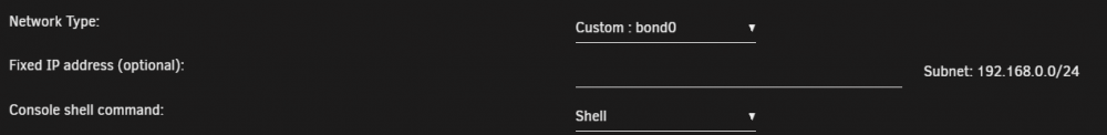

Does it make sense that I would need to clear the LOCAL_NETWORK: variable? I tried assigning the IP address and could not get into the WebUI.
Thanks
Thanks

Zeroing out the LOCAL_NETWORK variable has it working correctly I think... I was just unsure if that made sense or if there could be other problems caused by that change.
I would confirm that your Docker is connecting through the VPN . the point of the local_network variable is to allow your local network access to the VPN subnet.... Personally i use Check my VPN IP ....
Seems to be good... The site shows me connecting through the vpn location.
Seems to be working.
The Goal is that while I want to lock the Torrent Server out of the more expensive internet connection, I want the unraid server itself to be able to get updates through whatever internet connection is working.
Thanks for all the help.
