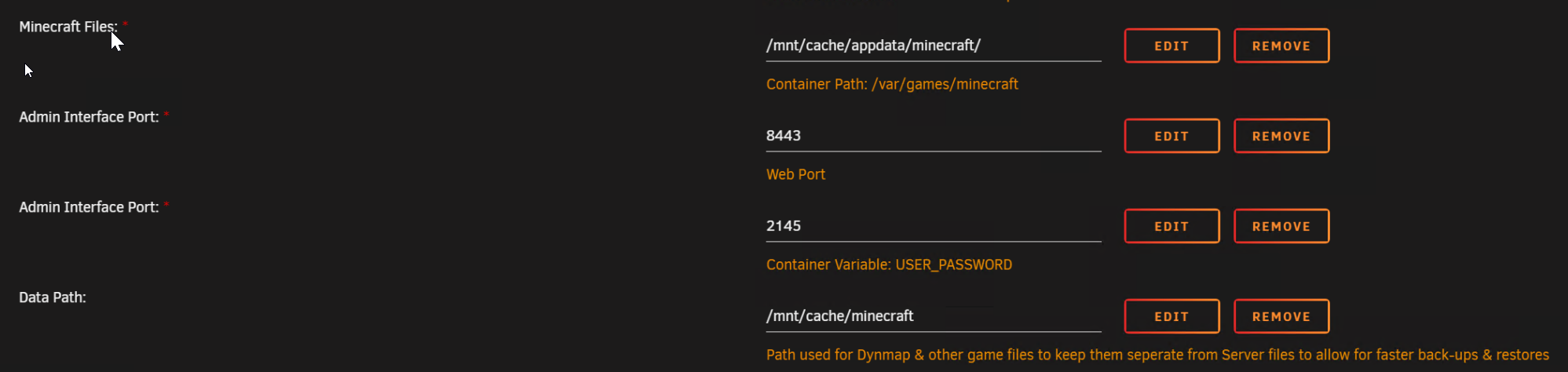

The webui of MineOS uses the port "8443" and I've opened that port on my router to my UNRAID server IP, but I am unable to enter the webui from my main PC. I know this is not much to go on for you in terms of helping me, but maybe some one have any tips on what I could try to get it to work?
I would need to see your docker run command / settings
Here you go :)image.thumb.png.0621fa85bf7397c449d849e6e03ad63b.png
On 1/19/2022 at 12:25 AM, amne said:
Nothing stands out there, How about the container log?
