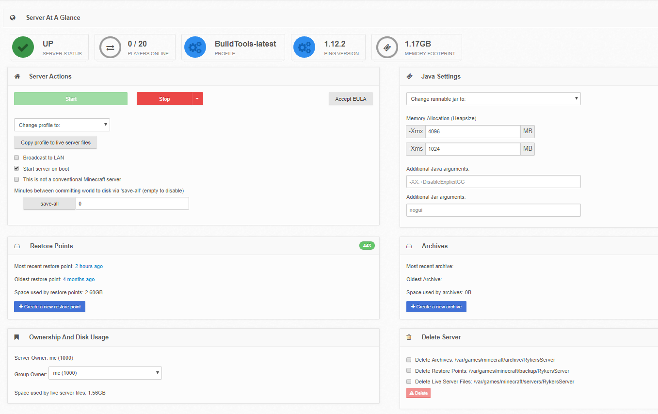

Also review your settings, I've screen-shotted mine for reference:
Lastly, I would remove the ' from the name... Not sure if there are any issues with Special characters or not, but i try and stay away from them!!
level-name=Shin's Place
I must have grabbed the sent the configs  while in-between different tests. I don't normally have that option checked, I was just trying random stuff.
I removed the level name completely
Same thing.
attached screenshot
also attached configs, and logs with the log directory zipped up (all that were accessible anyhow)
