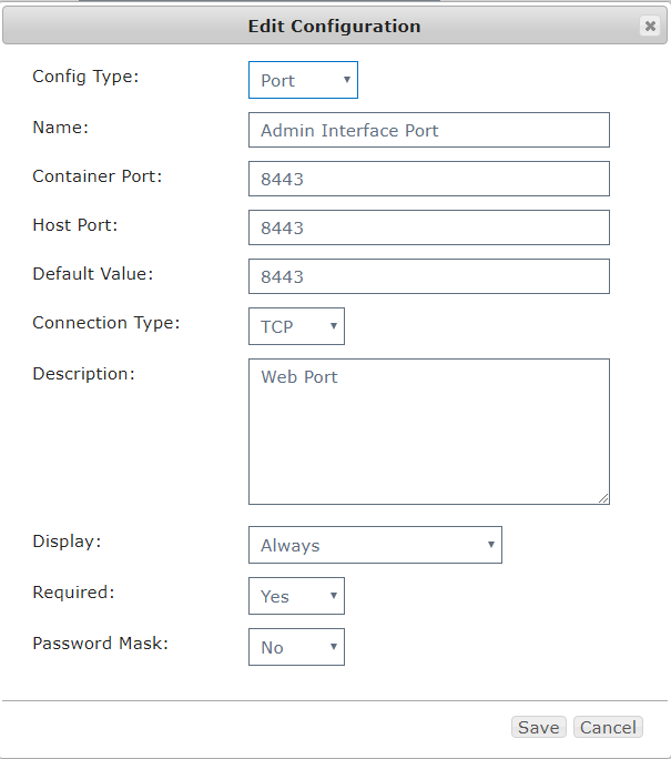

im trying to run mineos-node and an apache webserver docker at the same time but your docker doesent listen to the port to I had to remove apache to be able to get in
as you can see I set mineos to use port 6443
but its not instead its using port 8443
why is it still using the default port even though I have changed it?
this is very frustrating
my apache and mineos were stomping on eachother because both are configured to use 8443 by default and neither are listening to the changes I make
EDIT: if I change the network to bridge mode instead of host mode and have 8443 internal to 6443 external it works

can you show me this:
Exactly. In host mode, the whole range of ports are exposed, no NAT'ing involved, so whatever the application itself opens and listens on is used. In bridge, the host port is opened and redirected to the specified container port.
The GUI currently doesn't handle that not so subtle difference well, ideally I think when host mode is selected all port assignments should be hidden, because they aren't going to be used in any way.
thanks for the clarification

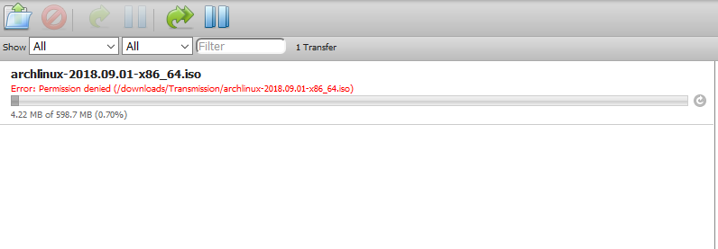

I am getting permission denied errors on all my downloads error.PNG.e7f5df1c8de54a3c7823bd155fddf109.PNG
The User/Group-IDs are still the default ones from your template and should work with unraid. /downloads/Transmission belongs to nobody:users and has 777 permissions.
Any clue?
Any clue?
ca you show me your folder mappings? Anytime ive had this in th epast its beena  folder mapping issue during template creation!

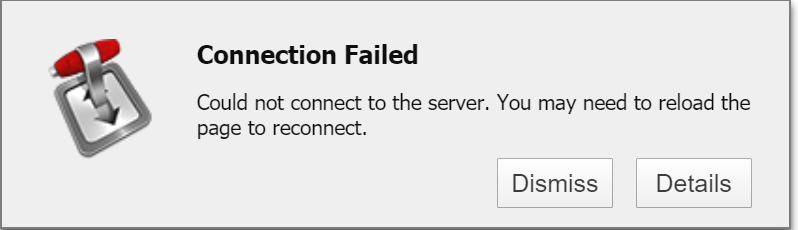

The WebUI refuses to connect in the current version or it gives a Connection failed error:
There seem to be two problems:
1. PIA needs to be connected to a port forwarding host as mentioned here: https://www.privateinternetaccess.com/helpdesk/kb/articles/how-do-i-enable-port-forwarding-on-my-vpn. This fixes this error:
Wait for tunnel to be fully initialized and PIA is ready to give us a port
Wed Oct 17 12:01:42 2018 Initialization Sequence Completed
Generating new client id for PIA
Port forwarding is already activated on this connection, has expired, or you are not connected to a PIA region that supports port forwarding
curl encountered an error looking up new port: 7
1
Note, that the settings do not allow for the selection of all those endpoints. For example, there is an invalid Germany choice. Instead there should be a "DE Frankfurt" and a "DE Berlin"
2. From what I could find out  there seems to be also a problem with 2.94. Reverting to 2.93 by using "linuxserver/transmission:121" into the repository and applying the change fixed this. But then, this version doesn't use PIA.
Does anybody have an idea how to fix this problem e.g. by reverting to an older version of haugene/transmission-openvpn?
Thanks!
TO be honest, I havent kept up with any new opvn locations that have been added, I added DE Berlin/Frakfurt this morning for you. You can add your own locations if any are missing. I'm not sure on your other issue, I've had no problems keeping with the most current version. Might want to post a support ticket here as I only created the Template for unraid, not the application itself!
I currently run the Dev branch of his repository
I'm currently running:
Transmission: 2.94 (d8e60ee44f), RPC: 15
Web Control: 1.6.0 alpha (20180418)
