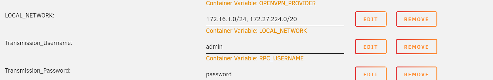

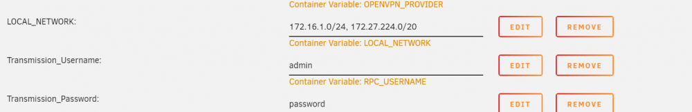

I'm getting some problems with the Transmission VPN. currently I have it with PIA and it works fine. But I cannot get the docker openvpn-as to access the transmission remotely.
I noticed that If I turn off the transmission the vpn connects right away. And if I connect remotely and then start the transmission it works.
I even added this.
Also I remember this wasn't like this before. Because I used PIA before.

There seems to be an issue with adding multiple local networks in the cell you have above, I tried the same originally when I first made this template. I ended up adding a script to user scripts plugin that runs on server boot & that I run if I force a restart/update on Transmission. I have listed it below.... I know its a work around, but I havent figured out how to allow multiple networks in the docker template.....
I use the script below for access loutside of my local network thru the VPN I have set up for my work computer / phone when I am not on ly local network.
adjust the ip addresses to suit your network setup!!

@clowrym Thanks for that. Actually, I was able to make it see my other networks. To me still doesn't make sense because I keep using the server IP plus the port but.
I had to add manually there the virtual network and the vpn network to access the torrent.
Now Something that really bugs my mind and I don't know why is.
Currently I have the OpenVPN-as docker container setup with UDP using port 9443, forwarded through my router. Works perfect. But when I have the Transmission docker running, My OpenVPN doesn't connect using UDP. I currently have it running on TCP.
If Transmission for PIA is using OpenVPN Port 1198, why is it blocking my connection for my own VPN.

DId you add your local network properly? ie. 192.168.1.0/24 or whatever local network your using? Also, are you trying to access it from within your network? If not then you have to add whatever network's you want to access it from.
This is exactly the problem you are getting. Remember the containers run in a virtual network, if you cinnect via VPN or whatever network. You have to add it to the options for the container as well.
Sent from my Pixel 2 XL using Tapatalk
That solved it, all appears to be working properly.

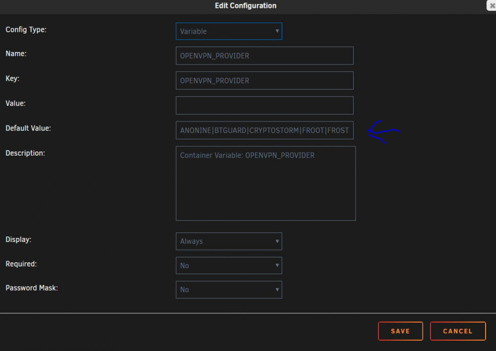

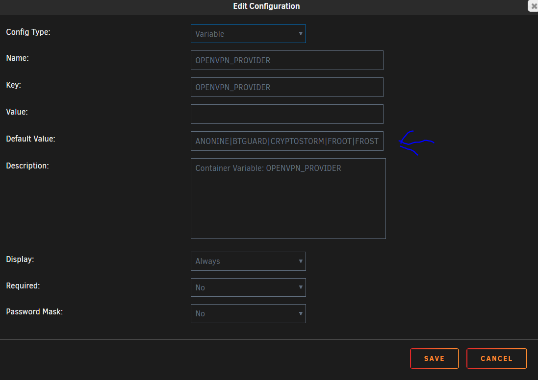

23 hours ago, plantsandbinary said:
@clowrym Hey there's way more providers supported by this container in Github than what is available when installing in Unraid: https://github.com/haugene/docker-transmission-openvpn
For example. MULLVAD is supported but it's not possible to select it in the TransmissionVPN setup window. It's not in the list. Why is this?
When I set up the template I added all that were available at the time, you can add additional ones at any time here:
When I get some time, I will try and add any new ones to the template.
I just updated  the template

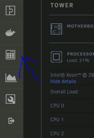

Hi, I feel kindof dumb because I cannot get the Transmission_VPN installed (had no problem with e.g. a krusader docker). How do I add the template? I added the link to https://github.com/clowrym/docker-templates/blob/master/Transmission_VPN.xml into the docker template repositories but then I cannot use it when adding a docker. It is not shown in the dropdown "Select a template".
Nevermind... I didn't see that I could update the CA-plugin... now I feel even more dumb 😃
Edited by cen
forgot to update
easiest way to to add it through community apps....
