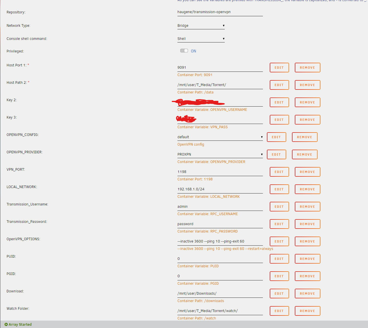

Here is my config:
2 hours ago, OneFiveRhema said:
Here is my config:
Is your PUID & PGID set to 0 for a reason? I dont know if it will make a difference, but usually I keep my dockers at PUID=99 AND PGID=100.... thats the only thing that looks a little off to me
That's discouraging, I was hoping I was missing something obvious. I set them to that because I was logged in as root and I checked the ID and it was 0 for both. It was a desperate attempt to get it working.

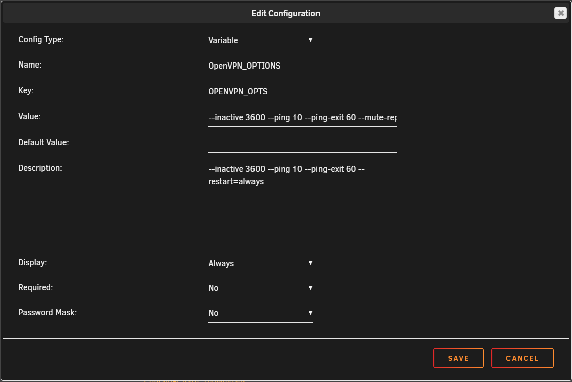

I'm having this problem with the transmission docker container.
Is this a problem? because I want to get rid of this annoying message. I'm using PIA
ErrorWarningSystemArrayLogin
Sun May 5 05:13:18 2019 Authenticate/Decrypt packet error: bad packet ID (may be a replay): [ #2687837 ] -- see the man page entry for --no-replay and --replay-window for more info or silence this warning with --mute-replay-warnings
Sun May 5 05:13:18 2019 Authenticate/Decrypt packet error: bad packet ID (may be a replay): [ #2687838 ] -- see the man page entry for --no-replay and --replay-window for more info or silence this warning with --mute-replay-warnings
Do you have this added :
I have first part only, not the other part saying --mute
Sent from my Pixel 2 XL using Tapatalk
Not all shown should read:
--inactive 3600 --ping 10 --ping-exit 60 --mute-replay-warnings
That should do it then :D
