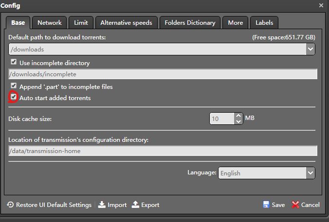

45 minutes ago, itlists said:
Noticed an issue with Transmission when adding magnet links, the torrents are in paused state instead of starting right away.
According to the official transmission docs, the default is to start added torrents. I've even added the variable in my docker config but the torrents are still in paused state when added.
Can you check this setting:
The webUI shows its enabled. Is there somewhere else I should check too?
Is there something else I can try?
Thanks

I'm attaching my settings. I don't have it and I don't have the problem. Try downloading a fresh docker image by using the advanced mode in docker and reinstalling the app69160675c396bccd26625f2c7c72aab5.jpg

Force update was one of the first things I tried. Will do another now just to be sure.
I've tried with and without the 'start when added' variable and neither seems to work.
I uninstalled the transmission docker, deleted the config folder and re-installed it. Added a torrent now and getting the same problem - doesn't start when added.

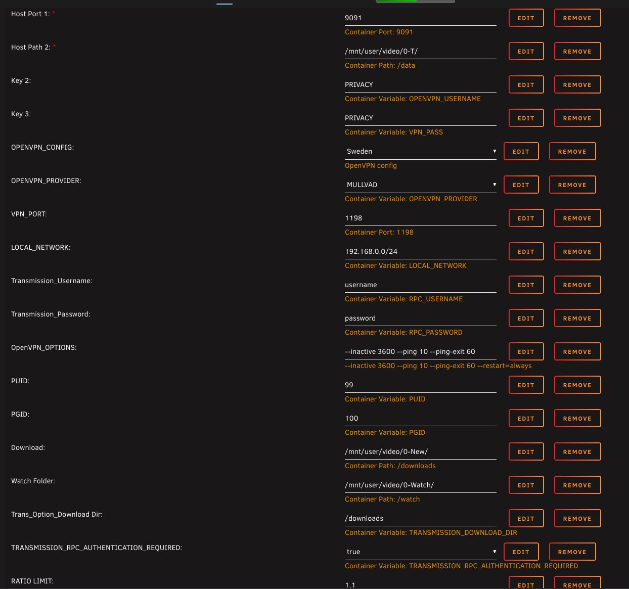

I installed transmission_vpn with following settings (see image)
The installation doesn't seem to be working on UNRAID 6.7.2....WebGUI cannot be launched.
When I install, put in Mullvad username and password, then open up WebGUI...I get blank web page with
Unable to connect
Firefox can’t establish a connection to the server at 192.168.1.123:9091.
My server is located on 192.168.1.123, and local ports are open for all devices on 192.168.0.0/24
Why am I getting this error? Why can I not launch WebGUI?
Also,
In edit settings, what is:
1. Container Path: / data. -  is this for incomplete downloads?
2. RPC_USERNAME and PASSWORD: why is this required? Noone uses the server but me. How can I disable this it?
3. What is difference between "Container Path: /downloads" and "Container Variable: RANSMISSION_DOWNLOAD_DIR"? Where is torrent data downloaded?
4. Where are INCOMPLETE files downloaded?
5. Is this app maintained?
When I installed the app, I went to appdata/TRansmission_VPN folder. And config file is missing. openvpn-credentials.txt are also missing. Why? Does that  folder need to be modified?
Thanks.
Edited by emod
change your local network to 192.168.1.0/24

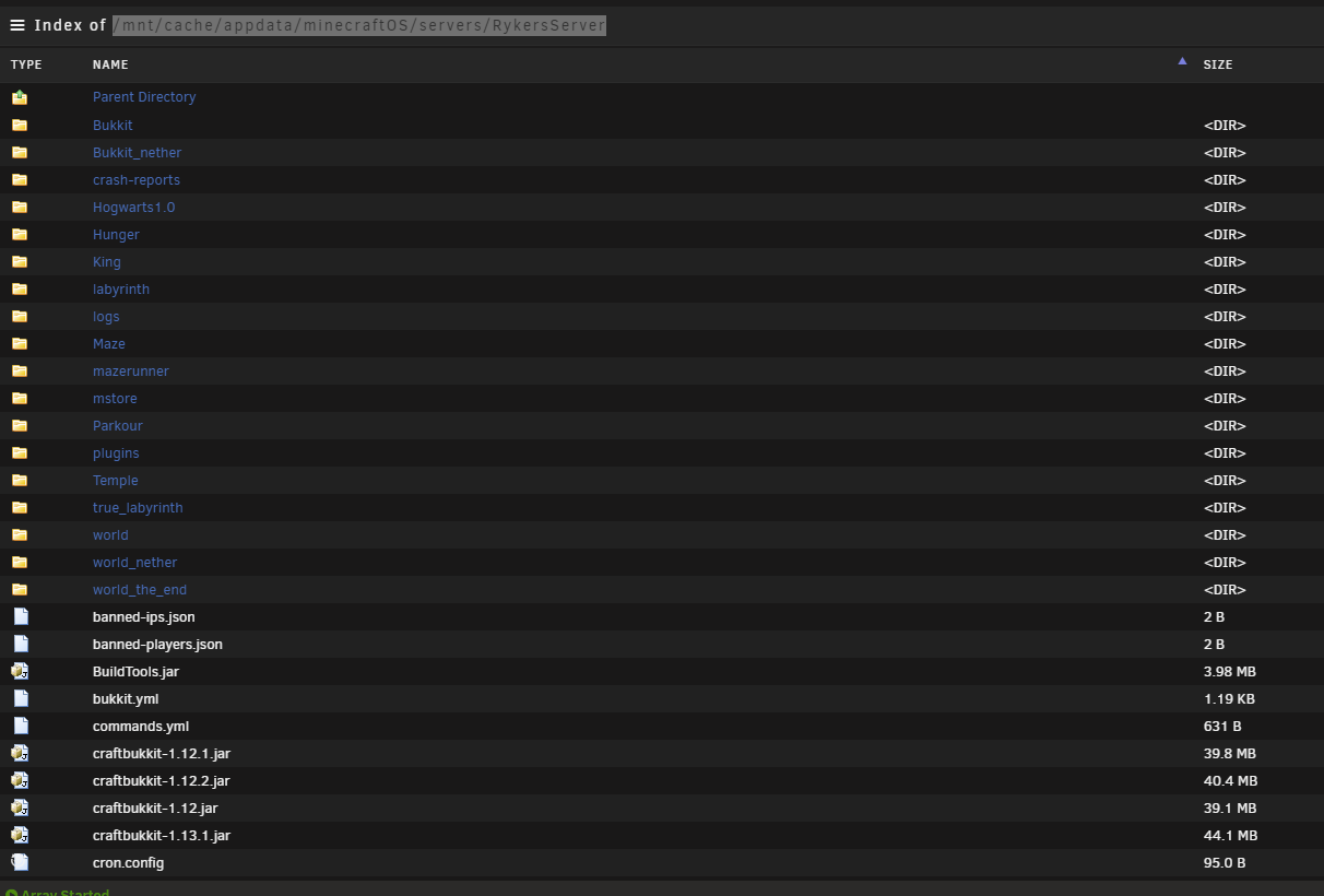

Basically you just have to place the world files inside of your servers Folder, for instance, My sons sever & Downloaded worlds are placed in
/mnt/cache/appdata/minecraftOS/servers/RykersServer/
where ~/mazerunner was a Maze runner map we downloaded that was based on the maze runner movie. There is also a folder for Hogwarts, temple, labyrinth, etc. one for each world you want to have on your server. If you have multiple worlds, you may also need a plugin so they can travel between them easily, ie. creative gates.

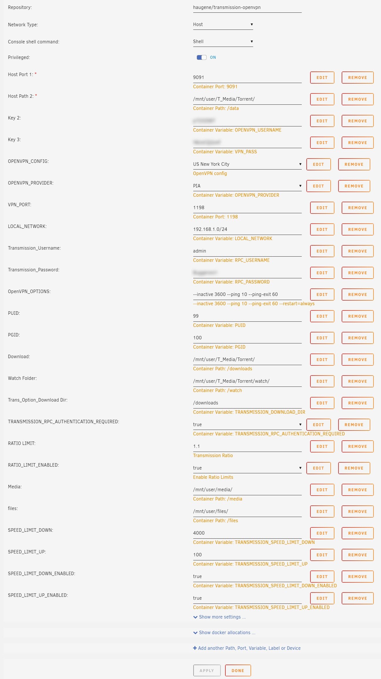

Regarding haugene/transmission-openvpn...
I've been using this container for years on its own IP address with no issues.  I've decided I want to run it using the host's IP.  The container works, however the entire Unraid host and any other docker containers that also run using the host's IP are now having all their internet traffic routed through the account I've got the Transmission_OpenVPN container connecting to.  There's got to be some way to make it so the VPN connection is isolated to just this container, right?
Thanks in advance.
Thanks in advance.
Thats an odd issue, I have always had mine set to the Host IP & only Transmission traffic is routed through my VPN. can you post your settings for the container?

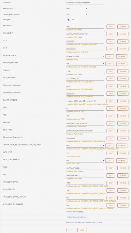

Sure thing.  See attachment.  Thanks!
Switch netowrk type to bridge.

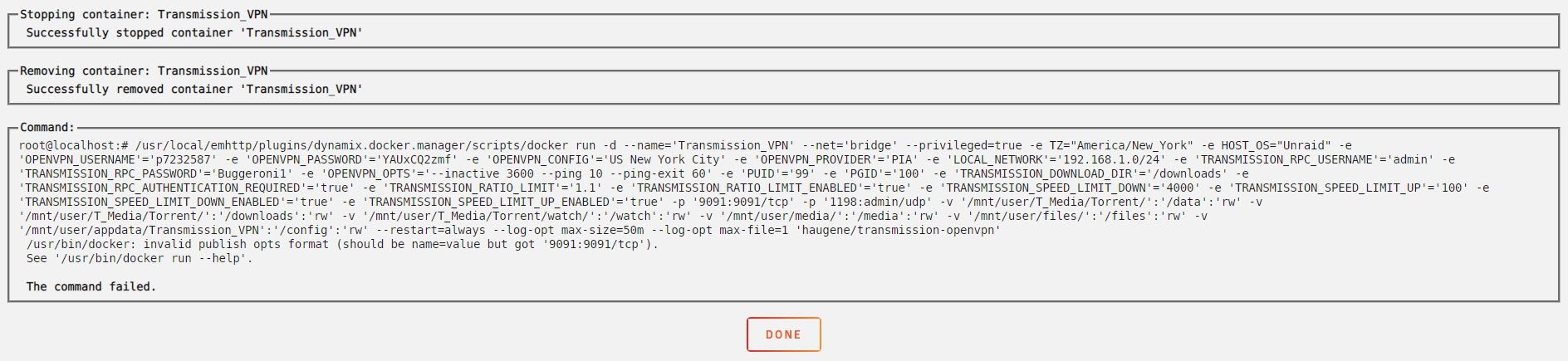

When I switch to bride, I get this.  And then the docker container becomes an orphaned image.
Edited by PaulieORF

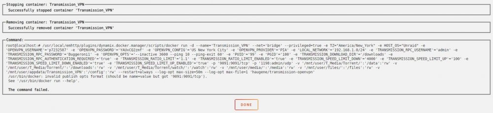

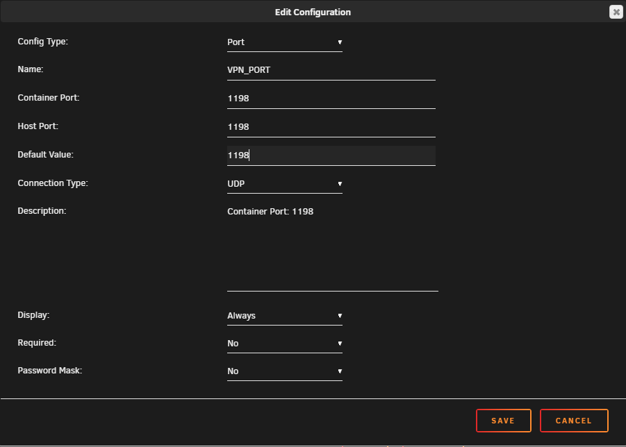

Can you click edit on your port entries and show me whats inside, there is something wrong. Mine looks like this:
-p '9091:9091/tcp' -p '1198:1198/udp'
Where your's look like this:

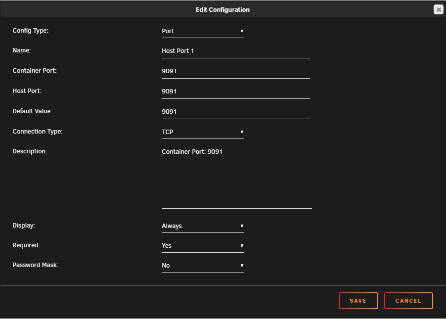

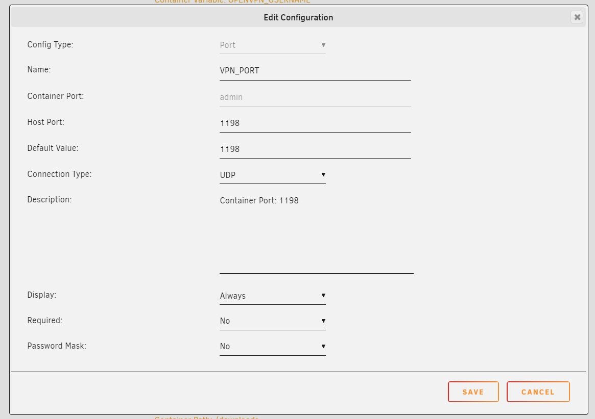

Sure thing.  Here ya go.
can you switch to advanced view and send again....
Should  look similar to this:
Looking at your run command there is somthing wrong with your second one as your getting '1198:admin/udp' rather then '1198:1198/udp'
Oh okay.  I had to enable advanced view to see all the fields.  For the VPN_PORT value, it was listed as "admin" for the container port but it was grayed out, so I was unable to edit it.  So what I did was delete this port and create a new one for it.  Set the container port to 1198, set it to bridged, and now it's rocking and rolling as it should.  Thanks for your help!
