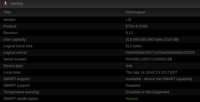

Hard drive marked with red X under Dashboard tab. Is there a log to show why it's bad?
This is the only info i can find on the drive. There use to be a section in unRAID that would show me if the drive was prefailure, old, etc.

The last line of the SMART report offered the answer..."Device does not support Self Test logging".  Good thing you mentioned the SMART report, because i missed this line the first time.
smartctl 6.5 2016-05-07 r4318 [x86_64-linux-4.9.30-unRAID] (local build)
Copyright (C) 2002-16, Bruce Allen, Christian Franke, www.smartmontools.org
=== START OF INFORMATION SECTION ===
Vendor:               LSI
Product:              9750-4i    DISK
Revision:             5.12
User Capacity:        319,988,695,040 bytes [319 GB]
Logical block size:   512 bytes
Logical Unit id:      0x600050e05571c000dc5b00006cf10000
Serial number:        5VH36CLG5571C000DC5B
Device type:          disk
Local Time is:        Sat Sep 16 11:02:56 2017 EDT
SMART support is:     Available - device has SMART capability.
SMART support is:     Disabled
Temperature Warning:  Disabled or Not Supported
=== START OF READ SMART DATA SECTION ===
SMART Health Status: OK
Current Drive Temperature:     0 C
Drive Trip Temperature:        0 C
Error Counter logging not supported

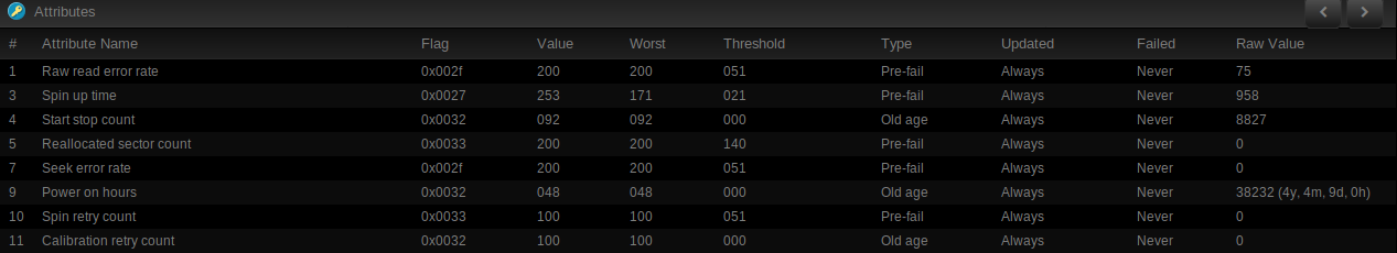

This is the screen i was looking for that is available on my 2nd unRAID server. Which does not use a raid card and plugs directly into the MBD.
The reason i wanted a log file is to confirm that there was an actual error and this is not some bug with my raid card. Like in my post here. When i remove these "bad" drives from the array and test them in other machines, they are working properly. Re-partitioning and formating these drives works too. If i add them back to the array they work again for about a week before reporting the same error.
So these failures could be false positives. On the other hand every drive i replaced continued to work without issue. As you originally suggested, i may need a HBA card to find a definitive answer. Thanks for the help.
