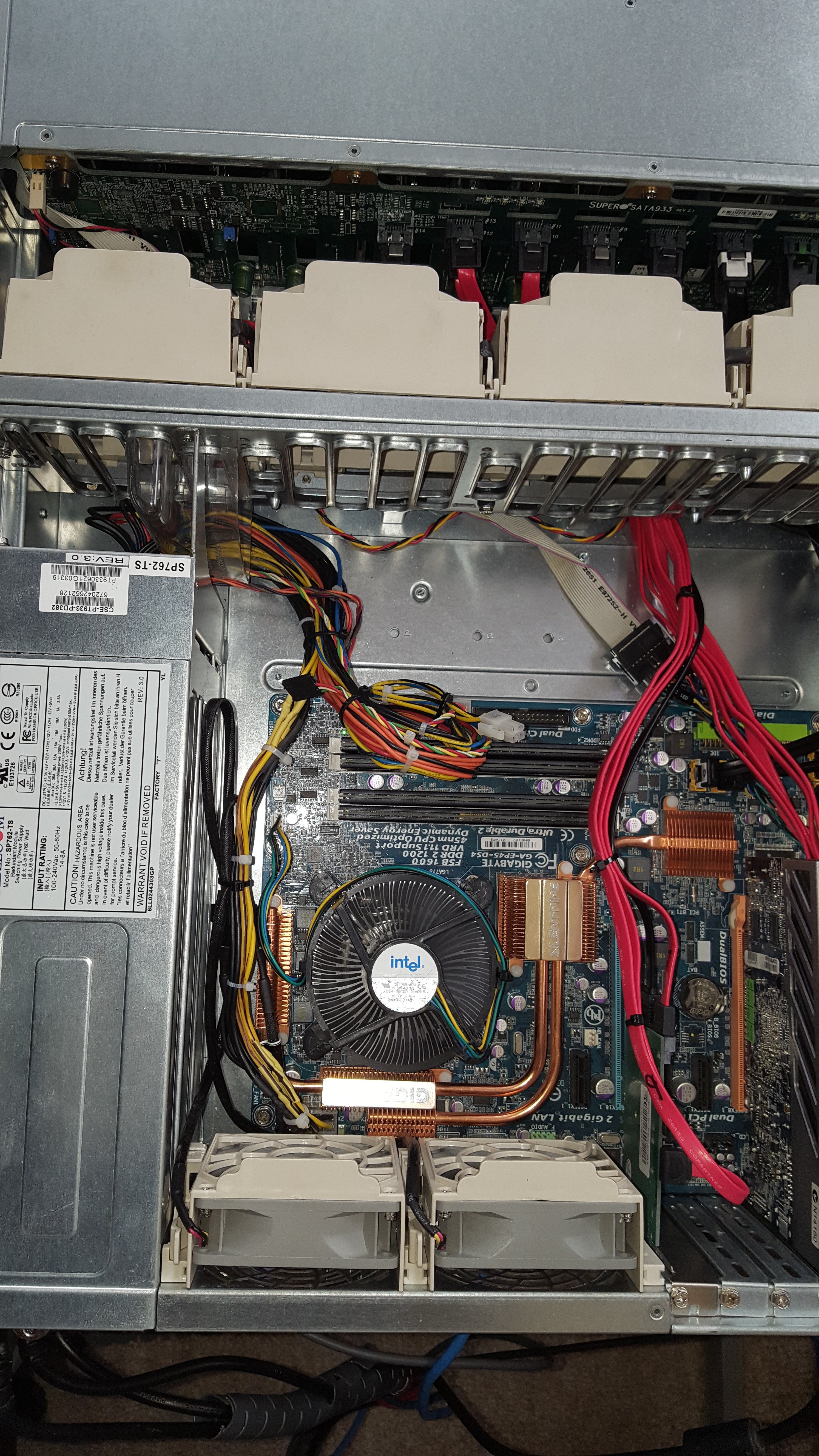

After removing a 4-port Addonics Sata Controller card and adding an IOCrest  8-port card ( SI-PEX40071) , I keep getting this " call traces found on your server" and " irq 16: nobody cared found on your server ". I have changed the USB port my boot drive is attached to, plus tried swapping over the PCIe slots both cards are in as well as swapping around some of the sata cables on the new 8-port card. This is a recent rebuild of my server from a tower into a 15 bay Supermicro SC933 chassis.Everything was working fine until the 8-port card was fitted. Has anyone any idea of how to fix whatever is causing this issue ? FYI..relative newby to this type of thing, any help offered should please keep that in mind. I am running Unraid 6.3.5 on a Gigabyte GA-EP45-DS4 Motherboard.

Added picture
If swapping slots didn't help look for a board bios update, if that doesn't work not much else you can do.
