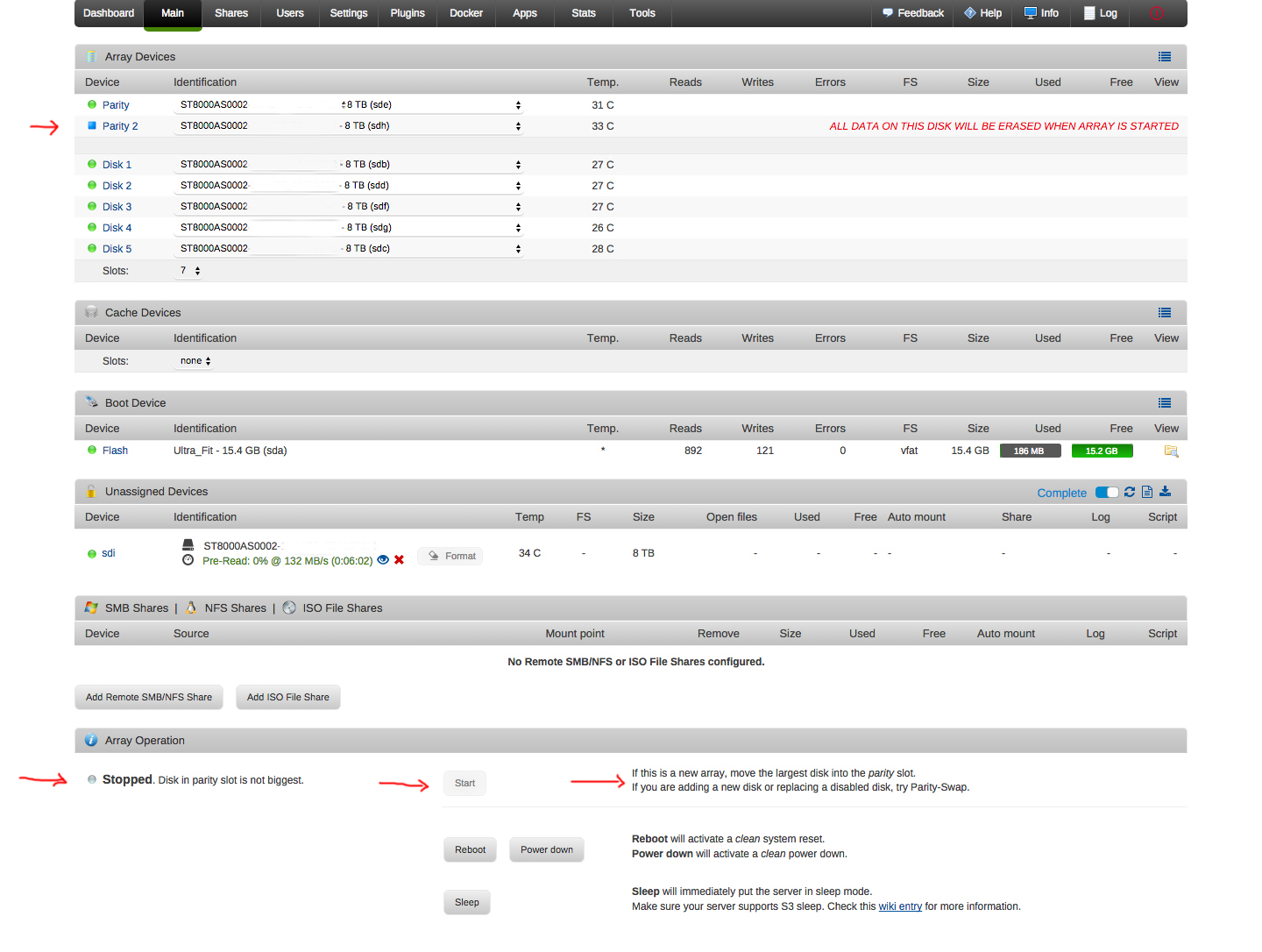

I will like to add a second parity drive to my array.
All drives are Seagate archive 8TB.
1) i have preclear the new seagate 8tb
2) stoped the array
3) assigned to 2nd slot
but i can't start the array. the START button is greyed
i get the message "disk in parity slot in not biggest"
i also have one more new seagate 8tb that i start preclear and haven't finished yet.
any thoughts?
Edited by volume
The new parity disk is smaller, maybe HPA, diagnostics would help.

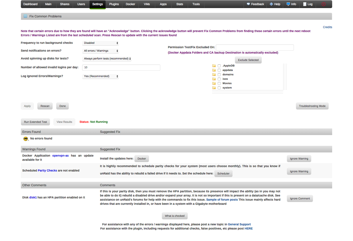

although i see that the disk 1, that has the HPA partition, seems that its a data drive (first screenshot)
how can i remove the HPA from the disk 1? where can i see the diagnostics for the parity disc?

Parity2 disk andi disk1 have HPA enable, for disk1 it's not a big deal, but it can't be enable for any disk used as parity:
Sep 12 00:44:37 Criterion kernel: ata11.00: HPA detected: current 15628044911, native 15628053168
In your case it was most likely done by your gigabyte board and a bios backup feature, you may want to disable that to avoid doing it to any more disks, see here for how to remove HPA:
https://forums.lime-technology.com/topic/10229-hpa-aka-why-are-two-identical-drives-different-sizes/

The hard drive with the HPA is new, and i preclear the disc once...
I have disconnect the HPA drive from unRAID and connect it to my synology nas with a docking station.
Then, format the whole drive with ext4 and connect it back to unRAID.
The Drive is listed in unassigned drives... I run fix common problem and didn't find any HPA
Can i put it to the array?
Also do i need to preclear the disc once more?
When we preclear a new disc and then format it outside of unRAID, e.x. in another pc, do we need to preclear the disc again?
Not sure if it scans unassigned drives, it also didn't warn about it earlier.

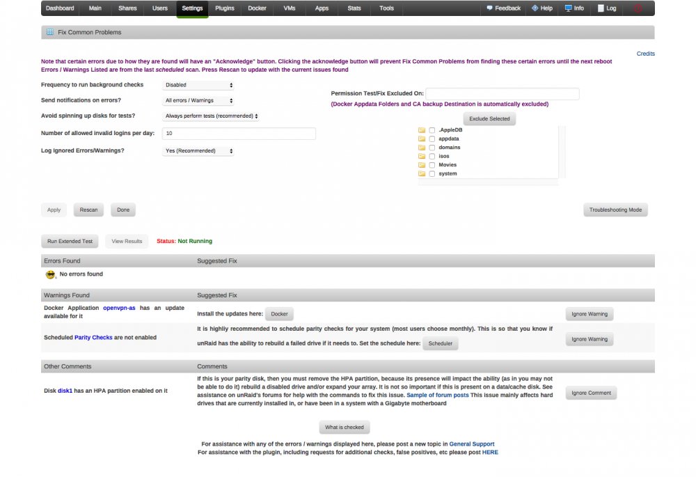

i turned off the back up setting from bios, and i removed the HPA from the empty disk.
But i also have another disk with HPA which is not empty.
Is it safe to remove the HPA without emptying the disk?
Anecdotal evidence shows that gigabyte boards if it finds an HPA on a drive connected to the motherboard ports it will not create another one on a different disk. Leave the HPA on disks except for the parity drives You'll never miss the storage space lost
Sent from my SM-T560NU using Tapatalk
No - it is not safe to remove an HPA from a non-empty disk. Having an HPA does absolutely no harm on a data disk. Just leave it.
