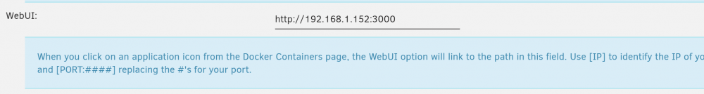

Thanks for your response. I did that, but it only wants to work on 3000 no matter what I do.
In unRaid if you edit the gitea configs and hit the toggle in the upper right for advanced you will get a field like this where you can set the web ui port
