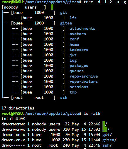

Perms are 755 for me, owner is my first samba user from when I did the transfer back then...
Is the folder structure right?
Edited by Kilrah

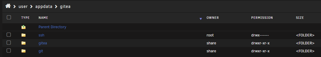

Yup, same here, same username as the first share created. Perms look right, tree looks similar to yours:
Everything in the ssh folder is owned by root:root and has 600 permissions which is what I'd expect for SSH keys
My DB appears to be 644, I'm thinking that's (at least part of) the issue. I had issues with the container giving me the install page and had to copy over the DB alone to get out of that loop.

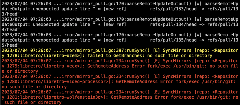

I see this within the Gitea System Notices
May 15, 2023
Failed to health check repository (buee/gps_tracker): fork/exec /usr/bin/git: no such file or directory
So I checked it:
/ # which git
/usr/bin/git
/ # ls -alh /usr/bin/git
-rwxr-xr-x    1 root     root        2.7M Apr 25 17:13 /usr/bin/git
root != buee
The env var for USER is buee but it's still executable for anyone...
Edited by buee
Updated information
Not really, you're missing git/repositories, that's where all repos are supposed to be! (didn't include them in tree because sensitive names)
Ah, I was solely looking at permissions, users, and groups. Didn't even catch that. No idea how that did not get synced over with everything else.
I rsynced it again, checked permissions, had to modify the app.ini file again to reflect the new IP/hostnames, etc. But it appears as though I can see the repos and push to them now. Thanks Kilrah!

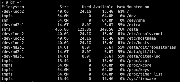

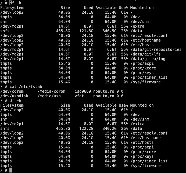

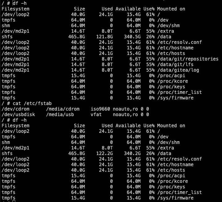

Hi Guys, I am having issues when running gitea, when run it runs perfectly, but after a while it loses the repositories mapping.
In the image you can see that in the first run there is a mapping for repositories and in the second run, this mapping disappeared.
It seems to happen when sync repos begin, but I have not been able to replicate consistently.
Have you found something similar? I have been trying to access more logs to see what can be happening without success.
Note: I have several other docker containers with the same volumes and it only happens with gitea and the repositories volume.
Thanks in advance.
