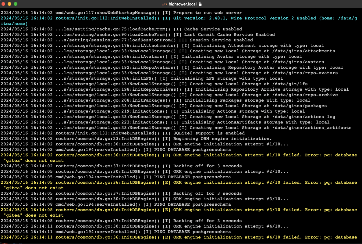

Hi, I'm new to using Gitea.  I installed the app on my Unraid server but the keeps crashing.  It seems to be trying to connect to a Postgres database.  I didn't find any additional steps for setting this up.  Can some one point me in the right direction?
Edit:
I got it worked out:
Looks like the v1.22 update is what did it with a number of changes.
https://old.reddit.com/r/selfhosted/comments/1d2g4bh/gitea_1220_is_released_gitea_blog/
