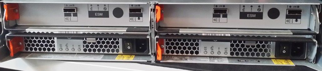

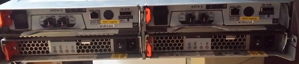

- 2x Fibre Channel SAS controllere (39R6502)
- 2x ESM controller (39R6516)
From the pictures it seems one of them has both ESM-controllers, and one has both SAS-controllers
So my question is simple. Can I use these and hook them up to my LSI-card with a SFF-8088 cable?
Do I need a fiber HBA to use the one with SAS-controllers? (I only need one of them today, but in the future I'll likely get more drives)

As I've got two ESMs and two SAN-controllers, I'm not sure which is best. The ESMs are for redundancy, so I can probably have 1 of each in each of the EXP3000. This means I've already got all I need to hook up 24 drives to my system, awesome!

This also seems to me to be a better performance than I can achieve through the SAN-controllers at 4Gb/s?

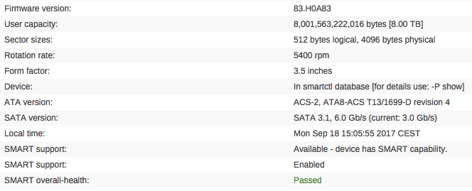

I believe the EXP3000 is SAS1/SATA2? if so it's half those speeds per link, you can see on unRAID at which speed disks are linking at, if it's SATA2 (300MB/s), each x4 mini SAS link will have 1200MB/s (1100MB/s usable).

Unraid says this under Identity for the drives:
59bfc553343dc_ScreenShot2017-09-18at15_08_01.png.c22ce27f1a45d6224b6bdf5a8c7dbb9b.png
What matters is this:
Current: 3.0Gb/s
So it's SATA2.

And just to confirm, this is more than what is available through the SAN-controllers?
Sorry, never worked or got info on SAN controllers, no clue.
