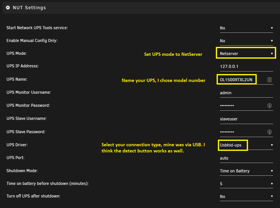

How to setup NUT as a server and client:
Server Mode:
On the Unraid host that has the UPS plugged into it, setup your "Server" as follows:
-Set UPS mode to Netserver
-Name your UPS, and remember the name as you will need it for client setup
-Use "detect" or choose your connection type. Mine was easy since it's USB.
-In the Config Editor and the bottom of the page, edit your upsd.conf file to reflect two LISTEN entries. Localhost and your unraid IP.

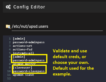

762181466_NutServer-2.PNG.3d310585bd8439b17b37303da19ef30e.PNG I don't think this is needed
-Again in the config editor, you can view the default creds in the upsd.users file. Continue to use these or set your own. You will need these again on the Client setup.

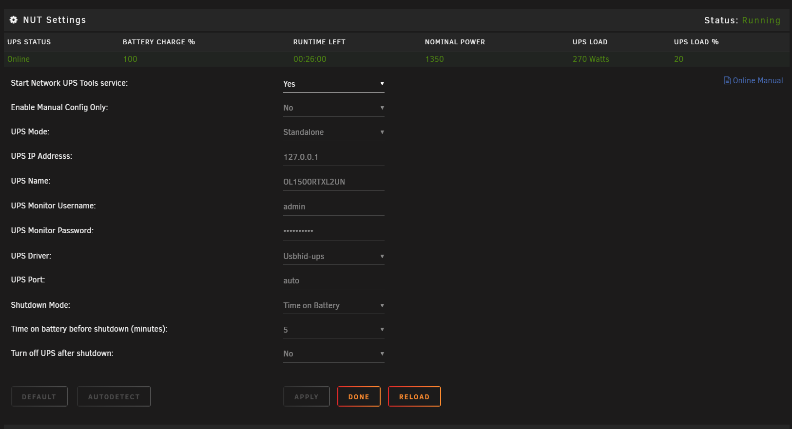

-Once done, set "Start Network UPS Tools service" to "Yes" and your service should start, and UPS info should be detected and appear.
-Header at top of page with UPS summary

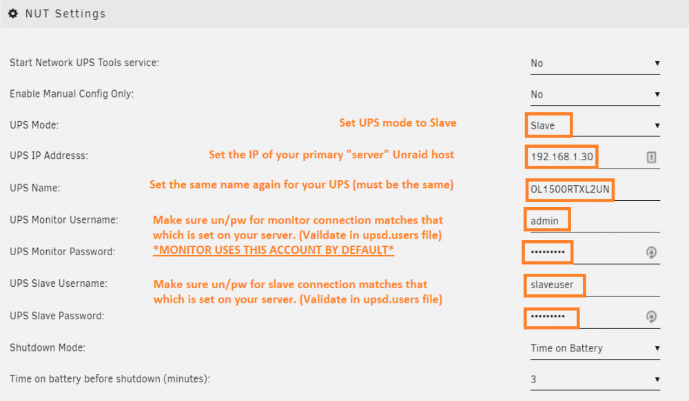

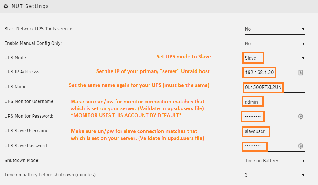

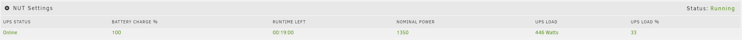

Client Mode:
On the Unraid host that you want to use as a "client", monitoring your server, configure as follows:
-Set UPS mode to Slave
-Set the IP of your Primary Unraid server hosting the UPS
-Set the name of the UPS you chose before (Must match case and everything)
-Validate your UN/PW are correct (use the upsd.users file if needed)
