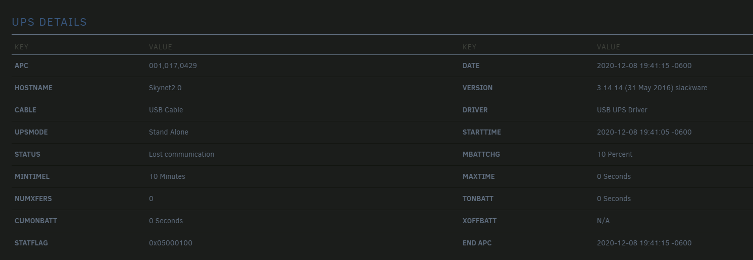

Wanted to share my experience with my setup as I didnt find a lot of info when I was googling around / searching the forums.
I have Unraid 6.8.3 running.   And I'm using a Cyberpower (Cyber Power,  got to get all those tags....) Model brg1500avrlcd I have it connected via USB cable to a USB 2.0 port on my X570 Gigabyte motherboard.
I previously had a very large I think it was EATON UPS working with this install before changing the motherboard and processor.
When I initially tried to get the new setup working, the built in UPS settings wouldn't work (kind of expected that, they seem to prefer other brands of UPS).  When I would hit auto detect in the NUT settings it would find my ups, but when I'd turn on the service and hit apply the service wouldn't start it would still say "Status: Stopped"
Reading through this thread, I did the following.
Tried setting the built in UPS settings to those listed on the 1st page of this thread.
To disable the built in UPS try settiing it to:
Start APC UPS daemon: No
UPS cable: Custom
UPS type: Dumb
That didn't seem to help.
I uninstalled the NUT plugin and reinstalled that again didn't seem to help
I think tried these commands and saw an error.
root@phoenix:~# /etc/rc.d/rc.nut start
Writing nut config
Updating permissions...
Network UPS Tools - UPS driver controller 2.7.4.1
Network UPS Tools - Generic HID driver 0.55 (2.7.4.1)
USB communication driver 0.43
Using subdriver: CyberPower HID 0.5
Network UPS Tools upsd 2.7.4.1
fopen /var/run/nut/upsd.pid: No such file or directory
listening on 0.0.0.0 port 3493
Connected to UPS [ups]: usbhid-ups-ups
Network UPS Tools upsmon 2.7.4.1
fopen /var/run/nut/upsmon.pid: No such file or directory
/etc/nut/upsmon.conf line 1: invalid directive MONITOR [email protected] 1 master
Using power down flag file /etc/nut/no_killpower
Fatal error: insufficient power configured!
Sum of power values........: 0
Minimum value (MINSUPPLIES): 1
Edit your upsmon.conf and change the values.
I uninstalled the NUT plugin again and removed the /boot/config/plugins/nut directory (not 100% sure that path is right but its the config/plugin(s) directory on the flash drive) it still had a config file in there.
Then reinstalled NUT plugin > hit auto detect and BINGO! its working!

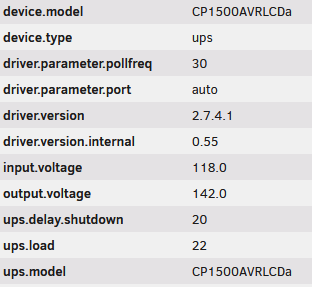

Hi! Thanks for this plugin. I was tired of having random disconnect-reconnect warning messages from the integrated UPS utility with my USB connected CP1500AVRLCD. I'm surprised by two things that I see now that I have NUT configured though. First off, I can't seem to change the Master IP address? I stays stuck on the default 127.0.0.1 even though the field seems editable.
The other detail, a bit more striking to me, is that it says my UPS is outputting at a unnecessarily high voltage? When I had it connected through a windows client I remember setting it at the strictest voltage control settings but right now it's receiving 118V from the wall and sending out 142V if NUT is to be believed. Is that information reliable? And if so, is it configurable through NUT?
edit: I re-activated the integrated UPS utility and that one says my UPS is both receiving and outputting at 119V, which sounds more normal.
Edited by audiocycle
additionnal info
7 hours ago, audiocycle said:
sending out 142V
It shouldn't means current output voltage, but when on battery, your output setting would be 142v. My UPS can set that too.

Hi there! I posted a bit on another tread about a CyberPower CP1500PFCLCD UPS and some issues I was running into and wanted to post here on what I found. The goal is to edit my shutdown and start times for the CyberPower UPS because it does not play nice with "Turn off UPS after shutdown".
Problem:
This is what I just tried:
  • ups.conf:
[CP1500]
	driver = usbhid-ups
	port = auto
	offdelay = 300
	ondelay = 0
	ignorelb
	override.battery.charge.low = 50
	override.battery.charge.warning = 60
  • "Start Network UPS Tools service"=No (Because Yes would not start on reboot)
  • "Enable Manual Config Only"=Yes
  • Edited "/boot/config/go" to contain:
    • bash /etc/rc.d/rc.nut start
Upon a power outage the server will shutdown cleanly and the CP1500PFCLCD will count down from 5 min and remain off when done. When power is restored I see it counting down from 10 seconds and then it turns itself back on. Exactly what I want...EXCEPT...NUT will reset ups.delay.shutdown and ups.delay.start to their default values of 20 and 30 blowing the whole setup randomly.
When I noticed the reset I saw this in the logs:
usbhid-ups[16281]: nut_libusb_get_string: Pipe error.
usbhid-ups[16281]: nut_libusb_get_report: Input/Output Error.
Any help would be much appreciated. I would love to get my CyberPower UPS to shutdown and restart upon power loss/restore if possible!
Thanks!
EDIT:
After watching and reading the logs the reset is caused by whatever this error is doing:
usbhid-ups[3459]: nut_libusb_get_report: Input/Output Error.
Google is coming up with this thread and not much else around this error.
Edited by JimmyGerms
