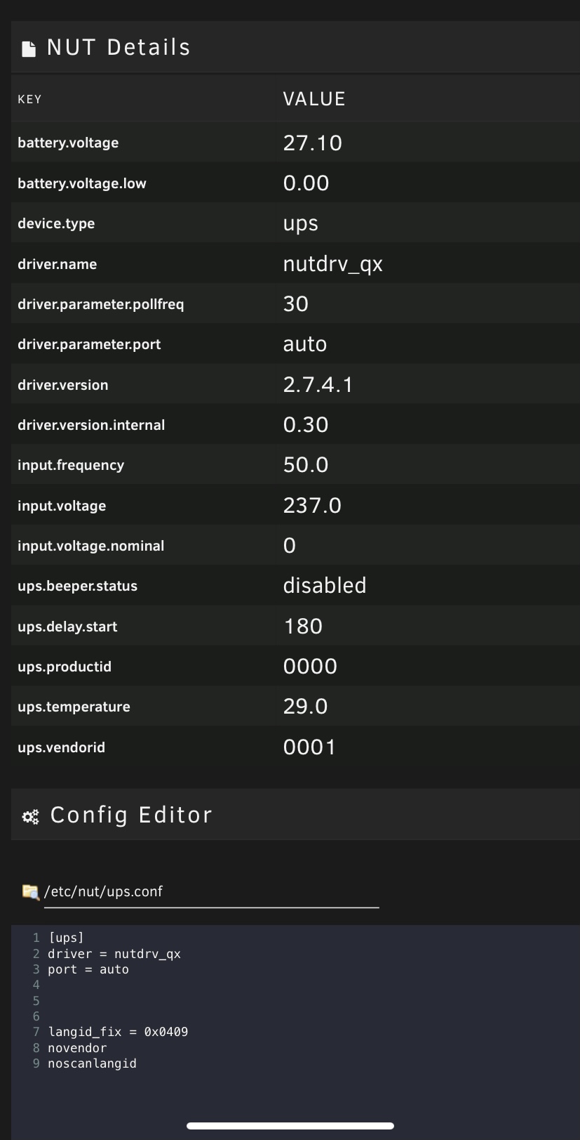

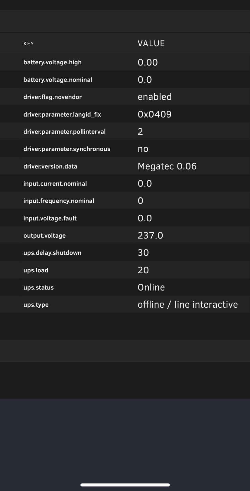

You’re right. The manual only shows 12v. But typically if you post something inaccurate, you get helpful responses. 👍
see attached screenshots of NUT which don’t show a lot either.
so based on your link.
high = 13v
nominal = 12v
low = 10.7v
although NUT says battery voltage 27.10? So the batteries in series?
so high = 27.10v
nominal = 24v
low = 21.4v
Edited by Jammy B

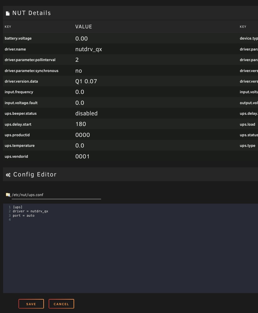

On 6/24/2021 at 4:32 PM, IGHOR said:
You need to find out those values for your ups
default.battery.voltage.high =
default.battery.voltage.low =
default.battery.voltage.nominal =
having an issue making the above settings persist in ups.conf
as you can see below. It’s disappeared.
how do I keep them in the ups.conf file?
all works when in battery mode.
edit
nothing works until I put it all back in.
Edited by Jammy B

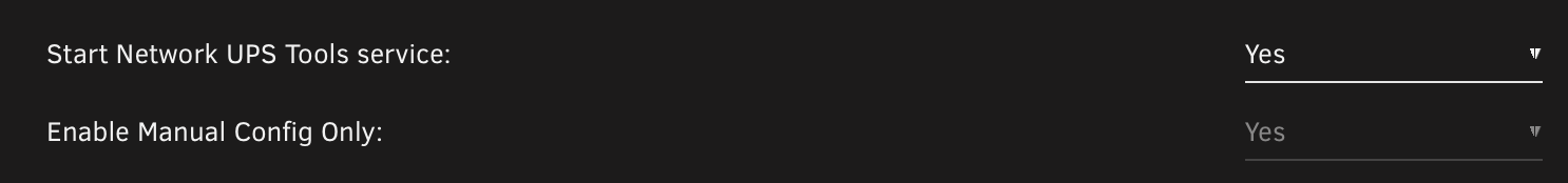

You need to use manual config only
ahh
every days a school day.
will re-edit my ups.conf file and make sure its enabled.
thanks for the advice @IGHOR as always,.
