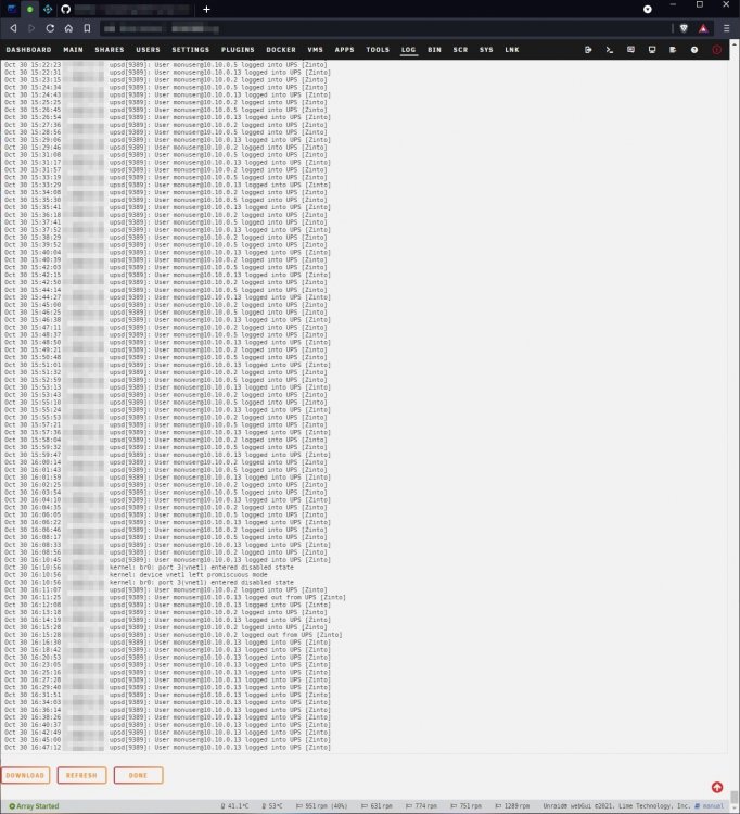

Hello,
I have recently switched my UPS to netserver operation. But since then the syslog is spammed full. (login notes see picture). The client utility is WinNUT...
Is there a way to suppress this or write to another logfile?

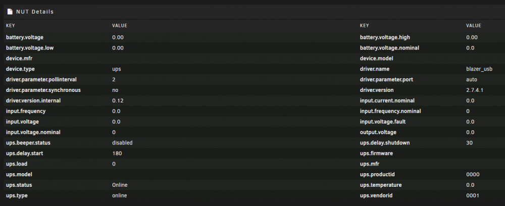

Probably a very noobish question but how do I edit the config files to add in the battery voltage levels?
I have a Powercool 650Va which I have got online and working but it doesnt show up the battery voltage levels and apparently I need to manually edit them in.  If someone could point me to the file location where I can do this I would be very grateful :)
Also do I need to fill in the input voltage flelds?  This is my first time setting up a UPS and its all a bit confusing as finding all this information has turned out to be very difficult.
Edited by MendipMan
typos
you need to enter them in the ups.conf file
i entered this:
ups.conf
Powercool 1000va
[ups]
driver = nutdrv_qx
port = auto
vendorid = 0001
productid = 0000
protocol = hunnox
langid_fix = 0x0409
novendor
noscanlangid
default.battery.voltage.high = 27.50
default.battery.voltage.low = 21.40
default.battery.voltage.nominal = 24.00
