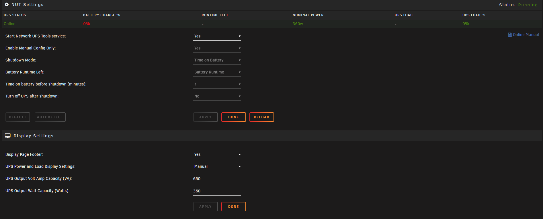

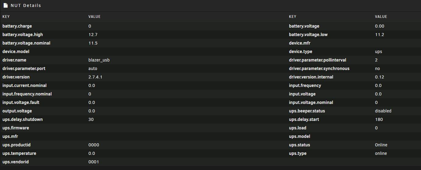

Well, I've added the values for a 650va to the config file, reloaded NUT and it hasnt made any difference at all.

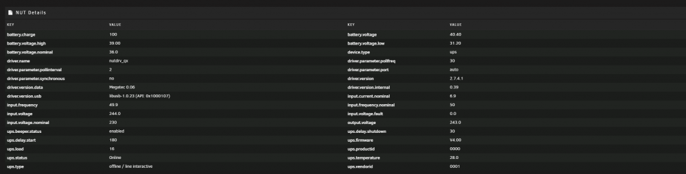

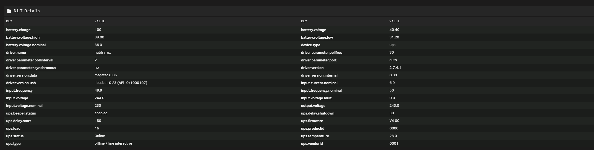

Interestingly if I change the driver to  nutdrv.qx or nutdrv_atcl_usb it just shows the blazer driver.  The config will also not acept/update the input voltage parameters.
I have tried removing 'default' from the values but that doesnt do anything either.

Sorry, I should of said I have already put the new driver in.  Thank you very much btw @IGHOR
As you can see from the pics I have manual config enabled and It shows that the UPS is online and Load% is in green.
I just wanted to get the battery charge status working.  Oh well its not the end of the world as the UPS works and I only want it for immediate safe shutdown anyway.

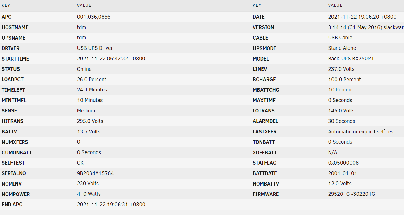

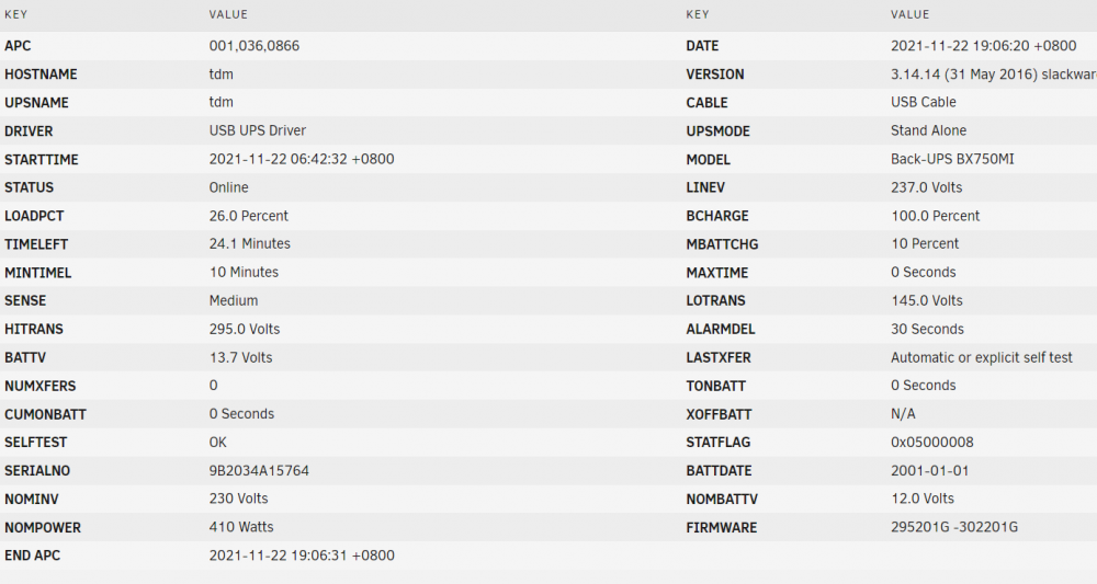

I recently swapped over from my trusty but now dead APC 650cs to an APC MODEL Back-UPS BX750MI.  NET detects it fine and starts monitoring.  After a few hours (twice in 24 hours), it disconnects with the following error:
Nov 22 03:41:15 tdm usbhid-ups[18835]: nut_libusb_get_report: Input/Output Error.
Nov 22 03:41:17 tdm usbhid-ups[18835]: device->Product is NULL so it is not possible to determine whether to activate max_report_size workaround
Nov 22 03:41:17 tdm upsd[18990]: Data for UPS [ups] is stale - check driver
Nov 22 03:41:18 tdm upsmon[18994]: Poll UPS [[email protected]] failed - Data stale
Nov 22 03:41:18 tdm upsmon[18994]: Communications with UPS [email protected] lost
Nov 22 03:41:19 tdm usbhid-ups[18835]: device->Product is NULL so it is not possible to determine whether to activate max_report_size workaround
Nov 22 03:41:21 tdm usbhid-ups[18835]: device->Product is NULL so it is not possible to determine whether to activate max_report_size workaround
Nov 22 03:41:23 tdm usbhid-ups[18835]: device->Product is NULL so it is not possible to determine whether to activate max_report_size workaround
Repeating every second or so and spamming the syslog.  I pull out the USB cable and replug it in, and all works fine:
Nov 22 06:04:04 tdm kernel: usb 1-8: USB disconnect, device number 5
Nov 22 06:04:08 tdm upsmon[18994]: Poll UPS [[email protected]] failed - Data stale
Nov 22 06:04:13 tdm upsmon[18994]: Poll UPS [[email protected]] failed - Data stale
Nov 22 06:04:16 tdm kernel: usb 1-8: new full-speed USB device number 6 using xhci_hcd
Nov 22 06:04:16 tdm kernel: hid-generic 0003:051D:0002.0006: hiddev98,hidraw3: USB HID v1.10 Device [American Power Conversion Back-UPS BX750MI  FW:295201G -302201G ] on usb-0000:00:14.0-8/input0
Nov 22 06:04:17 tdm upsd[18990]: UPS [ups] data is no longer stale
Nov 22 06:04:18 tdm upsmon[18994]: Communications with UPS [email protected] established
Until it crashes again.
I moved over to the Unraid default UPS setting instead of NUT and it's now been solid without any disconnection.  While I don't *need* the Network feature, it was handy to have.  And I enjoyed the UPS status in the status bar.
Any ideas of what could be the issue, or what I can do to resolve it?  here's the UPS Details page for the UPS Settings tab

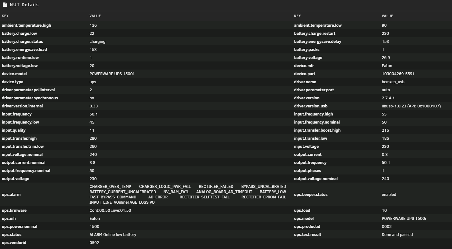

G'Day,
New to NUT and having some issues with an older Eaton 5110 UPS  (http://powerquality.eaton.com/103004259-5591.aspx?cx=3&GUID=133F3D78-6347-45BB-95CB-FD97A6998A07)
Using Auto Detect I get:
        driver = "bcmxcp_usb"
        port = "auto"
        vendorid = "0592"
        productid = "0002"
        product = "Powerware UPS"
        vendor = "Powerware"
        bus = "002"
Services starts but reports almost every error under the sun for the UPS (ups.status = ALARM Online low battery) and won't report battery level, it will however report the correct line voltage and UPS load
. I connected the UPS to my Laptop and installed the proper 'Eaton Protection Software' where it shows the UPS functioning correctly and the battery having no problems at all (replaced both of them about 5 months back)
Read almost every post in regards to Eaton UPS's in NUT and tried finding additional info on https://networkupstools.org/ to no aval.
Attached screenshot of Nut Details below. Any help would be highly appreciated!
Kind Regards,
Julzilla
Edited by julzilla
wrong model

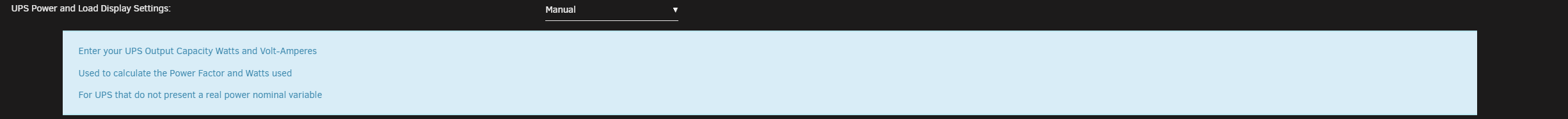

If you look at photo up here in post of user "Blender50", you can see "UPS Load" is around 359watt, or UPS load around 46% (in percentage)... This is how it need to be ...in my case UPS load is 36watt (around 10%)... this is not correct... it should be around 90 watt (around 25% - 30%)... If this was correct, "Runtime Left" could be calculated better...
If i could change something to make wattage display correct, everything else would be correct as well.

Hi!
I'am using Eaton Ellipse PRO 1200 DIN along with NUT but for me it seems like the readed consume Watt is not calculated in the right way for the page footer.
I've set it to Manual (because Auto were more terrible values) with this settings:
UPS Output Volt Amp Capacity (VA): 1200
UPS Output Watt Capacity (Watts): 750
Showing at the bottom a consumption of: 135W
This value is not the value what the UPS is showing on Screen (95W) and double checked with power plug confirms the assumption.
I can see the ups.realpower = 95 which seems to me the right value but why is this value not displayed in the footer?
driver.version.dataMGE = HID 1.43
driver.version.internal = 0.55
driver.version.usb = libusb-1.0.23 (API: 0x1000107)
Have I set up something wrong or is that a bug within NUT?
Thanks
3 hours ago, Skylinar said:
Hi!
Thanks
What value shows on the status in the nut settings.
If you change the power load value to Auto does it show 95?
Edited by SimonF
