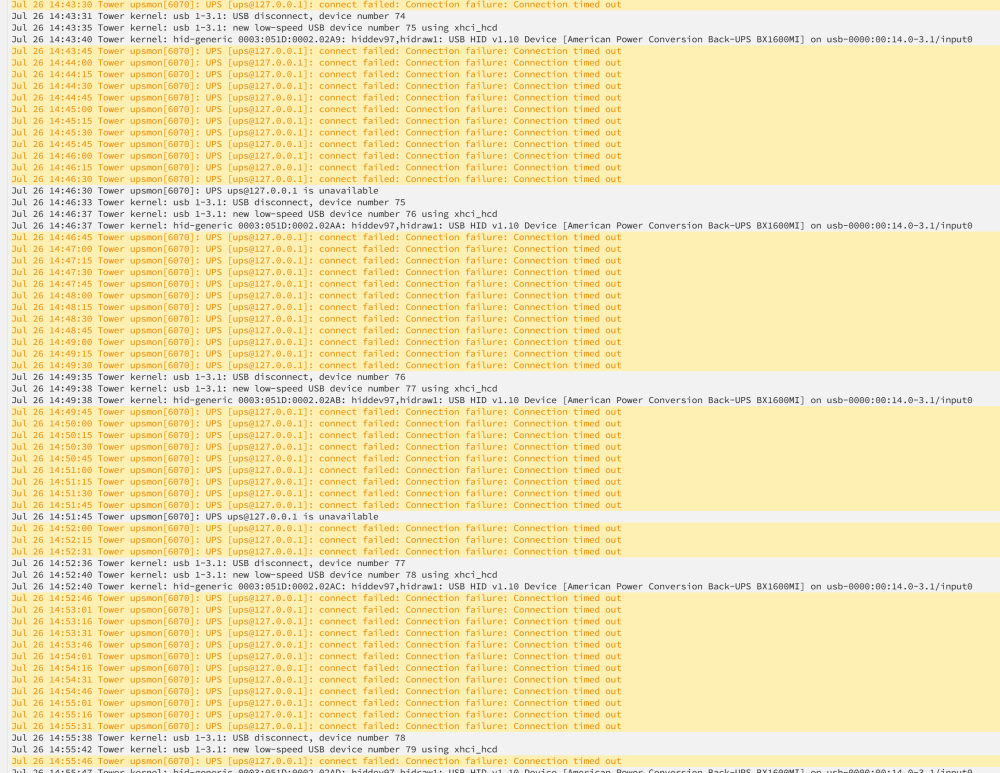

  • I am stopping updates for my version of the plugin. Update to the latest version 2023.09.17 and then you can remove my version and install Rysz's from CA and it will retain your configs.   T
  • Released 2023.07.26, @ich777 is creating a new package for me to use, and I want to look to move to 2.8 as the default version but will need to check upgrade path works ok.
  • That APC BX series is known to suffer from this (what we believe to be) firmware issue and we've put patches in place to suppress this unwanted behaviour on the UPS side. Here's how you can set it up:

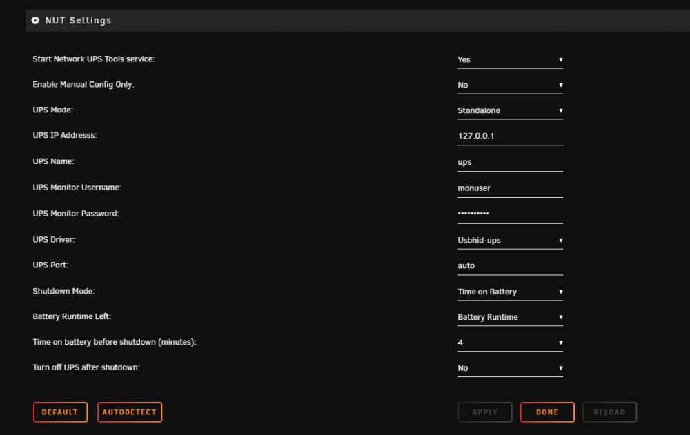

Hey, having trouble getting the plugin to connect to my UPS and I've no idea what's wrong.
The UPS is a CP1500EPFCLCD (https://networkupstools.org/ddl/Cyber_Power_Systems/CP1500EPFCLCD.html)
These are the settings:
/var/log/syslog shows
May  9 00:08:03 plex-server ool www[14337]: /usr/local/emhttp/plugins/nut/scripts/start
May  9 00:08:05 plex-server usbhid-ups[15659]: Startup successful
May  9 00:08:06 plex-server upsd[15666]: listening on 0.0.0.0 port 3493
May  9 00:08:06 plex-server upsd[15666]: Connected to UPS [ups]: usbhid-ups-ups
May  9 00:08:06 plex-server upsd[15667]: Startup successful
but the plugin just shows Status: Stopped
Can anyone help?

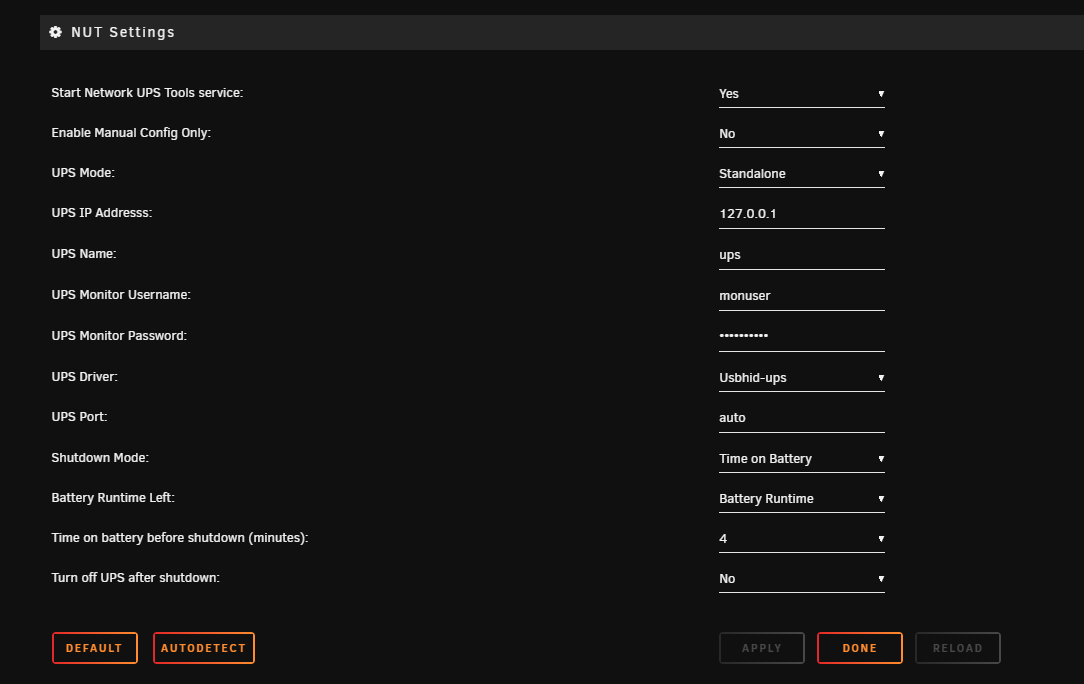

I have problem with ups Power off. I want my unraid to power off itself immediately when main power fails. that is why i set it to
Shutdown Mode:             Battery Level
Battery Runtime Left:     Battery Runtime
Battery level to initiate shutdown (%):    96
UPS Mode:                                 Standalone
Turn off UPS after shutdown:     NO
Unraid start shutdown 30sec after power failure but it also turns OFF UPS. this leads to parity check and to powering off all my network switches and stuff. It also leaves my UPS in strange state that even after returning main power needs me to push the powerbutton on UPS to start working.
This is not happening when my UPS runs ouf of battery.  After power returns it just turns on.
My ups is PowerWalker VI 850 LCD
Can you help me to solve this problem?
I´m pretty sure i read something about to short % or time can cause problems.
And also that it can work for a while but then when batteries wear down starts to cause problems.
But i´m not 100% sure about this, i can have it mixed up with something else and it was a few years ago.
And i think i did have some problem with using a high % on my last ups many years ago, that i solved by using time instead.
Since then i have used shut down after 3min and it has worked fine chosed 3min because when power come back here it almost always shuts of again after 10-20sec and come back after 5sec 3-4 times before it stabilize.
So try a lower % or try time instead and maybe not to low of a time.
And remember when trying this do not have unraid power in the ups (only USB cable).
Connect the power to a regular outlet so IF the ups cuts power to early you won´t get a unclean shutdown and a parity check.
As long as you connect the USB cable unraid and ups will talk to each other normally and will initiate a shutdown when you yank the cable or use a on/off switch, so just look/listening for when unraid shut off and see if ups turn of before that or not.

On 8/18/2022 at 7:50 PM, Batman said:
I'm getting the same error message every few days. It doesn't seem to correlate to a particular time or event. Unraid's built-in UPS tool never had these dropouts, but I switched to NUT because APCUPSD interpreted the fully-charged state of my UPS as a power failure (my UPS was reporting "Online + On Battery"). I have an APC BGM1500B.
When I unplug and replug the UPS into the server, it works again after restarting NUT. Restarting NUT, or disabling and reenabling without unplugging the USB cable does not fix the problem.
It would be nice to actually solve the issue, but I wrote a short script that resets the USB when the connection is lost. It's scheduled to run on a regular basis with the User Scripts plugin.
#!/bin/bash
# Test communication with UPS
if upscmd -l ups > /dev/nul; then
    echo The UPS is connected.
else
    echo Error: Communication with the UPS has failed!
    if usbreset "Back-UPS BGM1500  FW:000000G0-313200S9"; then
        echo USB reset completed successfully.
    else
        echo Error: USB reset failed!
    fi
fi
Edit: usbreset now shows a slightly different name for my UPS, so the script above stopped working. I couldn't figure out if or how usbreset would use wildcards, so this modified script works:
#!/bin/bash
else
    # Get USB path for the UPS
    APC=$( lsusb | grep "American Power Conversion" | perl -nE "/\D+(\d+)\D+(\d+).+/; print qq(\$1/\$2)")
    # Test for a USB conection
    if [ -z "$APC" ]; then
        echo Error: No USB UPS detected!
    else
        echo Resetting the USB connection...
        # Reset the USB connection
        if usbreset $APC; then
        else
        fi
    fi
fi
Edited by Batman
