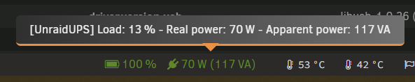

is it normal, that the pop-up is missing when choosing the "small" footer style?
I don't know if the tooltip was present in "small" style, but there is something in the code that prevents it.
Should be fixed in the next update too thanks to @Peuuuur Noel
This was done on purpose and for two reasons.
When I added this to the plugin I was working on small screens remote and I was constantly hovering over it and it kind of bugged me that this always pops up and the second thing was that it made no sense to me to show a tooltip that shows exactly the same.
The whole point for the footer style Small was to make it minimalistic, maybe I should have call it Minimal instead of Small.

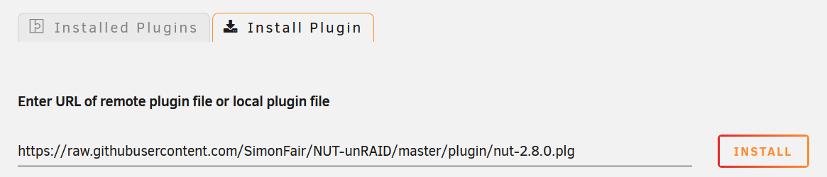

You're not running the 2.8.0 package which has those drivers included.
Please uninstall the plugin, ideally restart the server, manually install 2.8.0 version:
https://raw.githubusercontent.com/SimonFair/NUT-unRAID/master/plugin/nut-2.8.0.plg

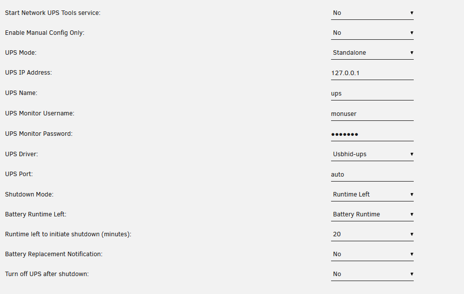

Then set it up as follows:
It should detect it out of the box with the 2.8.0 version - please let us know here.

We would need to know what UPS you are using and what UPS driver your NUT is configured for. A screenshot of the NUT settings page could be helpful too (you can black out your serial number) to identify any problems with the driver.

You could probably also benefit from running 2.8.0 according to your GitHub issue:
https://github.com/networkupstools/nut/issues/569
Then please report back here if it works with the 2.8.0 version of NUT
Thanks alot! It works now! 👍👍👍

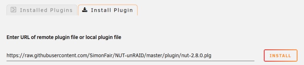

You can install the plugin without a restart (I just tend to recommend it so there can be no traces of the "old" 2.7.4 backend messing with the "new" 2.8.0 backend). The worst thing that could happen is that it's not working until you restart the server, but it's not likely to happen overall.
Regarding the versioning - both "flavours" (default 2.7.4 / experimental 2.8.0) of the plugin always have all the recent changes. They use exactly identical code (same code package) as far as the plugin itself is concerned, just the backend service is different. NUT 2.7.4 has been the most used and stable for a long while, while NUT 2.8.0 is newer but also offers useful fixes. Down the line I'm guessing (although of course it's up to the repository owner) NUT 2.8.0 will become the default backend at some point.
I'm actually thinking about kicking off a pull request on GitHub where we can discuss what's needed for a smooth transition to NUT 2.8.0, so we can streamline the effort to fix any open problems before updating the backend of the default package to NUT 2.8.0.
Please do report back if 2.8.0 has fixed the problem with your UPS.
