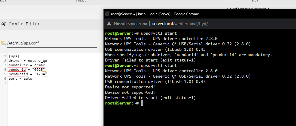

The permission problem is resolved - that's good and important for many other users (thanks for this!)
Can please you try putting subdriver, vendorid and productid starting from line 7?
[ups]
driver = nutdrv_qx
port = auto
subdriver = armac
vendorid = "0925"
productid = "1234"
It's a known oddity that causes problems in some cases.

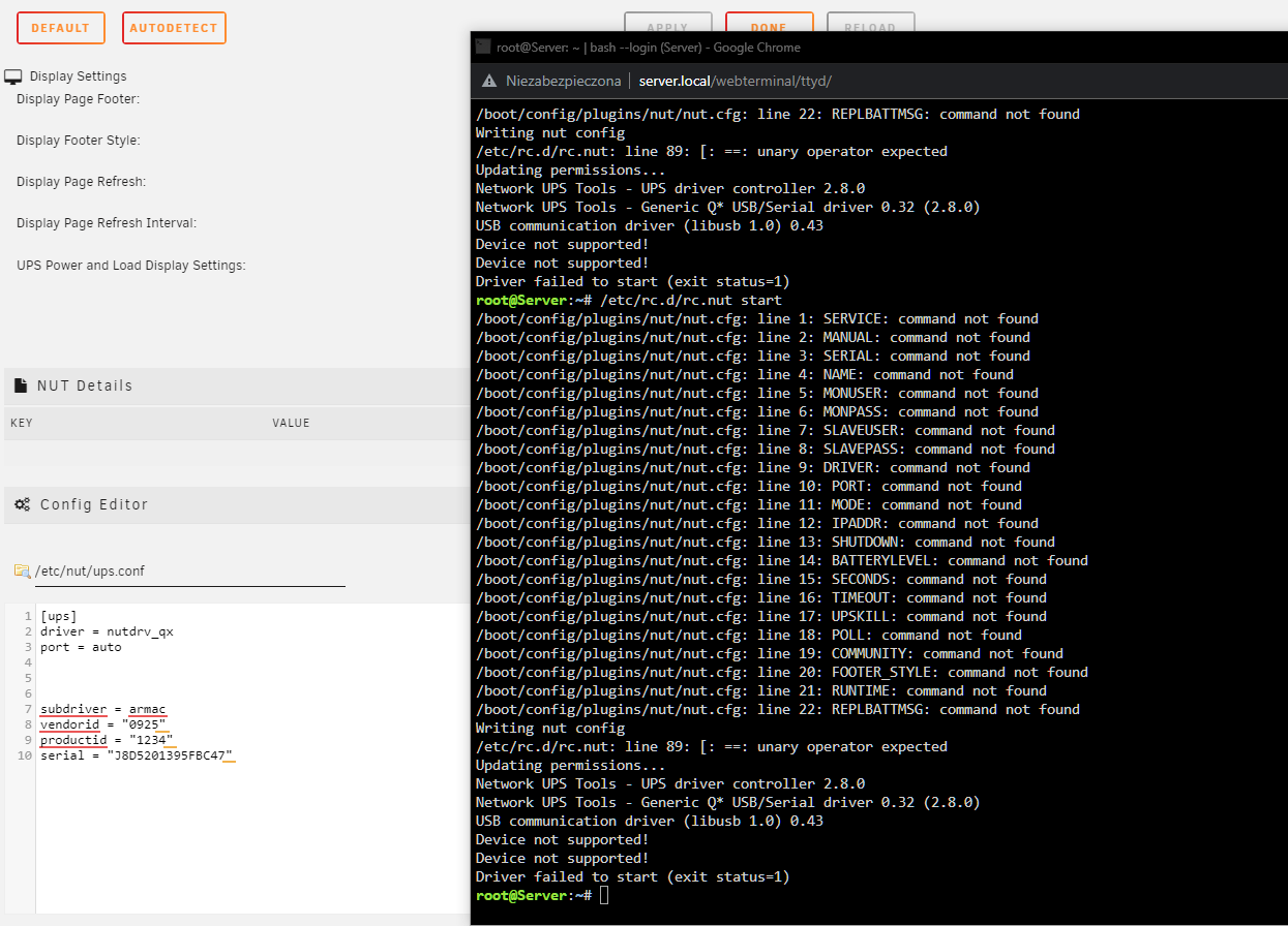

Tried both with serial and without, and with the records in specific lines, as indicated – no dice!
The logs indicate something in your configuration is broken.
You should remove your broken configuration file:
rm -f /boot/config/plugins/nut/nut.cfg
After you should remove and reinstall the 2.8.0 plugin.
After that's done disable the NUT service via the NUT settings.
After that's done edit the ups.conf as shown above via the NUT settings (mind the line 7 oddity as you did before).
Make sure to also set the driver to "Custom" and "nutdrv_qx" as well as the "Port" to "auto" in the NUT settings, not just inside the file.
After that's done enable the NUT service via the NUT settings and report back here please.
After you should remove and reinstall the 2.8.0 plugin and then run these commands right after:
chown root:nut /var/state/ups
chmod 0770 /var/state/ups
Don't restart the NUT service via the command line (rc.nut), it seems to mess up the configuration.

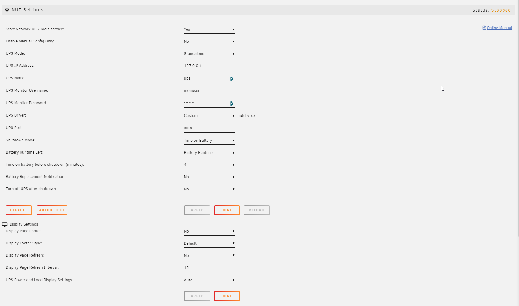

I've followed all the steps as indicated, minus disabling the NUT service via the NUT settings, since it was stopped when I reinstalled it and couldn't 'disable' it anymore.
The outcome is unfortunately exactly the same, even when I try it from CLI as well.

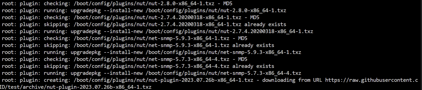

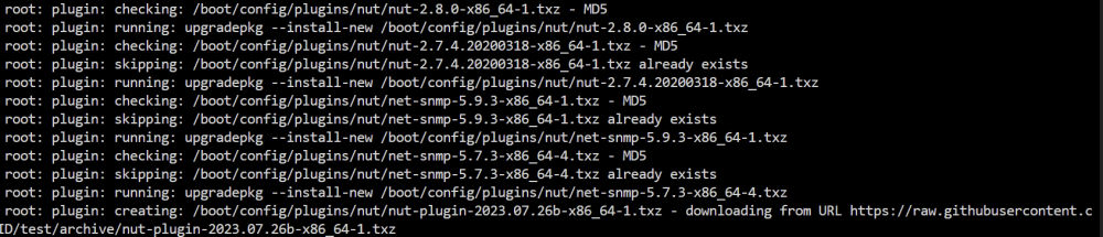

@SimonF just updated the plugin packages with our latest fixes. You can now update the package and don't need the fix-permissions commands from above anymore, so you can try again after the reboot is possible for you (just do the other steps).
If that still doesn't work, then I'm afraid then the Slackware NUT 2.8.0 package doesn't recognize your UPS (maybe it was from an older 2.8.0 build not including the specific drivers for that UPS).
You could wait for NUT 2.8.1. but I'm not sure that'll arrive within your return window for the UPS. Right now there's no indication in those logs that it's a problem with the plugin, rather that your device is not recognized by the driver itself.
Released 2023.07.26, @ich777 is creating a new package for me to use, and I want to look to move to 2.8 as the default version but will need to check upgrade path works ok.
I've installed the latest version and so far (without a reboot) suffer from the same issue.
