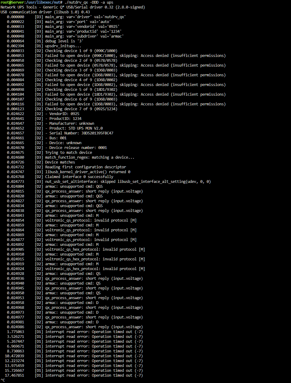

@SimonF, I did try the new package, but my issue persists, as it's most probably driver related.
I am seeking assistance in an issue reported under the NUT repo https://github.com/networkupstools/nut/issues/1978, but if someone here has any pointers, I'd appreciate the help:
Simultaneously, while I have you, the package you shared as an attachment to test, was about half the size of a file under the exact same name, that was loaded to my folder most probably by the 2.8.0 installer for the NUT package shared earlier by @Rysz.
To this end, there could be a few scenarios where something went wrong. Same name, but different contents, is rarely a good thing in coding.
What I had in the ./config/plugins/nut/ folder:
What yours looked like:
Thank you!
Thank you!
Was this before or after the reboot?
The logs from above were with the new package (smaller one) or the old package (larger one)?
The driver does seem to see your device, just not know how to talk to it.

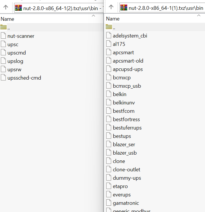

@SimonF @ich777
Regarding the different sizes of the package, I think something is funky with the new package here:
It seems it is missing quite a few binaries and libraries.
I'll try to re-compile and re-package later and will report back here.
Not really.
It seems to me that the other package is compiled differently how it should be.
Please look again at my package and go into /usr/libexec/nut (this is the correct path) and you will see all the drivers (at least that's how NUT calls them).
I don't know how the other package is compiled but when you use the flag:
--with-drvpath=/usr/libexec/nut
the drivers will be installed there.
This is because I don't include the doc and man folder (no man available on Unraid).
May I ask if something is not working? I use it since yesterday and everything is working fine over here.
44 minutes ago, ich777 said:
Not really.
I'm getting random USB driver drops here since using the new package, but could be a cable issue.
Just out of curiosity, did you build from the current GitHub repo or released 2.8.0 source?
Don't get me wrong here, not implying you don't know how to compile a package - on a first glance the amount of differences made me wonder if something went wrong somewhere - just trying to help the user and myself here (trying a new cable this afternoon too) by keeping an open mind.

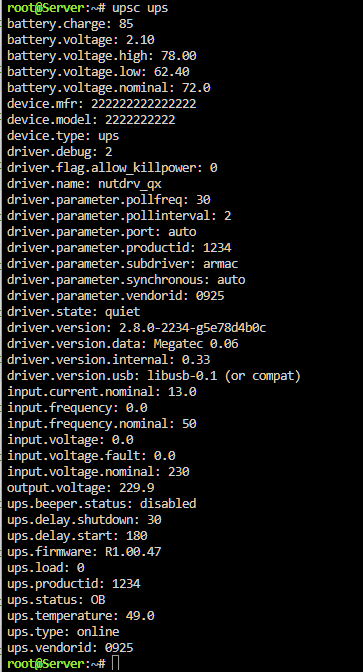

This is just to let everyone know, there has been a lot of troubleshooting done on the armac subdriver since last night, and it seems like different devices need different approaches to data collection.
The current state of affairs is that with a frankenstein setup and a custom compiled driver majority of variables are collected fine, though there is strangness related to batery charge/voltage (which is the same on the device display).
The battery at 0W load goes down then up and down (100%, to 72% and now at 85%, while it shows 2.10V from 72V rating), though this may be an RMA for my unit.
Various commands to switch the UPS operation mode are executed correctly though.
Thank you all!

May I ask why it should be more unstable if I build it with the same libraries that are used on Unraid? This is a bit confusing for me, there are only two things that could happen:
  • It is working
  • It is not working
I would also recommend that you take a look at the old 2.7.4 package and where things are located, this package was basically built by Slackware and I stick to the Slackware conventions at least in terms how things are built and I can customize them for Unraid but in this case I didn't do it because it is a default package.
52 minutes ago, Rysz said:
then we switch to a few days old custom-built package when there's another more long-term tested and stable one around.
But keep in mind that this older package uses maybe older shared libraries which are not fully compatible (will maybe not be not the case) than a newer package which is built for the libraries that Unraid is using.
Just saying to keep that also in consideration.
