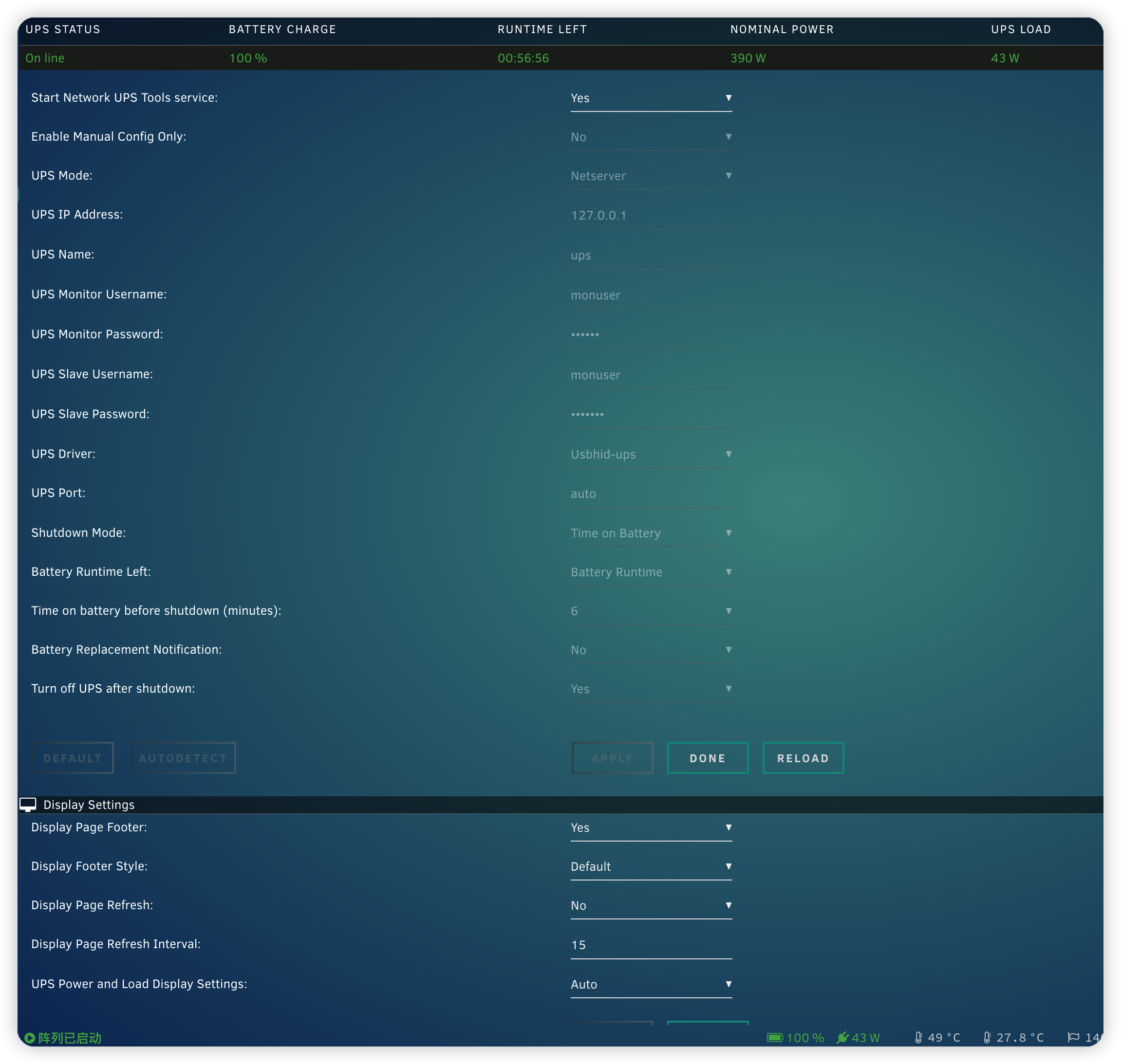

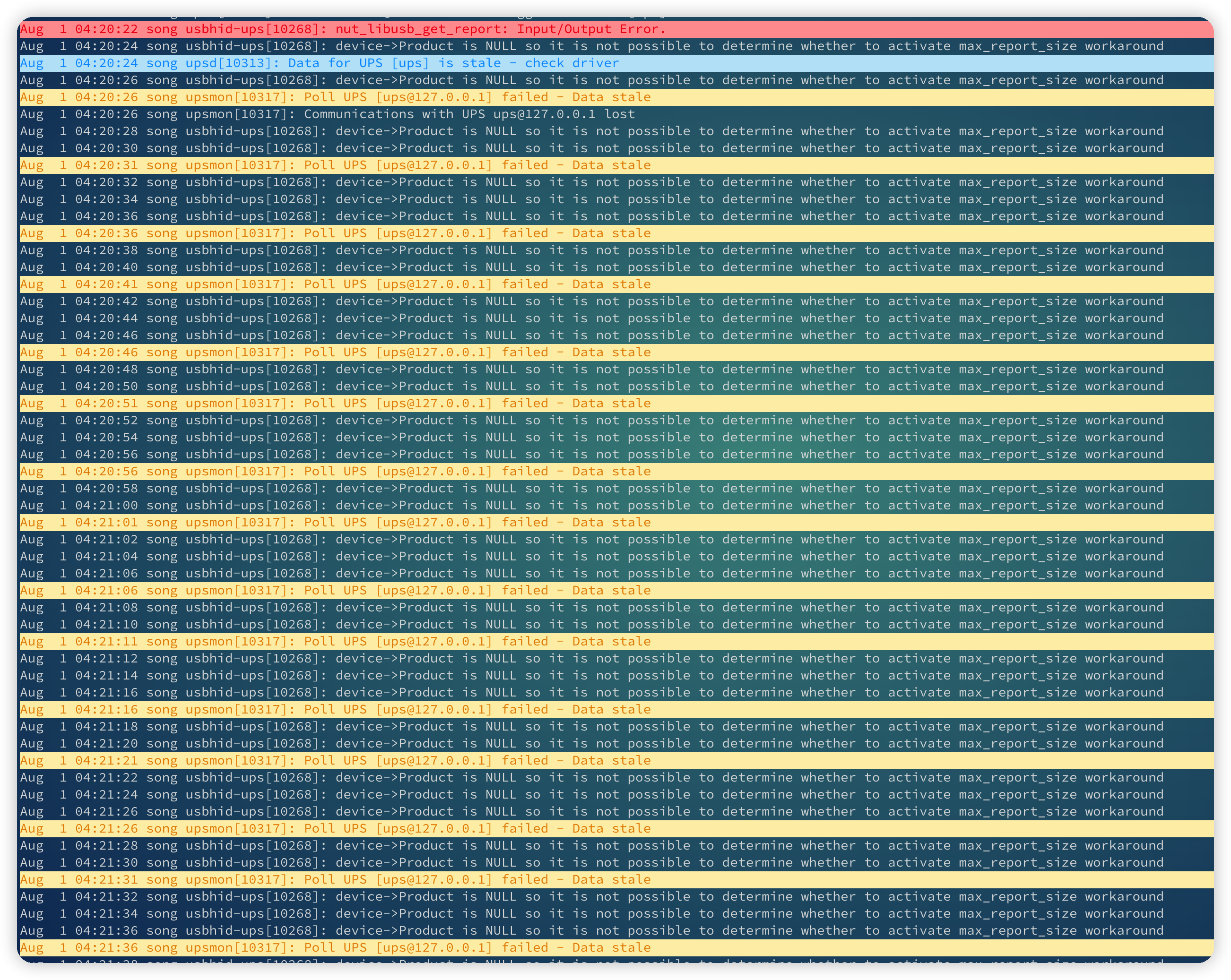

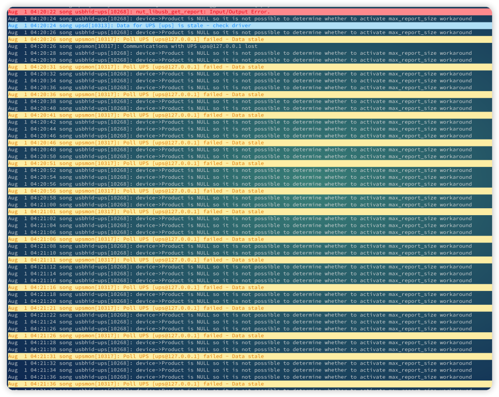

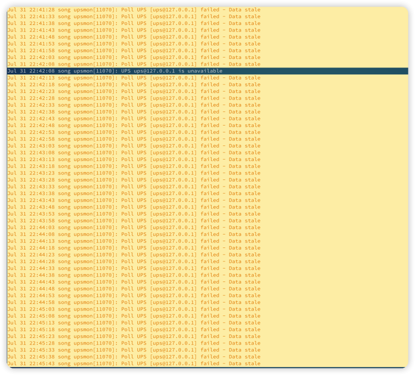

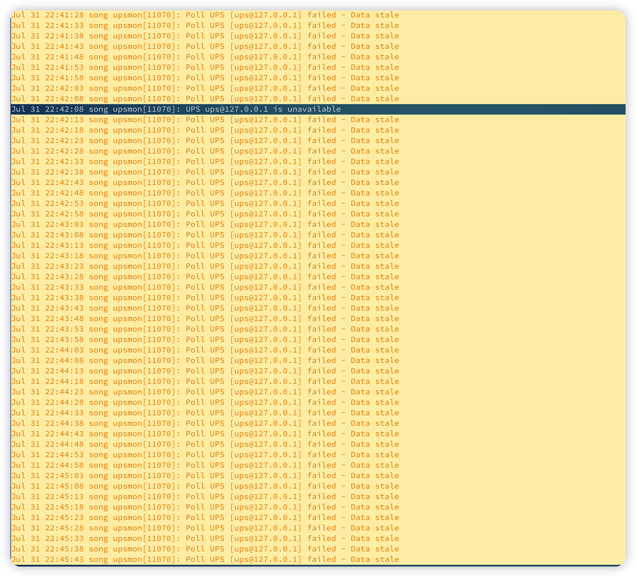

My UPS model is BK650M2, When I upgraded to version 6.11.5, the plugin was running normally and there were no errors in the logs. However, after upgrading to 6.12.3, the old version of the plugin became unusable and I used the new version of "Network UPS Tools". Since then, it has been continuously reporting errors and a large number of warning messages have appeared in the logs. Recently, after upgrading to the latest version 2.8.0 of "Network UPS Tools", the UPS has started to lose connection and must be manually reloaded The 'Network UPS Tools' can only be reconnected after a period of time, but the connection will still be lost. I tried uninstalling and reinstalling' Network UPS Tools', but after a night, it did not disconnect again, but warning messages kept appearing again.
This is a warning message after disconnecting
This is a constantly occurring warning message
This is the plugin's settings page
Edited by song
Do you need to be running as a netserver, do you have other servers attaching to this server? Have you tried as standalone?

interruptsize=num
Limit the number of bytes to read from interrupt pipe. For some Powercom units this option should be equal to 8.
https://networkupstools.org/docs/man/usbhid-ups.html

11 hours ago, jcofer555 said:
i'll give it a try. weired thing is exact same ups when on my last unraid server which was a r720xd i had no errors at all, moved the ups to my new server and now the errors come. same exact config as i pulled the hard drives and flash and just booted up the new server
Might be the USB interface (of the motherboard) then. Could be worth trying a PCIe USB expansion card if it bothers you much.
i have no pcie slots left sadly or i'd try that. it fills the logs up severly so i have to scroll pages and pages to actually check my logs so i can't keep it going that way. i'll just have to use the built in apc plugin which works fine with no errors just doesn't have the toolbar giving me the details in green which i really like from this plugin
I am having a problem with the Turn off UPS after shutdown setting with a usbhid-ups driver in standalone mode. I have tested running upscmd ups load.off.delay 20 in the web terminal and that works so I know the USB shutdown command works it is just not being run on shutdown. It looks like at shutdown it is unmounting the folders before the shutdown command can be run.
Unmounting local file systems:
/usr: successfully unmounted
Restarting udev to be able to shut the UPS inverter off...
/etc/rc.d/rc.nut: line 277: /etc/rc.d/rc.udev: No such file or directory
Shutting down UPS driver...
/etc/rc.d/rc.nut: line 240: /usr/sbin/upsdrvctl: No such file or directory
reboot: Power down
reboot: Power down
There is a fix in 6.12.4 when released for this not a nut issue
