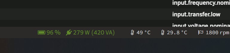

Battery charging animation near Percentage of battery in footer is not working for me somehow , after last update maybe ?
it was loading when charging , but now its static and dont have animation of charging.
using v2.8.0

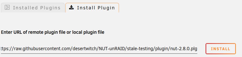

For the two of you and anyone else already on 2.8.0 but still experiencing incompatibility or problems with their UPS: I've compiled a more recent 2.8.0 backend package with the latest commits and changes based on the current state of the GitHub master branch (as of 24.08.2023), feel free to test if these upstream changes resolve your problems and please do report back here.
A ton of bug fixes and changes have been made to the upstream NUT project since the NUT backend package (currently shipping with the NUT plugin) was last built (back on 30.04.2022), so it's definitely worth trying if you're still frustrated over something not working as intended. 🙂
If you do not have any problems, I suggest sticking with what you have installed.
How to install this experimental version with the new backend?
Here's a screenshot to illustrate the process:grafik.thumb.png.0a9716d30d9253166fde50442156c263.png
