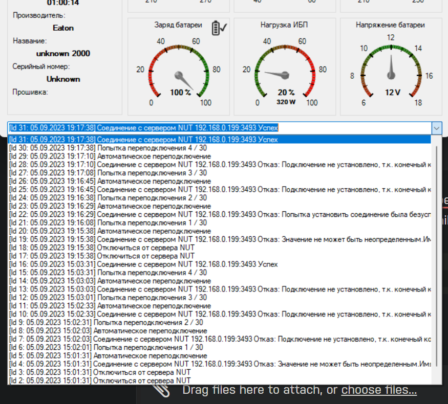

The errors in the logs on the first screenshot are normal because the NUT driver either isn't able to read all values it expects from your UPS - seems your UPS doesn't support all those values the NUT driver is attempting to read - or USB connection wasn't 100% established yet at that point.
Second screenshot is not an error but NUT diagnostic messages checking if another process is already running before starting up.

Also found atemp to reconnect may times from the slave client in Windows.
I just updated my post, I found out what is happening with the VA value - I'll update this with the next version, but this should've been the same in Simon's version because that code wasn't changed.
Is there anything regarding the connection in the logs? I can't read the WinNUT logs so no clue what's happening there. Did this also happen with Simon's version before? If not, probably best to switch back if your UPS plays more nicely with the older NUT backend.

OK, Thanks a lot,  im not sure about lasted version of Simon's but some version befor i checked and think they was the same values.
about WinNUT maybe its my bad and its tryed to connect when server was not ready, i will check it again also with 2.8.0 version.
Thanks for you help
