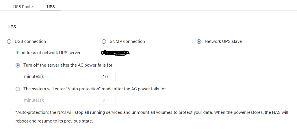

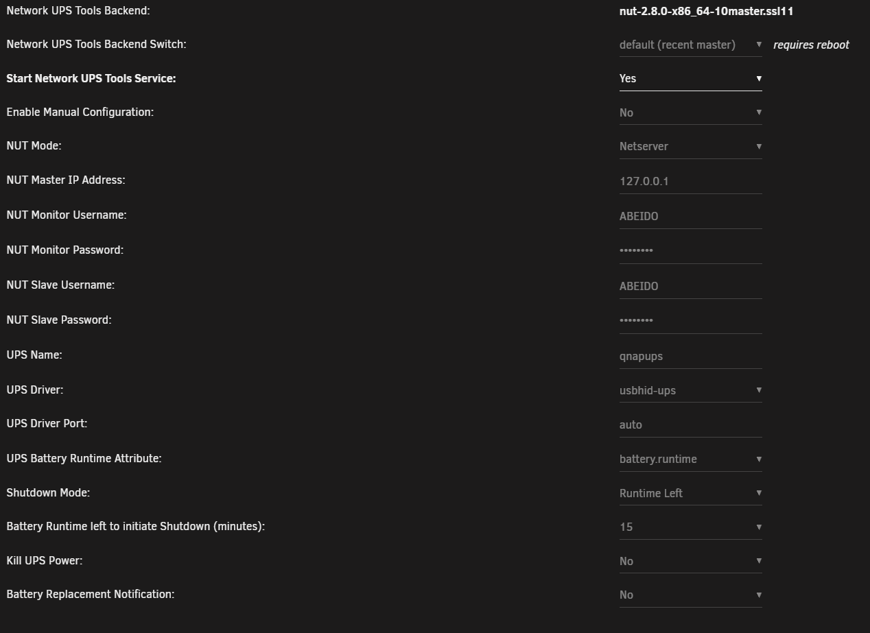

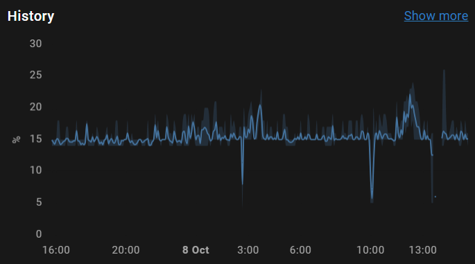

Hi
Been having issues with UPS clients (servers thats using the UPS) power off when NUT plugin is updating.
Am i right to think that changing the Kill UPS Power: Yes to No will solve this?
11 minutes ago, ABEIDO said:
Hi
This definitely shouldn't and doesn't happen with my NUT clients. Are your NUT clients somehow configured to shutdown when losing connection to the NUT master?
The update routine of the plugin just stops the NUT service (on the master) before updating but definitely does not trigger a shutdown scenario.
And no, "Kill UPS Power" just instructs your UPS to cut the battery power to all protected devices after running the shutdown sequence in case of a power outage.
Edited by Rysz
1 hour ago, Rysz said:
This definitely shouldn't happen and doesn't happen with my NUT clients.
Are your NUT clients somehow configured to shutdown when losing connection to the NUT master? The update routine of the plugin just stops the NUT service (on the master) before updating but definitely does not trigger a shutdown scenario.
Have happend a couple of times and im not sure really why. Been reading logs a lot and it seems that the plugin was updated in the vicinity of the time it happend. Som maybe incorrect deduction by me.
Setup:
UPS: Back-UPS RS 900MI connected via USB to Unraid.
Unraid: NUT controls Unraid shutdown normally, power via UPS
Qnap: Builtin QNAP UPS feature is controlling shutdown, power via UPS
RPI(Home Assistant): NUT Integration to HA and automation thats shutdown server at 50% battery and then RPI(itself) at 20% battery, power via UPS.
Server(Windows): Shutdown via automation as above, power via UPS.
Router: No NUT, power via UPS
After looking closer the UPS kills power to all connected devices (Router, Unraid, RPI Home Assistant, Qnap NAS, Server Windows). It seems that Unraid gets shutdown command and turns of fast enough but the others shows logs or messages that points to that they werent shutdown correctly
The Home Assistant automation above wasnt triggerd by low battery so the server lost power. Windows logs confirm it too. So thats why i was thinking that the UPS kills the power outlets before the battery can even be drained by the machines and trigger the automation and so on. Can also add that i heard the UPS tick (switch between battery and power) a couple of times during this(no home power outage thou). It seems to run selftest every 2 weeks and thereyby the ticking and switching between battert and power.
Is there anything you see that im doing wrong?
Could the selftest affect NUT in some way(dont seem to be a way to disable it)?
Could the the kill ups power to no help(or what does it do)?

 Qnap settings
NUT Settings (i change Kill UPS Power this morning to NO)
Edited by ABEIDO

 Qnap settings
OK this is quite an advanced setup you've got there, so let's see.
Definitely before this happens, some kind of power problem occurs (due to mains power loss or mains power condition like voltage/frequency spike as seen in brownouts) OR your UPS is reporting such a state to NUT falsely (due to defective UPS, driver problem ...). So NUT is receiving information from your UPS that makes it consider your UPS to be in a critical state, triggering an immediate shutdown despite any of your configured NUT settings (e.g. "Runtime Left" as "Shutdown Mode").
Interesting is, your UPS is only reporting a UPS "OFF" event to NUT here:
Oct  8 02:35:51 UNRAID upsmon[27897]: UPS [email protected]: administratively OFF or asleep
But are there any more log lines before this one indicating that your UPS is going on battery power at some point? Please post any NUT log lines before this one, if there are any. Because this line on its own makes no sense to trigger such a critical situation - your UPS would need to be on battery for a shutdown sequence as below to occur.
Before proceeding to initiate a shutdown sequence (FSD) thinking your UPS is critical:
Oct  8 02:35:51 UNRAID upsd[27893]: Client [email protected] set FSD on UPS [qnapups]
We need to find out why NUT thinks your UPS is critical, this usually only happens when your UPS is both on battery and the UPS battery is almost depleted at the same time. But there's no indication from your logs (just from the inverter clicking sounds) that your UPS is in fact on battery, that's what I don't understand. Plus, for your UPS to reach such a low battery (critical) state faster than your UPS master & clients can shutdown would mean either the UPS battery is severely overloaded (too much power draw) or on the verge of dying (due to old age or defects). Both should be reported by your UPS somehow, so this wouldn't happen out of the blue (unless something was defective).
In such a shutdown sequence NUT (by default) waits max. 15 seconds for your clients to shutdown. If your clients don't shutdown within those 15 seconds, it proceeds to continue to shutdown the UNRAID server. Normally this wouldn't have negative effects on your clients shutdown sequences, but you had "Kill UPS Power" set to "Yes". So after UNRAID shutdown is completed, it kills the power to all your clients even if they're not done with their own shutdown sequences yet - this is what caused your unclean shutdowns there.
With "Kill UPS Power" set to "Yes" one needs to make sure that the clients start their shutdown sequences earlier than the master and also have sufficient time to shutdown before the master starts shutting down and cuts the power. This is, of course, not possible when your UPS suddenly goes critical for reasons unknown - so we'll need to set this to "No" for now.
So where to go from all this information?
It's not from updating the plugin, definitely, but rather something happening with your UPS. You hear the inverter clicking, so the UPS hardware is doing something at that stage (which is not NUT-caused).
First of all, keep "Kill UPS Power" set to "No" until we figure out what is going on with your UPS. This should at least solve the unclean shutdowns for now, but you'll still see your devices shutting down (though gracefully) when your UPS is going into such a sudden critical state. We need to figure out what's happening with your UPS hardware.
So if there's no power outage this could either be your UPS testing its battery, conditioning power (because of voltage/frequency spikes) or your UPS/UPS battery being defective. A battery test or power conditioning should not cause a NUT critical state, unless the battery is almost dead in the first place and does not even survive the short time on battery power in combination with the load connected. Did you see any lights flickering in your house when this was happening?
First I would make sure your UPS is not somehow overloaded (too many watts for too little battery). If that's not the case, I'd attempt to switch out the UPS batteries, that being the cheapest solution. Especially if your UPS batteries are already older, changing them can be magic to solving very weird problems.
If the problem persists even then I'd consider the UPS defective and have it checked by the vendor. If you're still in warranty for your UPS I'd definitely contact the vendor and get the UPS and UPS battery checked.
Firstly, not many takes the time you took here. So a massive thanks for that :).
Im kinda torn were the problem is as explained below. But in short the UPS new, tests ok and only happens during 2 week auto selftest.
Auto Selftest:
It seems that the problem only occur during auto selftest thats done every 2 weeks. Havent been able to find any way to disable those. They are done at start aswell but no problem then with either blinking or power offs(hard to see as devices are off as ups is off aswell).
Blinking lights:
When i got the ups (first setup) i had some issues with blinking monitor when inverter acted and that was plugged into same area as UPS. This went away as i think i changed Input Sensitivity to low. No blinking during my own testing at all.
Age/wear:
My UPS is kinda new is less than a year old (even warranty on both batteries and ups) and is in a good location with normal temps. All selftest reports ok.
Overload:
Average usage is 80-100w and it should be able to handle 540w and havent been close to that. My homelab is based on lower power usage so no fancy big machines (Optiplex x2, RPI, router and QNAP Intel Atom)
Load history
Test:
Have done full test to make sure all devices and automations works fine before and it was working, had battery runtime on about 40-45 min before it was depleted. Tested a quickie now so i unplugged power to UPS with everything up and running as normal and it worked as expected. Log below
QNAP power outtage test

One major problem I've identified with the configuration is that you're using the same usernames for "NUT Monitor Username" and "NUT Slave Username", but those can never be the same because they come with a different set of permissions each. "NUT Monitor Username" is the one the NUT master will use, "NUT Slave Username" is the one your NUT clients will use. Please change your "NUT Monitor Username" to a different username, you won't need to change any settings with the clients. This will make sure the NUT services can distinguish between who is NUT master and who is NUT slave (client), that's really important for functionality.
I've read about some UPS only reporting a limited set of variables to NUT during self-tests, so it's possible that during these self-tests the "Runtime Left" variable becomes either unavailable or zero for a few (milli-)seconds while the inverter switches between line power and battery power for testing (that's the clicking you hear).
This could (in theory) lead to NUT seeing the UPS on battery power during the testing and at the same time the "Runtime Left" variable unavailable and/or below your configured 15 minutes - resulting in the false shutdown sequence with NUT thinking that it's a power loss scenario.
So I'd suggest doing this:
  • Change "NUT Monitor Username" to something else.
  • Change "Shutdown Mode" to "Time On Battery" (for test purposes)
  • Set "Time on Battery before Shutdown (minutes):" to 5-6 minutes (for test purposes)
  • Set "Kill UPS Power" to "No"
If you can, trigger a manual self-test of the UPS and see if the problem still occurs.
You can also choose "Battery Charge" as "Shutdown Mode", it's still better than "Runtime Left", but "Time On Battery" is mostly independent from UPS-reported variables so it's best for testing now.
In general I'd always advise to using either "Battery Charge" or "Time on Battery", rather than "Runtime Left", because "Runtime Left" is the least predictable and trustworthy of the different "Shutdown Mode"s.
The reason is reported UPS runtime can fluctuate a lot depending on UPS and UPS battery and many UPS vendors do not have clean implementations of this variable.

I didnt know that with slave and master users, good info. Have changed that now.
The manual test acts the same as the schedueled in regards of symptons which i didnt thought was the case, so i have a way of testing solutions now. Btw i tested without Qnap running, didnt want to messup the NAS. And problems is the same even the load now only is 34w when ups is off.
Test 1
-Did a test before but with only Kill UPS Power change to No.
Only Unraid shuts down (correctly thou as it always had) but it does it directly. So not staying on until set rule.
Test 2
-Tested with all the suggested changes. Unraid shuts down (correctly thou as it always had) So not staying on until set rule. So same as before.
Test 3
-Tested with all the suggested changes but with Shutdown Mode Battery Level . Unraid shuts down (correctly thou as it always had). So not staying on until set rule. So same as before.

1
2
In Home Assistant (just as extra info). Yellow status name is same status as above 2. Black part is when unraid is off.
So still same issue but without the powerloss for the connected devices. When i thinkm about it i couldnt have had these problem before on the old repo. I mean i would remember that my nas/unraid/server was down randomly every 2 weeks as i cannot disable auto selftest (what i have found)
Only other ui option i havent touched is:
and
Are those of any importance in regads to the problem?
