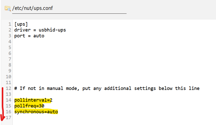

I've read about this a couple of times in the bug tracker of NUT (backend) so far and, as I understood it, this behaviour essentially boils down to the USB driver's implementation in the Linux kernel in combination with that specific USB controller on either the server, the UPS device or both - so this is something that can't really be influenced much from the NUT side of things.
What's always worth attempting is changing the USB port or USB cable, some users have reported connection losses and such I/O-errors because they were using a bad USB port or USB cable.
Over-polling is indeed sometimes an issue with some UPS, there are some ups.conf settings you can tune:
Just make sure to put them in the safe-zone (below line 12, marked with the red arrow):
  • pollinterval = The status of the UPS will be refreshed after a maximum delay which is controlled by this setting. This is normally 2 seconds. This setting may be useful if the driver is creating too much of a load on your monitoring system or network.
  • pollfreq = Set polling frequency for full updates, in seconds. Compared to the quick updates performed every "pollinterval" (the latter option is described in ups.conf(5)), the "pollfreq" interval is for polling the less-critical variables. The default value is 30 (in seconds).
  • synchronous = By enabling the synchronous flag (value = yes), the driver will wait for data to be consumed by upsd, prior to publishing more. This can be enabled either globally or per driver. The default of auto acts like no (i.e. asynchronous mode) for backward compatibility of the driver behavior, until communications fail with a "Resource temporarily unavailable" condition, which happens when the driver has many data points to send in a burst, and the server can not handle that quickly enough so the buffer fills up.
I've used the default values in my screenshot, you'll need to play around with different values to see the difference - please let us know if it had any positive effect on your problem.
Edited by Rysz

Thanks for the suggestions @Rysz, I tried a variety of settings there and a different USB socket, but no joy - I did however confirm that the "nut_libusb_get_string: Input/Output Error" error appears at whatever frequency the polling rate is set to.
For next steps, I will try a PCIe USB card to see if the controller on my motherboard is possibly at fault, and I can also try using my 2nd unraid server as the master. As a last option, I can try making my TrueNAS scale server the master, however I'm not sure if that can act as a NUT master.
Will report back with any progress made, thanks again

Oct 19 15:56:26 SauerRaid usbhid-ups[1972]: libusb1: Could not open any HID devices: insufficient permissions on everything
What can I do to fix it?
I'd try another USB port and see if the problem persists, such logs have been occurring for other users where USB ports or cables died.
I've changed the values to 5s and 31s and enabled synchronous (for ever it may be good). But only on the PI so far, not sure where to to put them in UNRAID.
Everytime I try to add them into the "NUT Configuration Editor" of the Plugin it tells me "configuration error" "/usr/local/emhttp" "Error saving configuration file"
POLLFREQ 5
This is what you'd put in upsmon.conf on UNRAID via the NUT configuration editor in the GUI. You might need to "Reset Config" since yours seems broken somehow.
The other lines (from the post) are only for the server the UPS is physically connected to.
Edited by Rysz
