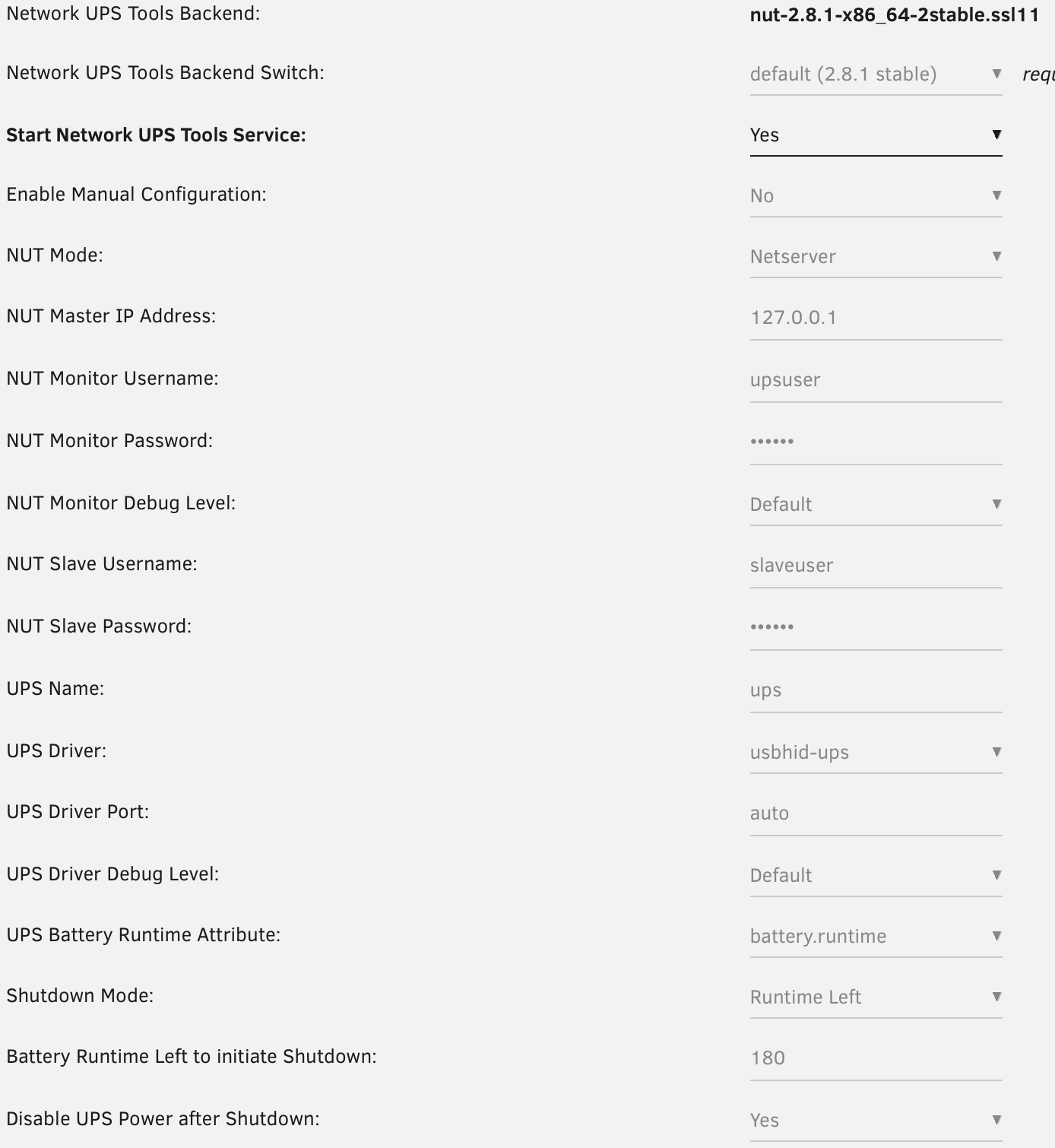

On 9/4/2023 at 7:44 PM, DataBitz said:
Just wanted to share my working configuration where Unraid is a Slave and pfsense is the Master, for anyone else looking.
Eaton 3S 850 connected via USB to pfsense (192.168.1.1)
pfsense config
Unraid NUT v2 config.
I am curious to know if you had to make any changes to this configuration recently?  I tried applying the same settings (I am also using an Eaton UPS unit [5P 1500]) but am not able to get Unraid to grab info from the pfSense gateway.  Also, I do not have a UPS Slave Username or UPS Slave Password on the Unraid settings.   This is all that is available to me.
Edited by jimeez
Just now, jimeez said:
I am curious to know if you had to make any changes to this configuration recently?  I tried applying the same settings (I am also using an Eaton UPS unit [5P 1500]) but I do not have a UPS Slave Username or UPS Slave Password on the Unraid settings.   This is all that is available to me.
You need to set NUT Mode to Netserver.
On the Unraid side or pfSense side?  Just to clarify, I am using (or attempting to use) pfSense as the master and Unraid as the slave.
Thank you for the amazingly fast reply by the way.
Ah, my bad, in that case you'll put the pfSense's configured Slave username and password (that'd be monslave and yourpassword in the original screenshot) into the respective NUT Monitor username and password fields on the UNRAID server. NUT Mode would, of course, be Slave on the UNRAID server. 🙂
The second credential fields were recently hidden because they were unused in NUT Mode Slave.
That's also the reason it didn't matter the user from the screenshot had the same values in them.
Edited by Rysz

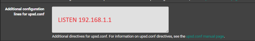

That's weird, is there anything in the UNRAID logs indicating a problem?
Is it possible that pfSense (being a firewall) blocks LAN-access in/out from TCP Port 3493 (NUT)?
Well how about that.  There sure is.  ;-)
I'll do some poking around in pfSense and see if it's being blocked somehow.  Good suggestion.
Edited by jimeez
Indeed it seems like the pfSense is dropping the incoming packets to your NUT server's port on TCP 3493.
Please do report back if you managed to open the port and if it worked out for you eventually. 🙂
A quick search on Google returned another thing worth trying could be adding this on your pfSense:
But judging from the screenshot of the original poster this shouldn't be necessary anymore. The requirement of an open TCP port 3493 for inbound/outbound on the LAN remains, so I think that's the main issue here.
Edited by Rysz
I figured it out by using some of the settings in this write-up.   I had to add additional configurations to ups.conf and upsd.conf.  The instant I hit SAVE on the pfSense box, UNRAID saw the info instantly.
EDIT: the ups.conf line is NOT needed.  Only upsd.conf setting.
