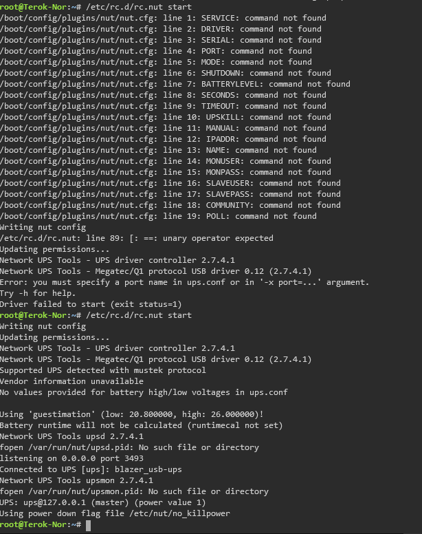

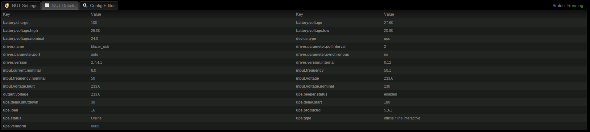

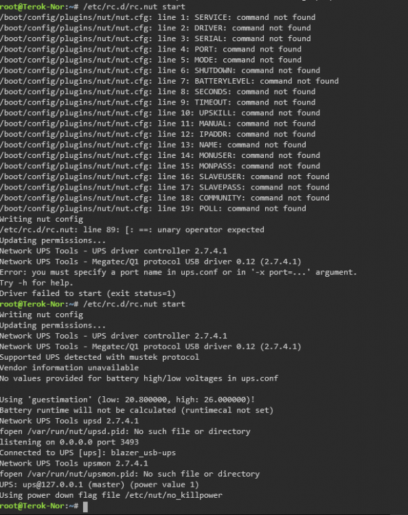

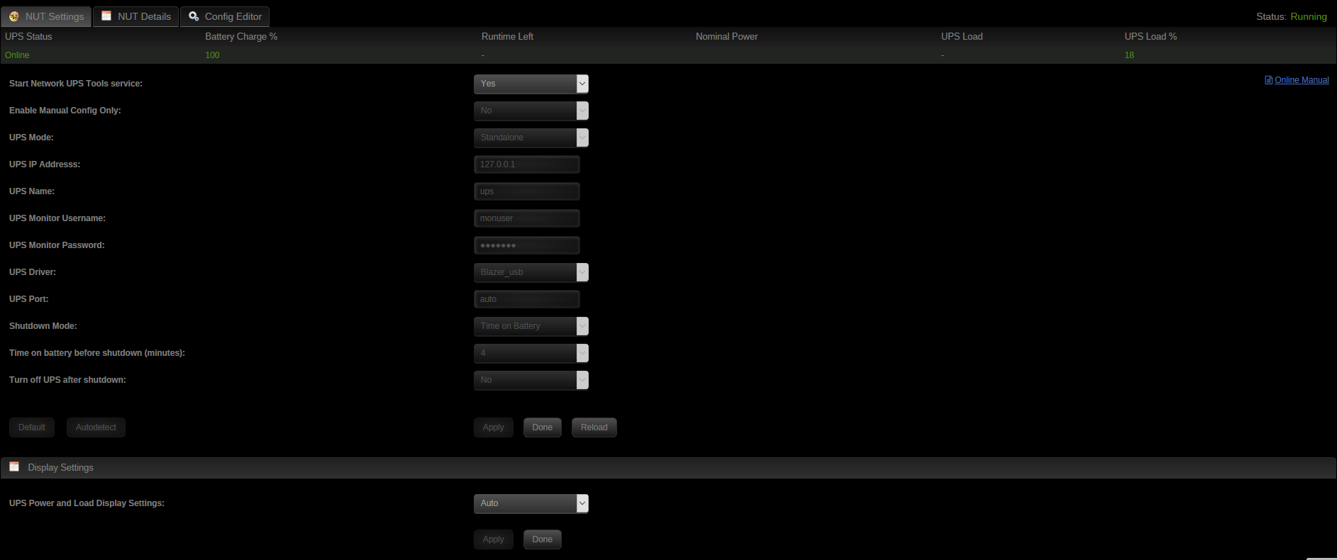

Hey All
Just some info if any one knows why?
I have a Mecer ME-2000-VU 2000VA/1200W Line Interactive UPS
I upgraded to unRAID 6.4 from the version before and then when i rebooted NUT would not start.
Tried all sorts uninstalled reinstalled and nothing.
Then read a post here and set all to default and port to auto and manually ran the nut start.
Now working again.
I have made no changes to the config before the upgrade is there something I need to do to keep it from happening again
here are my settings
does nut have a conf file that I can backup if this happens again or should the autodetect just work as from my log file I was getting this before it started

Unless using complete manual mode the conf files are overwritten using info from /boot/config/plugins/nut/nut.cfg. To me it looks like there was something wrong with your nut.cfg, possibly edited with notepad or another editor that isn't compatible with Linux. I'm not sure why moving to 6.4 broke it though. The disconnects are kernel related and I get them to, even on a fresh reboot with no nut. I even had to disable usb3/xhci in the bios. But they should stop after the nut driver connects. You can also set the display settings at the bottom to manual and enter in your UPS values to get an estimation of power used.
