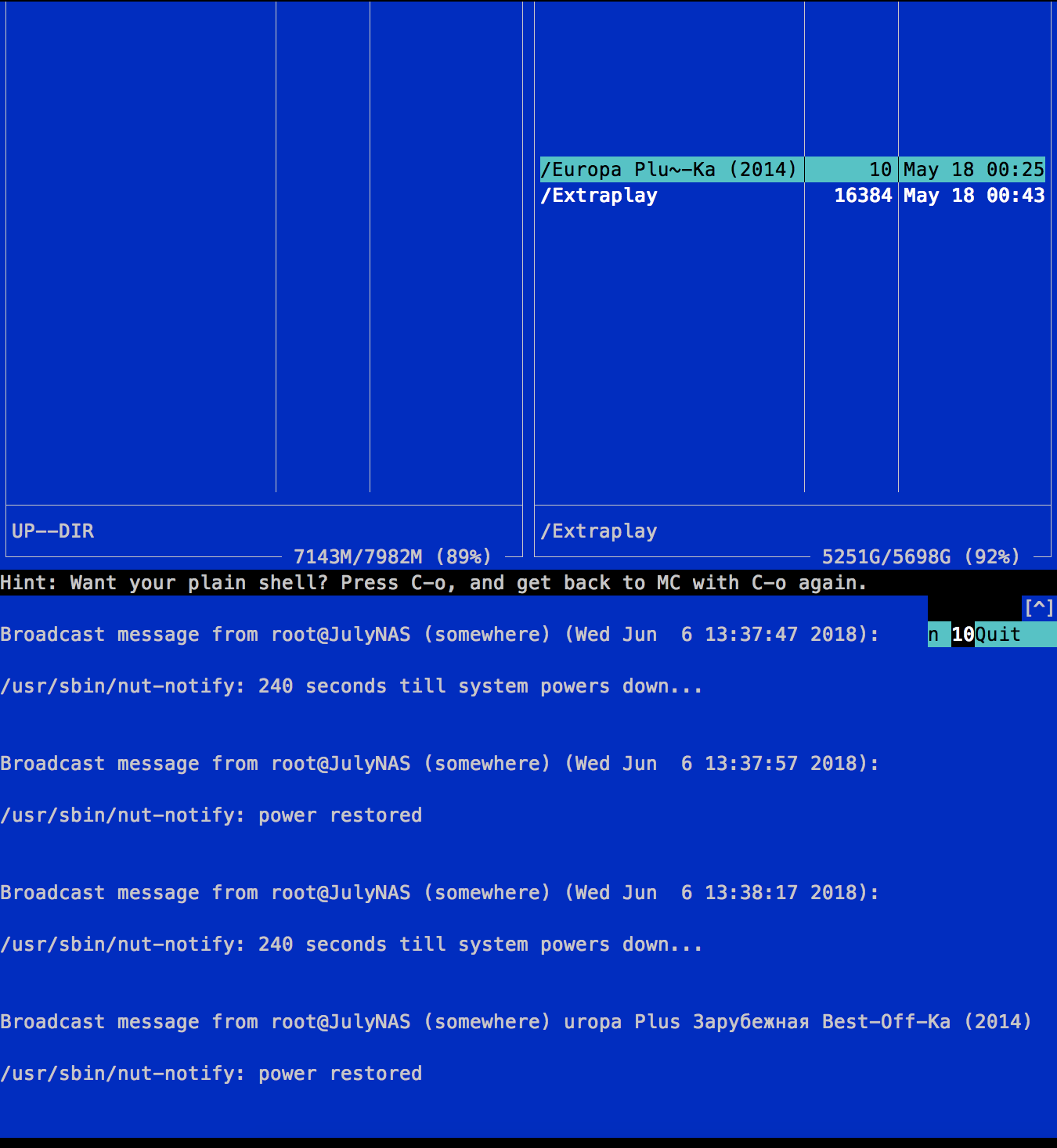

My neighbors use welding device often, so I'm getting lots of notifications pair "The UPS is on battery" and "The UPS is back on line" that comes instantly together.
I would like to configure it to send notifications only if UPS is on battery at least 10 seconds.
How can I do it with this plugin?
PS: also it breaks terminal with mc, check out screenshot

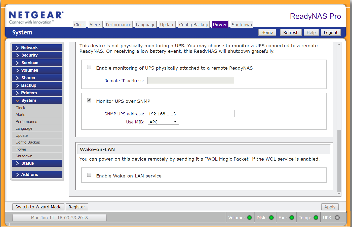

Hello,
Can this plugin issue SNMP alerts for a locally connected UPS?
I have a Readynas Pro that can receive SNMP alerts about UPS.
1717857660_Screenshot2018-06-0613_49_35.thumb.png.90aed988414e1d851356f96db7e7109c.png
I'll look at the notification timing. As far as mc, this plugin had no effect on that. It only loads nut and net-snmp
Hello,
All I know is you can monitor a snmp UPS

Hello,
What does that mean?
Can this plugin load the SNMP protocol?
If so then can it load the APC mib?
Only then can my Readynas connect with my Unraid and therefore my UPS.

Hello,
Sent from my iPad using Tapatalk Pro
The plugin uses this driver. You just need to input the community string.
https://networkupstools.org/docs/man/snmp-ups.html
