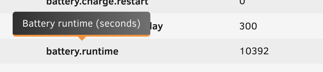

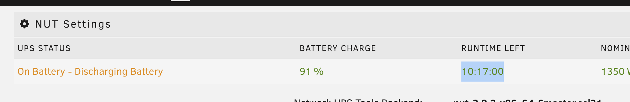

Somehow the runtime shown here:
is different from battery.runtime number:
10392 sec = 2 hr 53 mins (this is the accurate runtime left shown from UPS itself.)
Thanks!

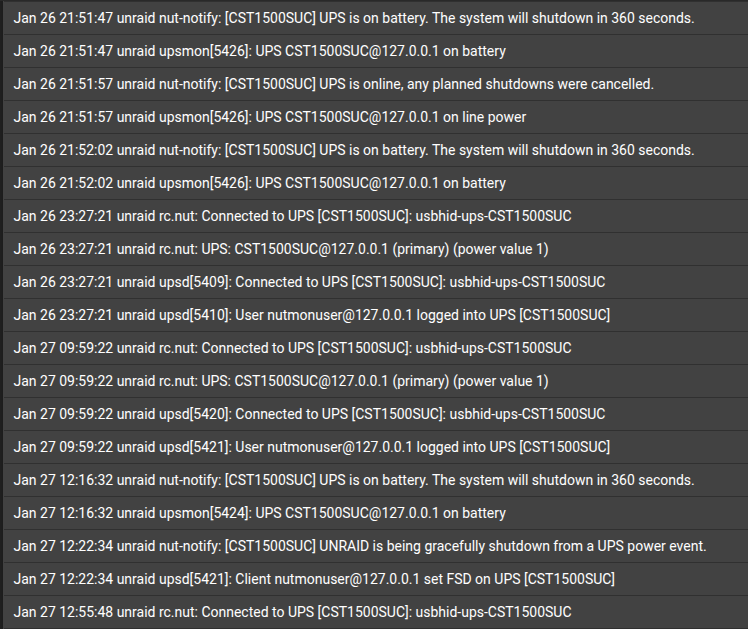

We experienced a power outage yesterday and the NUT plugin failed to execute a safe shutdown sequence but fortunately I was home to take care of it. I've attached syslog notifications showing the sequence of events, but to provide some context we initially had the power go out for a few seconds, come back on for 3-4 seconds, then finally going off again continuously for about 2 hours.
The nut plugin showed the system was on battery power and even gave an alert twice that it was going to start the shutdown sequence in 360 seconds (I have unraid set to shutdown 6 minutes after going on battery, NUT settings shown below). There was notification that the initial shutdown sequence would be cancelled, but you can see that a secondary sequence was started immediately afterwards. I'm wondering if there was some timing issue where both shutdown sequences were cancelled while still on battery power. Ultimately NUT did not start start a shutdown sequence and I had to safely shutdown everything manually.
Any thoughts on a more robust method for ensuring this doesn't happen?
Regarding the attached images (specifically syslog), the initial power loss was on the 26th at the start of the log shown. The shutdown sequence at the end of the log on the 27th was me testing to make sure NUT was behaving as expected with a "normal" power loss scenario - I just pulled the UPS plug and NUT shut everything down safely as expected.
It's hard to trace a problem from these logs, everything seemed to work as expected (except for it actually shutting down). Interestingly, it also doesn't seem like some kind of race condition has occurred. The logic of the notification-handling shutdown script has been largely unchanged for the past 8 years and I've not had a significant number of other reports of this happening, so I'd consider it more of a random occurrence (especially as it seems to work in your later test). I'll still look some more into what could possibly lead to (?) race conditions and how to make the notification handling more resilient - thanks. 🙂

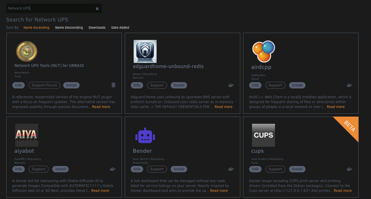

On 10/1/2023 at 3:51 PM, Rysz said:
Please install Network UPS Tools (NUT) for UNRAID by Rysz from Community Applications. The older plugins (including the one in the first post of this topic) are deprecated/now unsupported.
For the life of me, I cant find  Network UPS Tools (NUT) for UNRAID from you. The one I can only see is by dessertwitch? How do I get this?
Mine is the "desertwitch" one, seems the display was recently changed to the GitHub repository name. Thanks, I'll update it in the post so it's less confusing.
