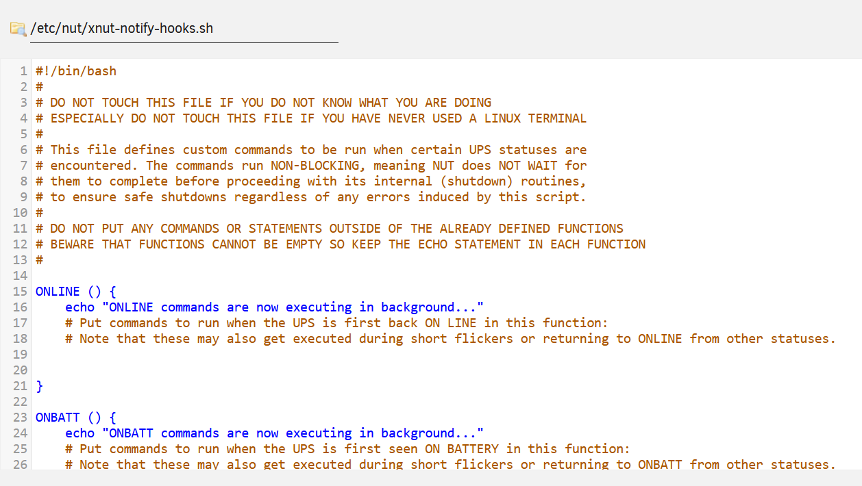

You can use the event hooks script with the NUT Configuration Editor in GUI:

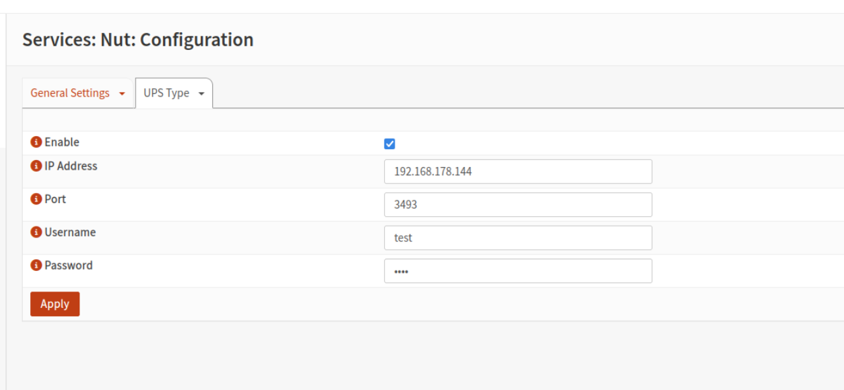

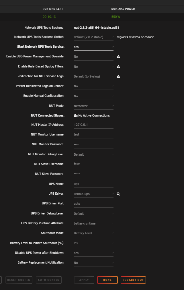

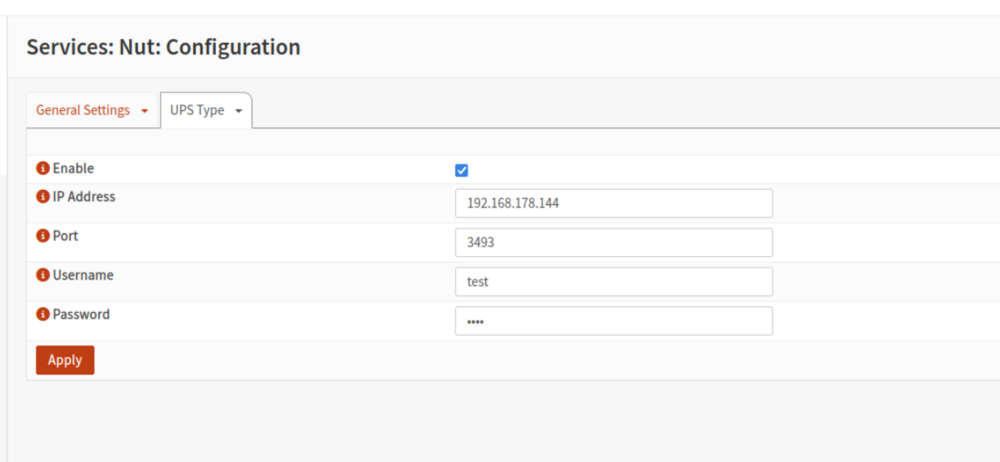

Someone know why I cant connect to the NUT-Server via OPNsense?
Edited by PlanetDyna
your username should be felix, its the NUT Slave Username.
Thank you. But also this isnt working. :(
in unraid nut settings rest your config set it to server and only change the password. and in opnsense set nut to client in both tabs and point it to unraid IP

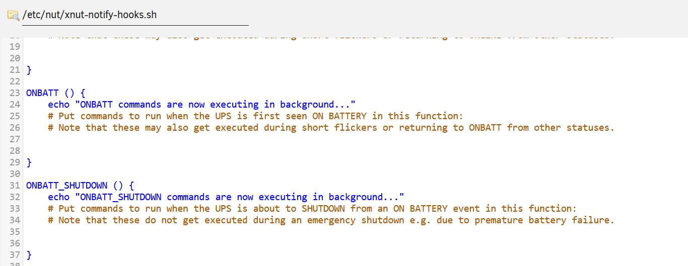

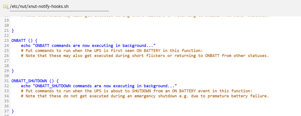

I would, however, need some advice. I need that when the plugin shutdowns the server, an mqtt command to be executed before. The solution I found so far was to copy the nut-notify script to /boot/config, modify it as I want, and every time the server is restarted, it is copied back to the /usr/sbin/ folder. Is there a more elegant solution to this problem?
Thanks!
Edited by va1entin
5 minutes ago, va1entin said:
Of course you are right. I made a ridiculous mistake, the plugin works perfectly. Thanks!
Thanks!
Yes, you can use this script in the NUT Configuration Editor in GUI:
Put the commands you need inside the respective functions, in your case ONBATT_SHUTDOWN.
Make sure to edit the script from within the GUI so that the changes are also saved after a reboot.
I'm using the NUT Master Username and password and works fine for me.
When heading to Diagnostics, it took a few seconds to show up. Also check your Unraid syslog too, it tells you if theres a successful authentication
Followed: https://docs.opnsense.org/manual/how-tos/nut.html

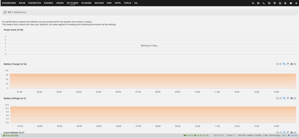

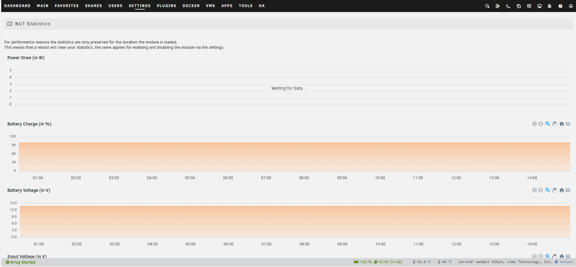

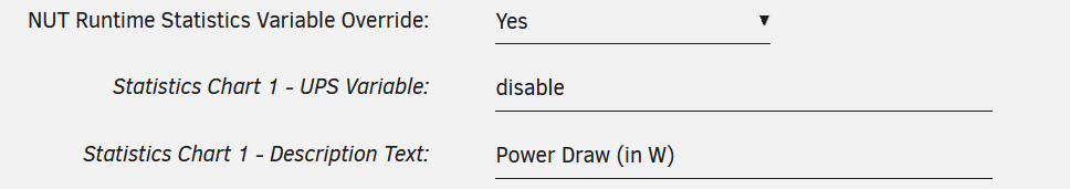

Hi and thanks again for this plugin and the support you provide for it.
I have one more question. Is there anything I can do to get the Power Draw graph to be displayed? The power consumption is displayed correctly in the status bar and in the settings, but the history graph cannot be displayed no matter what I do. Is it possible?
Thanks!
Thanks!
It's possible your UPS does not report this value and it's calculated in the dashboards from other variables.
In this case it's not possible to show this in a graph as only actually reported variables can be shown in graphs.
You can hide the non-functioning graph though or change it to another (reported) variable of interest:
