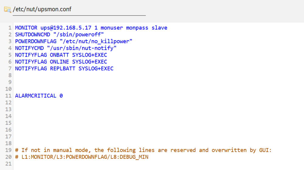

I noted that too, mine is online, so there's always the alarm of 'UPS is in Converter Mode', and when it looses connection (very frequently) it initiate shutdown, if I 'sudo systemctl restart nut-server' where NUT server is running, my unraid will go down as well.
Apr 12 14:00:15 Tower upsmon[66261]: Communications with UPS [email protected] lost
Apr 12 14:00:15 Tower upsmon[66261]: UPS [[email protected]] was last known to be in an ALARM state and currently is not communicating, assuming dead.
Apr 12 14:00:15 Tower upsmon[66261]: Executing automatic power-fail shutdown
Because the UPS was in an alarm state + not communicating, and the default NUT behavior (ALARMCRITICAL) is enabled, the system initiated a shutdown to prevent possible data loss.
I tried adding ALARMCRITICAL 0 on upsmon.conf but didn't seem to do anything (after restarting nut-server).

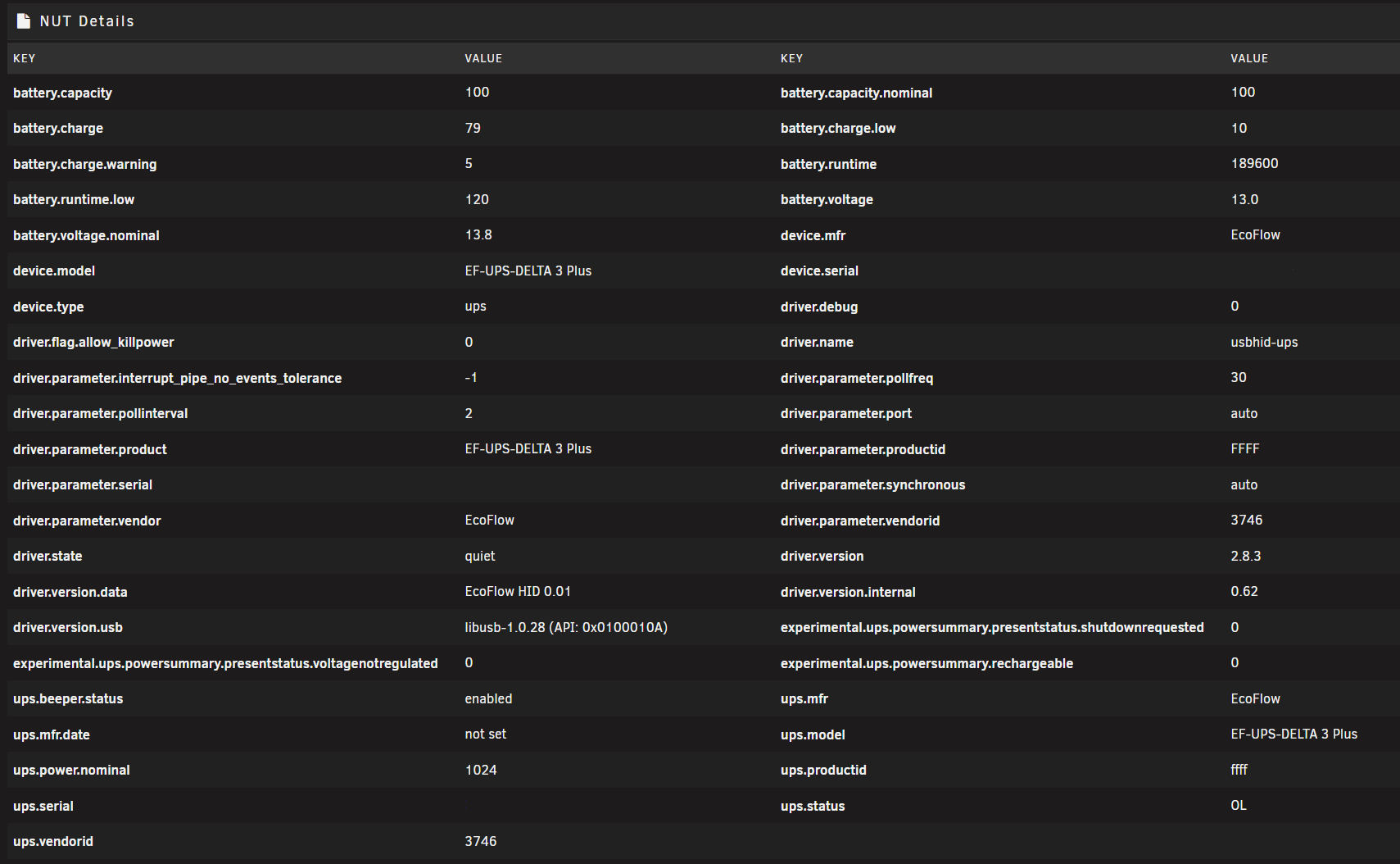

Good tip on the USB-C to USB-A cable. I have been trying to get NUT to work with the EcoFlow Delta 3 Plus without success with a USB-C to USB-C cable.
I got it to work with USB-C on the HID port on the EcoFlow and USB-A on the unRAID end.
  • nut-2.8.3-x86_64-1stable.ssl31
  • EcoFlow Delta 3 Plus with firmware V7.73.83.1
No UPS load metrics like I had with the Cyberpower though.
Glad it works for you now. It seems the driver is still in its early stages and possibly that's why these values are still missing. In any case, UPS load is not a metric that is crucial for NUT, and all the really important metrics are there to safely shutdown your system in case of a power outage. The rest of the metrics are mostly for "eye-candy" in the dashboards.
Did you put "ALARMCRITICAL 0" on line 9 or later in upsmon.conf?
The lines before that are overwritten by GUI settings (even if seeming empty).
Then you need to "Save" and "Restart NUT" for the setting to become effective.
The logs imply that the setting is not in effect there, so please double check that. 🙂

Not sure if I am doing something wrong but I am trying to connect NUT v2 on netserver to a Windows 11 machine with WinNUT-Client (which hasn't been updated in 2 years)
I have reset the settings on NUT, changed passwords and usernames but I have had zero luck getting it connected. I am always struck with the message " Connection to Nut Host IP ADDRESS Failed: No connection could be made because the target machine actively refused it"
Now is this an issue with something I set up in NUT or is an issue with the client. And is there potentially an easier or newer version of a windows client that works with NUT?
