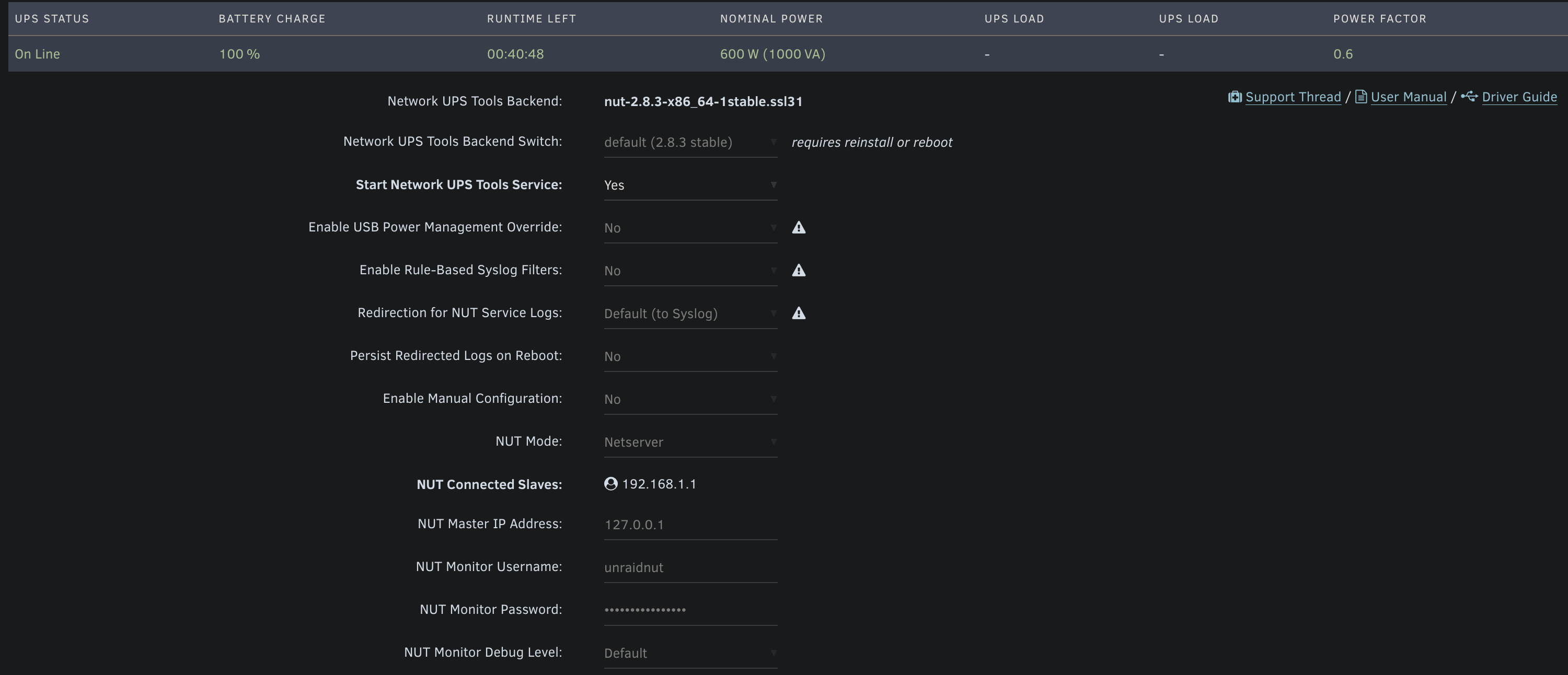

I've got another problem at the moment where one of my slave devices isn't showing up on the NUT settings page. I have two slave devices, OPNsense router and Home Assistant, the latter running on a VM within my unraid server but on its own IP address. The OPNsense IP address shows up as a connected slave but the home assistant doesn't, despite the integration in HA apparently working (it shows the correct model and details for my UPS). Can this be ignored or does it mean the slave device isn't correctly connected? Happy to provide diagnostics from HA end or unraid if necessary. TIA
I've included a screenshot to show the connected slave device field on the config page. You're probably right that it isn't important, I think it's caused by the fact that the HA VM is running on the unraid server itself
As far as I remember the HA integration does not actually log into the NUT server and just passively polls the data. It doesn't make a big difference for Unraid, the login functionality is mostly for more complex setups where the NUT server has to coordinate shutdown with the clients before battery runs out. For typical Unraid setups you shutdown well before battery is near running out, and as long as the HA integration sees the "FSD" flag from the NUT server it should be fine.

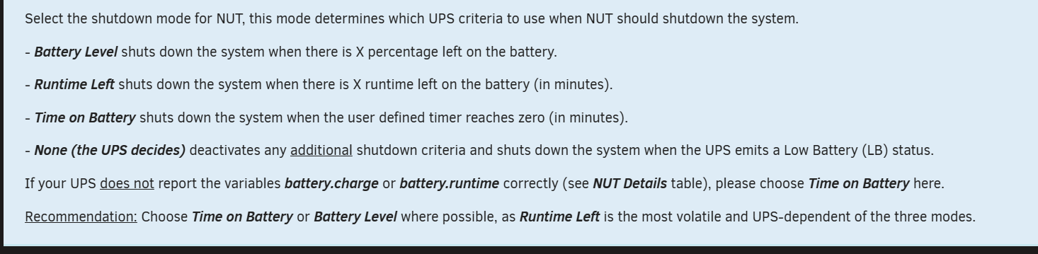

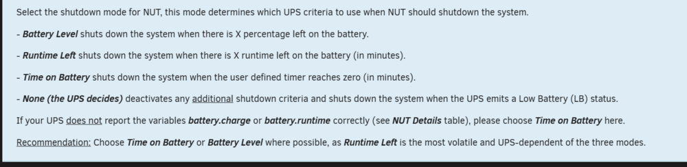

@Rysz should be maybe : `Battery Level - shuts down the system when there is X percentage left on the battery.`

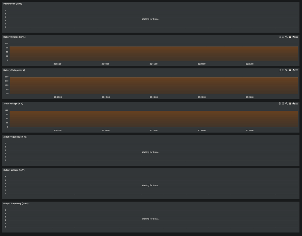

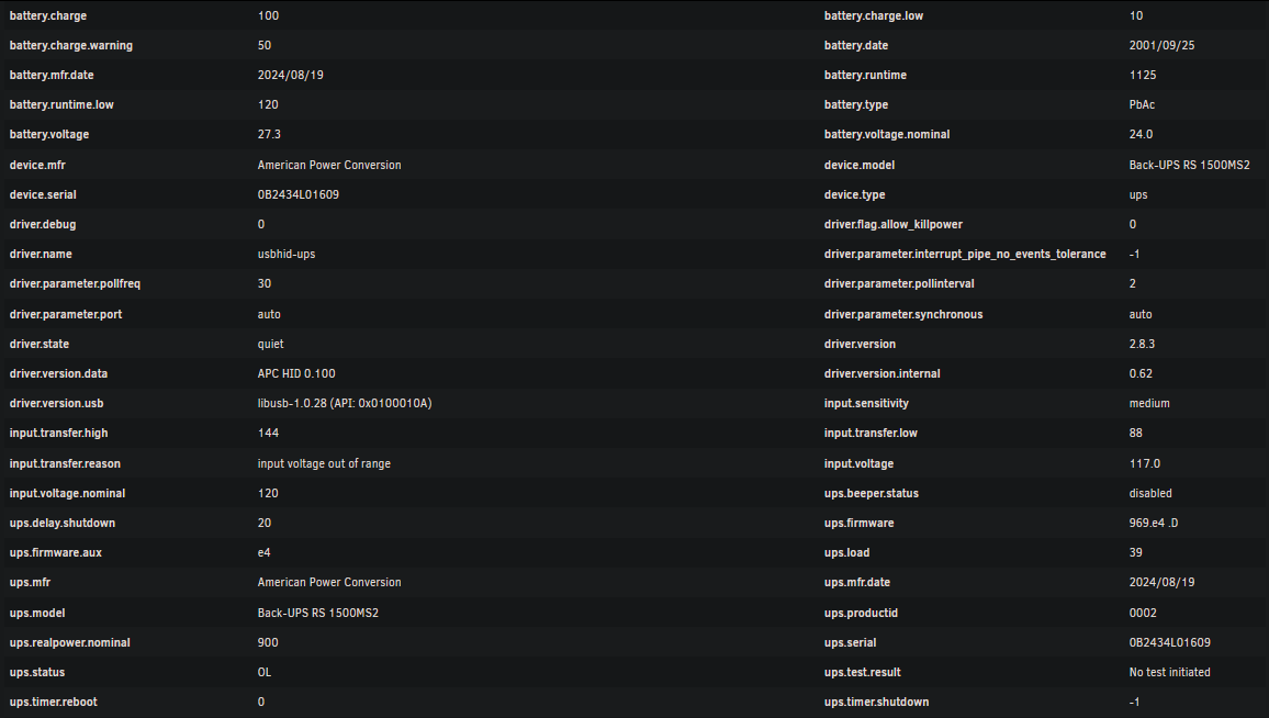

UPS question regarding stats and event history:
So I had the APC ups where I was able to track the electrical cost and the power failure events quite precisely, but I seem unable to do that directly with NUT?
In the NUT Statistics page, the details are not all that I could get with the Cyberpower app or APC's web UI. The curves for the power draw, the input/output voltage and frequencies are missing as well.
I have a APC Back-UPS pro 1500s which should be pretty standard.
Not only that but I don't see any section keeping track of events outside of Unraid notifications and it seems like NUT is unable to keep track of micro power losses whereas the original software could and would register it in the events. Unraid only picks up on if it lasts more than a certain amount of seconds it seems.
I live in a place where small outages are very frequent so for me it would be a big plus if someone had a clue maybe a plugin or some container that could compensate for that?
Thanks for letting me know.
Here I can see some information but not all is there and the some curves are not working even if the info is available:

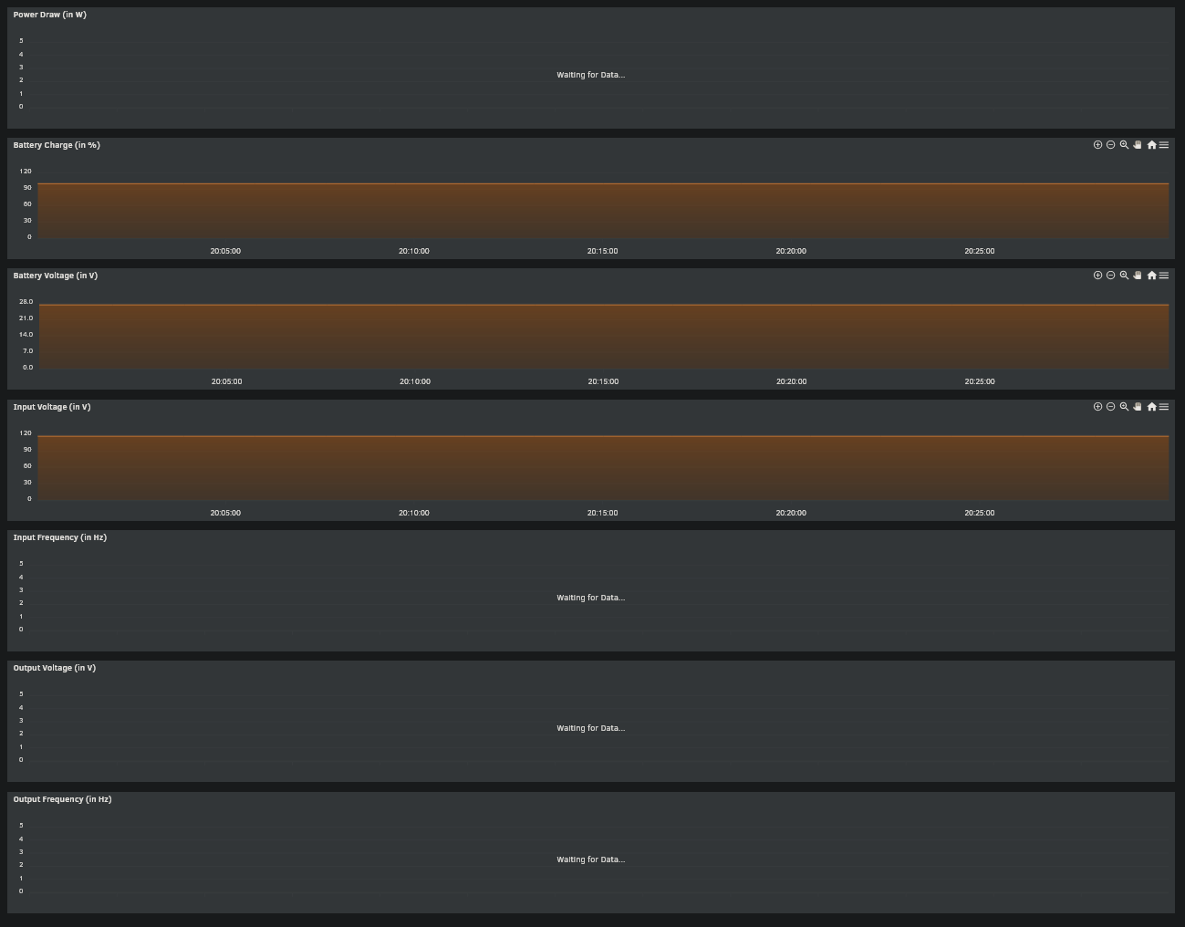

I'm having the same problem. I can see that the Power Draw is being read from the Cyberpower UPS as the Watts are show in the NUT footer, but the chart only reports "Waiting for Data...". Does anyone know how to get the Power Draw chart to update based on the draw reported from the UPS?
You can use the overrides to define custom variables you want to monitor, any existing numeric variables should be possible:
I think my problem is that ups.realpower is not provided via the UPS driver. My confusion is, if this isn't present in the driver, how is it showing up in the NUT Footer? Is that number calculated? If so, is it possible to do the same calculation in the statistics overrides?

battery.status: 100%
battery.type: PbAcid
battery.voltage: 13.8
battery.voltage.nominal: 12
device.mfr: CPS
device.model: ST Series
device.type: ups
driver.debug: 0
driver.flag.allow_killpower: 0
driver.name: usbhid-ups
driver.parameter.interrupt_pipe_no_events_tolerance: -1
driver.parameter.pollfreq: 12
driver.parameter.pollinterval: 2
driver.parameter.port: auto
driver.parameter.synchronous: auto
driver.state: quiet
driver.version: 2.8.3
driver.version.data: CyberPower HID 0.83
driver.version.internal: 0.62
driver.version.usb: libusb-1.0.28 (API: 0x0100010A)
input.transfer.high: 140
input.transfer.low: 96
input.voltage: 122.0
input.voltage.nominal: 0
output.voltage: 122.0
ups.beeper.status: enabled
ups.delay.shutdown: 60
ups.delay.start: 120
ups.firmware: BF02105B2
ups.load: 20
ups.mfr: CPS
ups.model: ST Series
ups.productid: 0501
ups.realpower.nominal: 375
ups.status: OL
ups.test.result: Done and passed
ups.timer.shutdown: -60
ups.timer.start: -60
ups.vendorid: 0764
