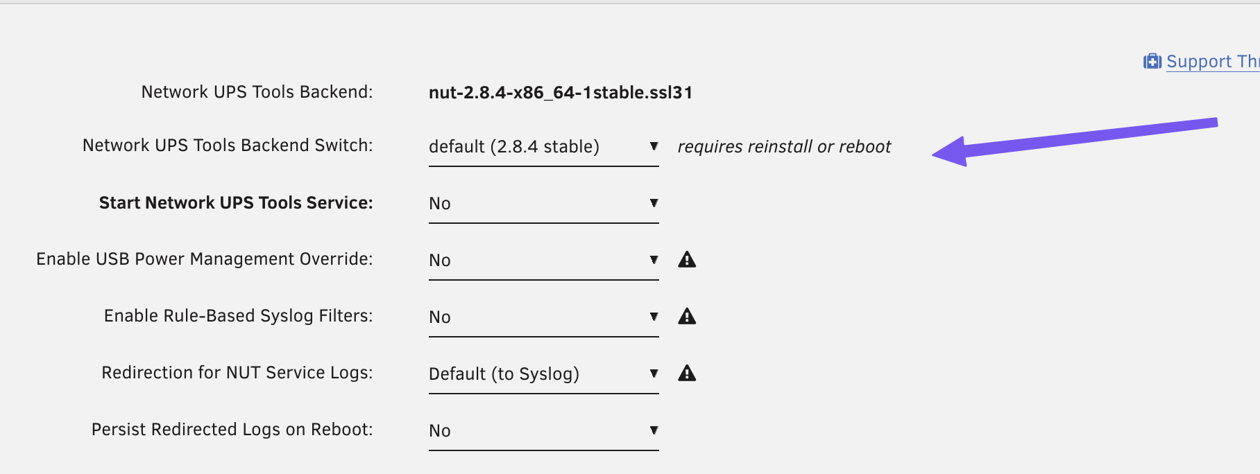

ah okay i have changed to preview build, but the changes in ups.conf aren't saved. I'll wait a night and see if the alerts continue.
You need to put the changes on line 8 or later, they will persist if you follow the guide to the point.
Also you need to use the NUT Configuration Editor in NUT Settings (Web GUI) otherwise it won't work.

I installed Network UPS Tools (NUT) by desertwitch from Community Applications and rebooted my server.
Now it won't boot up. Do I just disable the plugin on the usb stick?

You can just delete the respective .plg file in /boot/config/plugins. It would be interesting to know what problem you're having exactly and where it gets stuck though, as this problem has never occured to any other users before.

I'm not sure what you did, but the plugin doesn't tell you to reboot. Try to boot into safe mode, which will disable all plugins. If that doesn't work - it's not a plugin related issue. If that works - uninstall any plugins one by one to see which one causes the issue.

It definitely said, that the change will take place once I reboot. It was like the 2nd or 3rd field on the plugins page.
I got the machine to boot. Not sure what happened but when I rebooted the computer my USB was not first in the boot order....odd.
Will try NUT again! Thanks!

Ah, I see what you mean now. A reinstall or reboot is only required if you change the NUT backend using that setting where it says that. I'm glad that you got it working again, regardless.
