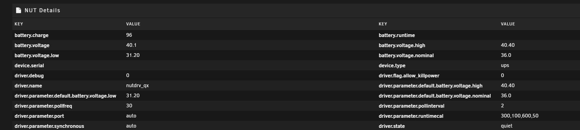

@SimonF If you are still on the default (2.8.4) backend can you try this fixed up driver?
Stop NUT, then put this file into /usr/libexec/nut (backup old one/overwrite) and chmod +x /usr/libexec/nut/nutdrv_qx.
Then start NUT again and please see if the problem still occurs or if it works now... let me know, thank you. 😀
nutdrv_qx

I'm very sorry, I forgot you're on the older OS version - this one should work.
nutdrv_qx
nutdrv_qx
Yes runtime is now being calculated with the patched driver.
Thanks a lot for testing, I'll get the changes upstreamed so this will be fixed for future NUT versions. In the meantime you can use the older backend where this still worked or patch the file I gave you in manually.
Thanks for the help. This server rarely gets rebooted so will leave patched driver for now.
If you have time and could check one more thing, just to be 100% sure:
When you disable runtimecal (just comment out with #) can you confirm that battery.runtime is no longer in variable table?
Yes if I comment out the line runtime does not show in the output.
The fix for your driver is now included in the "preview" backend that's part of today's update.

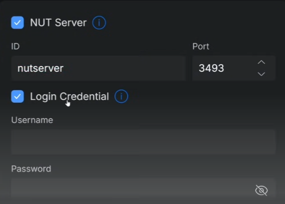

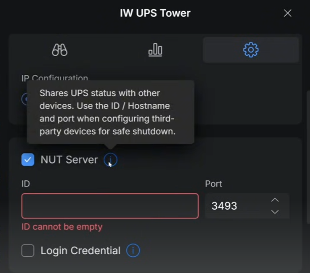

Just wanted to let you know that I was able to get the Unfi Tower UPS NUT server working with this plugin.
1) The Unifi interface is confusing.
2) I had to do manual setup of the upsmon.conf file.
MONITOR "Unifi_Id"@[Tower_IP_Addess]:[Tower_Port] 1 user userpass slave
Example
MONITOR [email protected]:3493 1 nutuser nutpass slave
Additionally I had to uncheck the box labeled "login credential" in Unifi because even though it says non UI devices will need to log in with a credential, it seems like unchecking the box make it not require a password at all. Additionally I wasn't able to get it to accept my user / password even if I checked the box and set it in this plugin and the unfi the same, probly because of an issue with the upsd.users file on the tower. (Was not able to trouble shoot this further.) So the user ans userpass part of the monitor line might not be required... not sure.
Anyway doing the manual setup + unchecking the box allowed me to get a connection with the remote Unifi Tower UPS established.
Also I'm new to this plugin so I'm not sure how to configure the NUT plugin to shutdown the server when the UPS Tower signals a power loss or whatever... but hey step one solved right?
Edited by gundamguy

I have all the cables correctly plugged in, but none of the drivers work for it. I have tried them all, but NUT does not see the UPS and fails to start the service. I contacted Ugreen for drivers, but they said they don't support Unraid, and just gave me drivers for their UGOS. I have no clue how to even use these drivers. Will there be an update for in this plugin for this new UPS? or any help in how I can get the software to see this driver?
Appreciate it if developers could respond. Will this hardware be included in an upcoming version update of NUT?
Also, is there any way I can assist with troubleshooting?
Please post the NUT debug package which can be found in "NUT Settings", so I can take a look.
