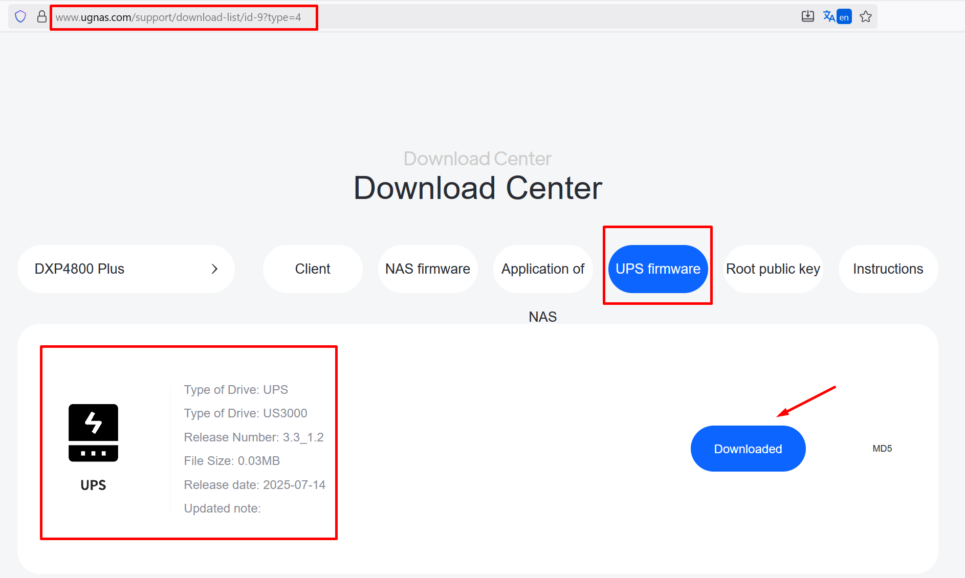

No problem, UGreen directed me to their website and to the driver download (see attached png screenshot)
I've also attached the actual driver bin file that you get from the download.

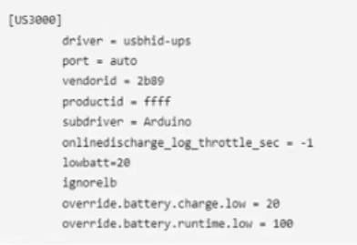

I'm confident we can get this to work with NUT as it reports as:
Bus 003 Device 002: ID 2b89:ffff UGREEN US3000
And this type of UPS is reported to work with NUT after some tweaking of settings:
https://github.com/networkupstools/nut/issues/2987
First stop NUT, then set this setting:
Then apply the setting and on the same page go to the NUT Configuration Editor.
Put into UPS.CONF the following settings:
Save the settings and then change this setting as follows:
Then apply the setting and start NUT again, report back if it works.
If it doesn't work, produce another debug package and post it again here.

Please add to UPS.CONF: debug_min = 6 and try starting again, then post the debug package again.
Yes!!!
It didn't crash this time, and I am getting info from the device now.
Please find attached nut debug package.
Thank you so much, I didn't think I'd ever get it working!!
nut-debug-20251019164515.zip

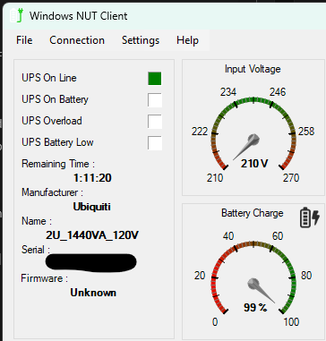

I can also confirm that via WinNUT the UPS is reading out correctly with the same configurations:

Nothing unusual sticks out, but it says access denied and looks like a credentials issue.
Although that is weird, because even with wrong credentials it should show information (just not register as "slave"/secondary).
It does look like they perhaps baked in some stricter authentication on their own; other UniFi UPS users do report:
Still no dice connecting to the NUT server while using authentication. Unauthenticated seems OK, just when setting a username/password the NUT server is returning a mix of "ERR ACCESS-DENIED" and "ECONNRESET" when attempting to connect from any 3rd-party NUT client.
https://community.ui.com/releases/UniFi-UPS-1-4-13/fdd23b70-1191-4bc1-8485-d85c41a3a510
Maybe this is even some kind of "fake" NUT server (just speaking NUT protocol) that just isn't fully bug-free yet (just a guess).
In any case, I'd also try maybe using credentials that don't have any special characters, that could be a factor also... not sure...
1 minute ago, Rysz said:
Also I'd try maybe using credentials that don't have any special characters, that could be a factor also.
Haha at one point, I had user: nut, password: nut. Thanks for the look, surprised to see auth issues in the zip. According to the logs, it's connecting: Trying to connect to UPS [[email protected]] and Logged into UPS [email protected]

Can you try running in command line:
upsc [email protected]
upsc [email protected] ups.status
I'm having issues with my UniFi UPS as well. I ran that command and I couldn't get it to connect unless I added the port I used as a socket at the end of the IP, so I'd have to do something like upsc [email protected]:123 otherwise I got a connection refused. It only works if I have the credentials disabled.
Is there a way in the manual config to point to a hostname or at least add the socket on the end of the IP?
