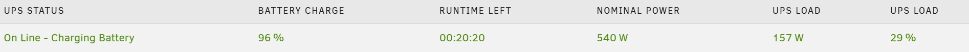

Yeah I saw those...I thought maybe they were related to 7.2 RC2....I'm not technical enough to troubleshoot them. I guess I will have to wait until the final 7.2 comes out in the next few days/couple weeks & then see if those errors are still there....I don't have many apps installed (just "myspeed") as this old computer is filled with my old drives & used entirely as a backup NAS (xfs array) for my Windows Plex Server.
As far as data transfer loss, I guess in theory it's not much of an issue as the computer that would be transferring data to & from it would shutdown first (by it's UPS) in the event of a power outage canceling any transfers.....But even an idle computer still shouldn't be unceremoniously cut off from electricity....
ANYWAY, Thanks for looking at my problem for me )

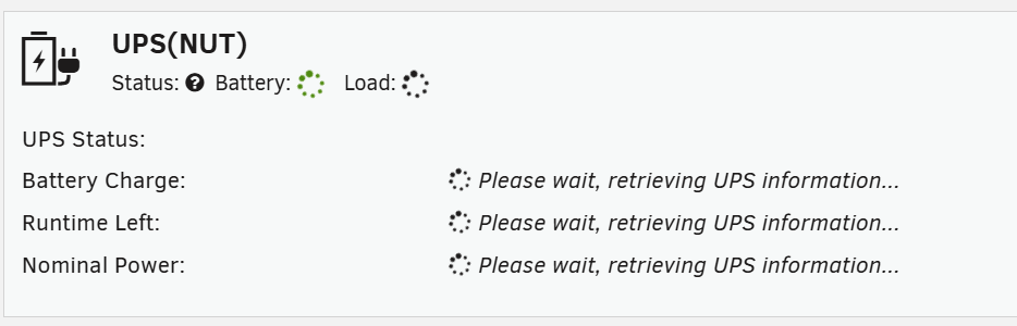

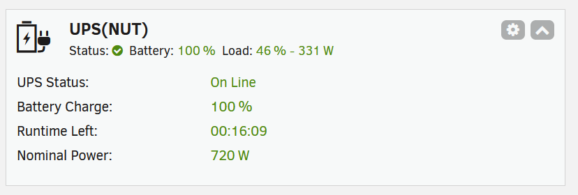

I have an RPi running docker containers of NUT (upshift/nut-upsd:2.8.0) for each UPS I have in my UPS farm. Each UPS is exposed to an individual port for clients to hook on to and monitor - e.g. NAS, HA, etc.
However, I just can't seem to connect my UnRAID NAS (7.1.4) with the 2025.09.07 plugin to any of the NUT instances. my other non UnRAID clients are working and can see battery charge, voltage, etc..

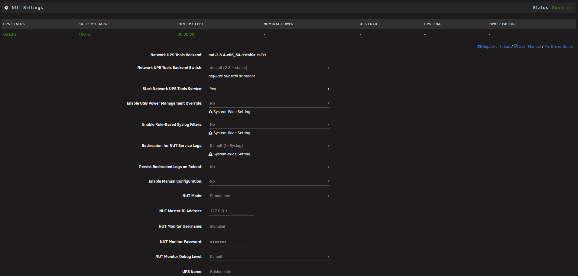

My NUT Settings
I get an error when trying to create the NUT debug package :(
ERROR: The NUT Debug Package Generation Script has failed - no response from the bash backend.
Network UPS Tools Backend: nut-2.8.4-x86_64-1stable.ssl31
Network UPS Tools Backend Switch: default (2.8.4 stable)
Start Network UPS Tools Service: Yes
Enable USB Power Management Override: No
Enable Rule-Based Syslog Filters: No
Redirection for NUT Service Logs: Default (to Syslog)
Persist Redirected Logs on Reboot: No
Enable Manual Configuration: Yes
UPS Name: nutups
And the only CONF file I've changed is upsmon.conf to
MONITOR [email protected]:34493 1 demonrik nutserver slave
SHUTDOWNCMD "/sbin/poweroff"
POWERDOWNFLAG "/etc/nut/no_killpower"
NOTIFYCMD "/usr/sbin/nut-notify"
NOTIFYFLAG ONBATT SYSLOG+EXEC
NOTIFYFLAG ONLINE SYSLOG+EXEC
NOTIFYFLAG REPLBATT SYSLOG+EXEC
With no DEBUG_MIN in the upsmon.conf it looks like it has trouble accessing.

i.e. it clearly sees on this UPS (an APC BGM2200B-GR) it's OL and DISCHARGing.
But no update of any details anywhere on UnRAID
I do see the upsnotify failure and also have that backend issue creating the debug package and wonder if it's some permission setting somewhere gone wrong.
I have tried removing and reinstalling the plugin several times on 2 different UnRAID NASes with identical results and am not even sure where to look next.
Any help on getting this working greatly appreciated.

My NUT Settings

23 hours ago, Rysz said:
On another look... is your UPS name wrong? You're monitoring "nut-srvr", but your UPS name is "nutups"?
If you're monitoring "nut-srvr", the UPS name must also be "nut-srvr" - otherwise the GUI won't show the values.
I had it the same first - then changed it to something else just in case.
Changed it back and no success in updating the GUI
On 10/27/2025 at 5:15 PM, Rysz said:
Please try to spin up all your array disks and try the debug package generation again.
By any chance, is the UPS server you're trying to connect to running on a UniFi UPS?
I'm not sure about your exact setup though, what happens when you run in command-line:
upsc [email protected]:34493
I spun up the disks and get a new details
cp: cannot create regular file '/tmp/nut-debug/unraid-version.txt': No such file or directory
cp: cannot create regular file '/tmp/nut-debug/PLUGIN/nut-dw.plg.txt': No such file or directory
And no - is not a UniFi - is an APC UPS
Running the command line looks good
# upsc [email protected]:34493
battery.charge: 100

Thanks for the information, I think I traced this issue to a specific GUI settings problem.
I'll add a custom "Port" setting, as part of the next update to NUT, which should resolve the issue.
The problem is that the GUI assumes the default NUT port at the moment, which the user should be able to change.

Not sure if this has already been reported or not. Upgraded to 7.2 today. NUT seems to work fine
but the dashboard tile never loads. It's been like that for about 4 hours now. I have disabled it and re-enabled it without much luck.
It works for me:
Please check in your browser console and the PHP Settings (Tools => PHP Settings => View Log) if there's any issues.
19 minutes ago, Rysz said:
It works for me:
OK, looking at those logs I worked out what it is.
Connect to Unraid Web UI with HTTPS and all is good. When I connect with HTTP I get the Please wait message. When I'm at home I normally hit http://servername to reach the Web UI. The Dashboard tile seem to hardcode https://url when trying to pull data rather than use what, which fails when someone is accessing without a cert.
From my console I see the gpustat has the same issue.
The plugin uses relative paths, and I'm also accessing over HTTP (as I'm sure many others do), so I think this is maybe your browser enforcing SSL on these (sub-)requests?
Dunno then. All I can tell you is that on 7.1.4 (I think) it worked. After the upgrade to 7.2 it didn't.
The console errors show its trying to pull data https://servername and it fails. I edit the command in dev mode to http://servernane and it works. When I go via caddy reverse proxy to the https URL, it works.
Thats about the extent of my technical knowledge.
We'll have to see if more reports surface with users updating to 7.2.
NUT code paths haven't changed and are all relative, so no assumptions about protocol/port are made.
What's more is, it works for me on 7.2. over HTTP also... so perhaps something on your end (browser, proxy...)?
I'm working on a client side mitigation of the UniFi protocol problems, hopefully I'll have good news with the next update to get these UPS functional for you all.
