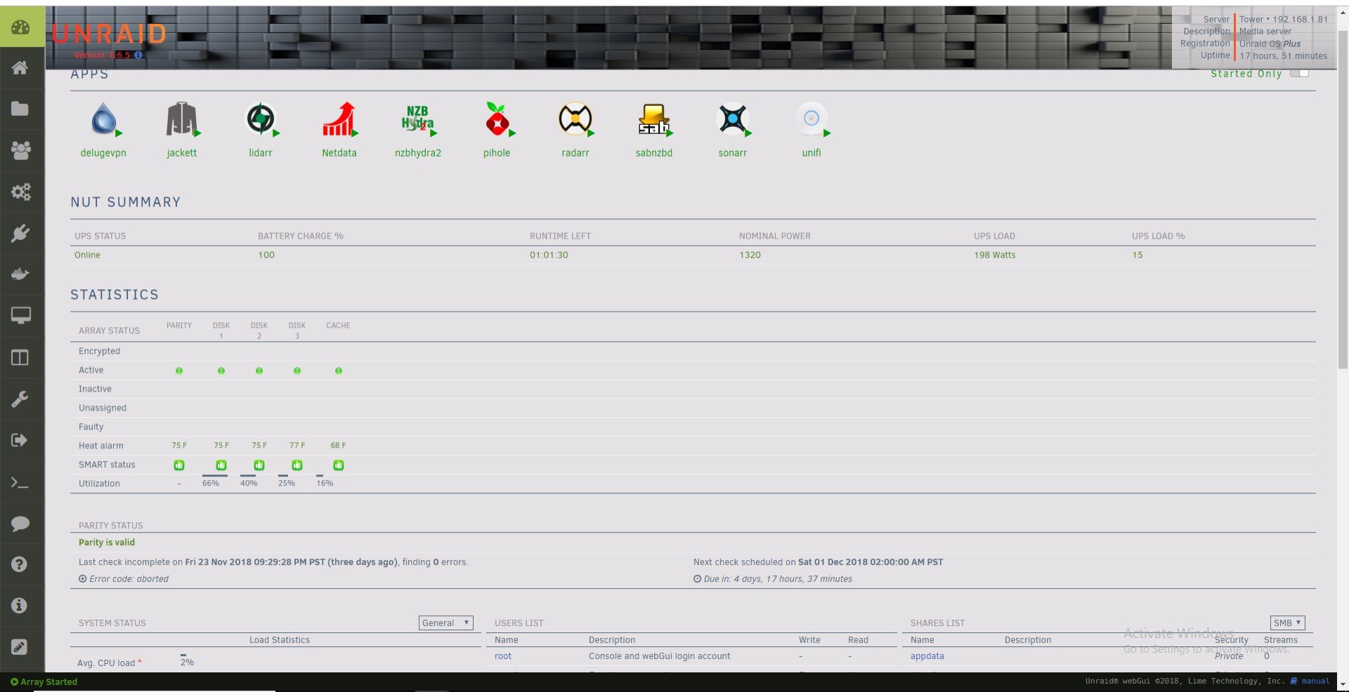

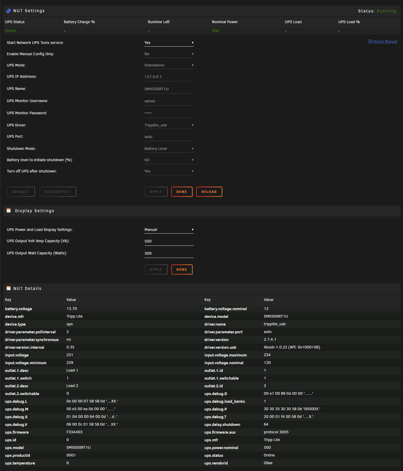

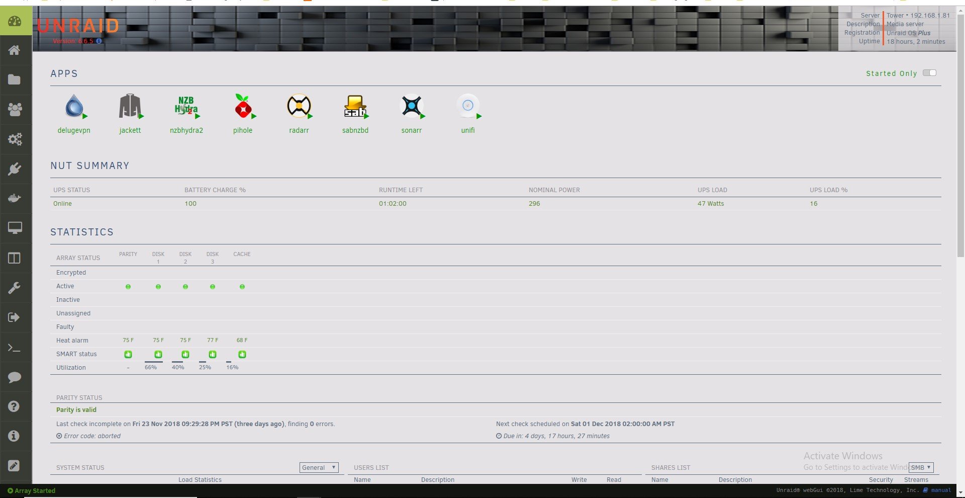

Stupid question time, Is there any difference in functionality when using auto vs. manual?  In auto mode the NOMINAL POWER and UPS LOAD values are way off from what is reported by the UPS itself.  If I use manual mode everything appears to align with what the UPS reports on it's screen except NOMINAL POWER is always reported as the value I entered in the box.  RUN TIME and UPS LOAD% are accurate regardless of which one I choose.  I'm just wondering if I lose anything by using one over the other?
Screenshots below to show what I mean. First one is when in AUTO mode, Second is in MANUAL.

29 minutes ago, dmacias said:
What are the variable on the NUT details page in settings? What UPS?
The UPS i'm using is a Cyberpower OR2200PFCRT2Ua.  When in manual mode, I just enter the ratings that the manufacturer gives, which are:
UPS Output Volt Amp Capacity (VA):2200
UPS Output Watt Capacity (Watts):1320
I notice in the NUT settings the variable ups.realpower.nominal always equals 296 and I think that might be the issue with the differences being displayed..  In manual mode I assume the 1320 I'm entering is overwriting that 296 in it's calculations.  Where as in Auto mode its using that 296 and thats why the ups load in watts is way off in Auto.

Hello,
I am new to unRAID and its plugins and I am trying to setup one of the UPS to work with NUT v2 but I cannot get the charge % or any other data to show up. Am I doing something wrong?
Hello,
Try using the usbhid driver instead of the tripplite usb. Or run autodetect
Sadly usbhid driver detects nothing and service won't even start.
Did you try running autodetect? And what did it show?
1 minute ago, dmacias said:
Auto detect set up tripplite usb, I checked with laptop that windows based poweralert local works and shows all values correctly so I would assume the configuration file in nut is wrong for this?
Also don't know does it makes a difference but this is 230V model.
It's the tripplite driver. You're missing certain variables. I'll look at compiling nut again. There are fixes for protocol 3005 committed 6 months ago and the branch I used might not have included those.
