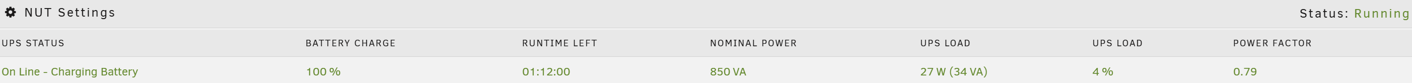

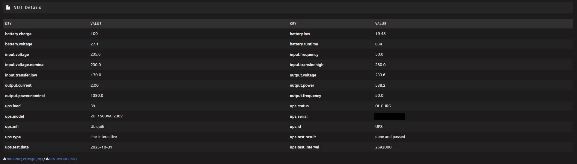

[Plugin] NUT v2 - Network UPS Tools
After updating everything was working fine with NUT plugin until I noticed this on the footer.
Before the upgrade to 7.2.0 the footer was exactly that but the NUT data was on the left, not on the right.
Is it possible to put it back where it was before the upgrade?
Regards from Portugal!
Unfortunately not, I also like it better on the left but plugin developers were asked to put it on the right (the other plugin you're having probably wasn't updated for the new OS version yet).

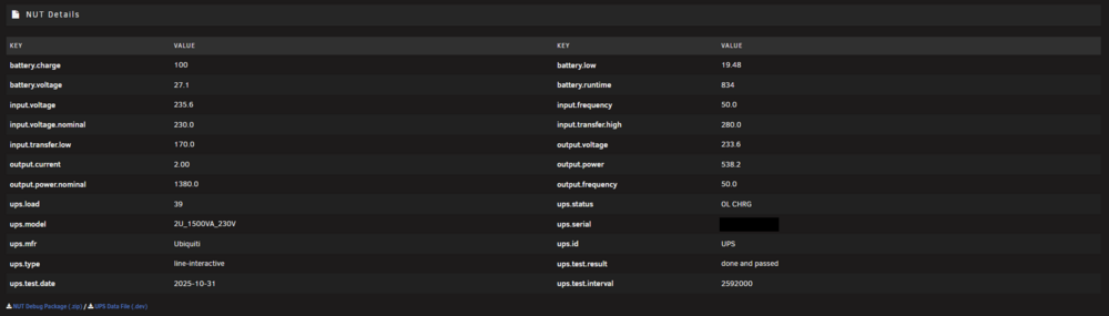

18 hours ago, enJOyIT said:
runs on the standard 3493 port
Maybe the plugin uses the wrong authentification mechanism?
The windows NUT tool runs fine and can connect.

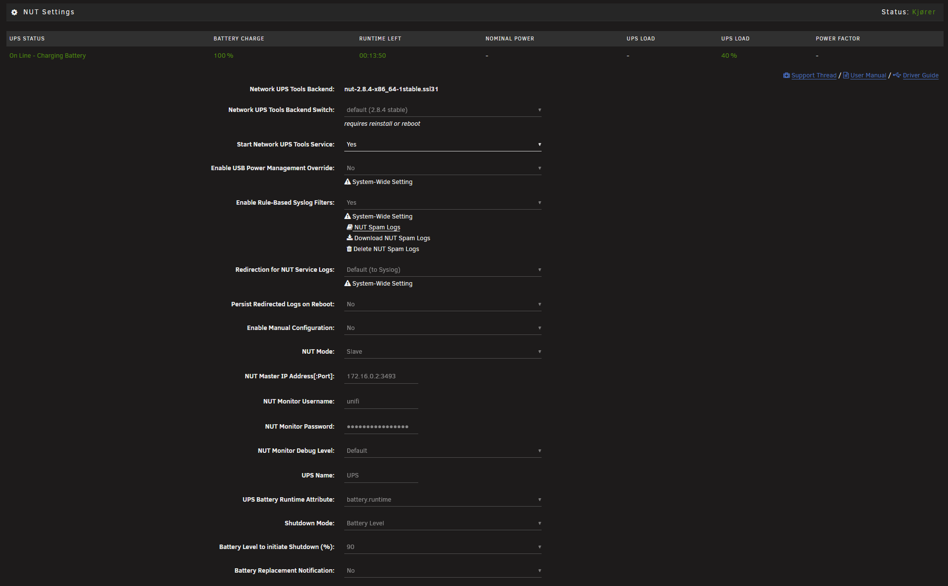

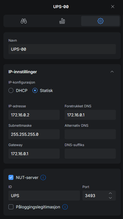

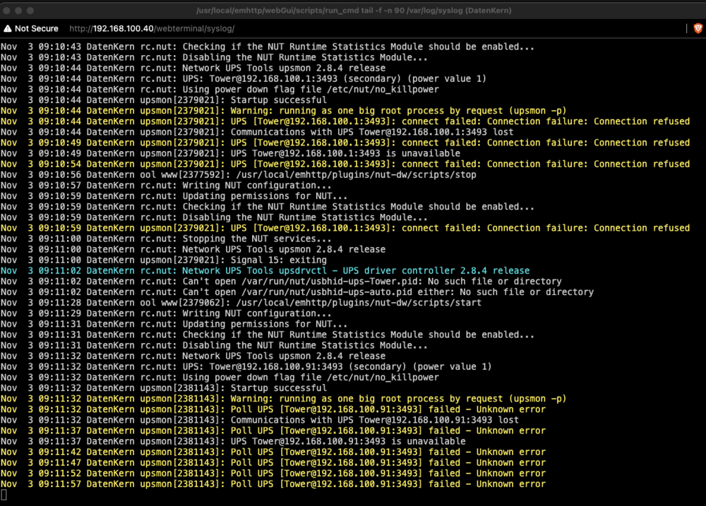

On 10/21/2025 at 2:12 PM, dam_j said:
Hey,
I´m trying to get the new Ubuiqiti Tower UPS connected.
Only configuration it has is enabling the internal NUT-Server and config a user which i have done.
In the NUT Plugin i configure it as slave and give the Ip, user, password.
After i start the plugin i don´t get any errors in the log but i also get no read from the ups.
I can ping the UPS just fine from the unraid server.
LOG says:
Oct 21 14:10:44 TEST rc.nut: Writing NUT configuration...
Oct 21 14:10:45 TEST rc.nut: Updating permissions for NUT...
Oct 21 14:10:45 TEST rc.nut: Checking if the NUT Runtime Statistics Module should be enabled...
Oct 21 14:10:45 TEST rc.nut: Disabling the NUT Runtime Statistics Module...
Oct 21 14:10:46 TEST rc.nut: Network UPS Tools upsmon 2.8.4 release
Oct 21 14:10:46 TEST rc.nut: UPS: [email protected] (secondary) (power value 1)
Oct 21 14:10:46 TEST rc.nut: Using power down flag file /etc/nut/no_killpower
Oct 21 14:10:46 TEST upsmon[608694]: Startup successful
Oct 21 14:10:46 TEST upsmon[608694]: Warning: running as one big root process by request (upsmon -p)
And thats it. Anything more that i can try?
Thanks in advance

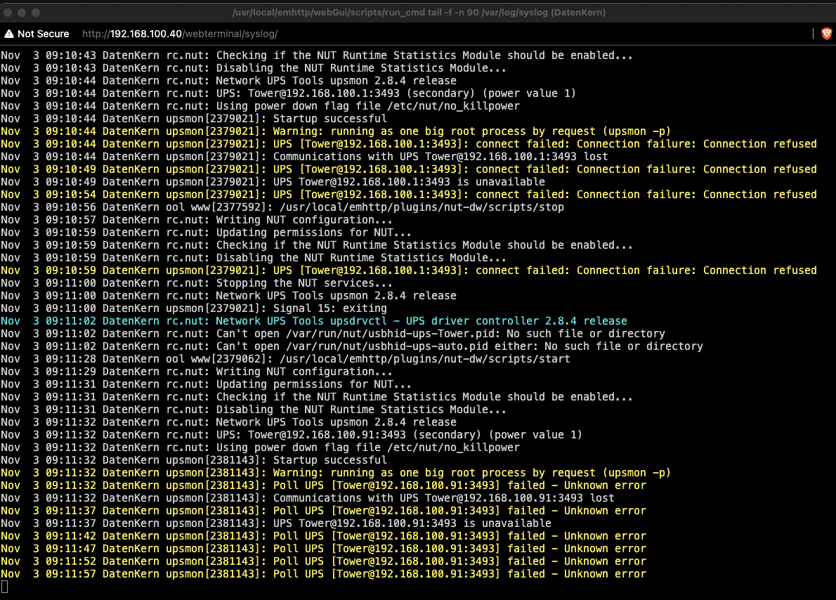

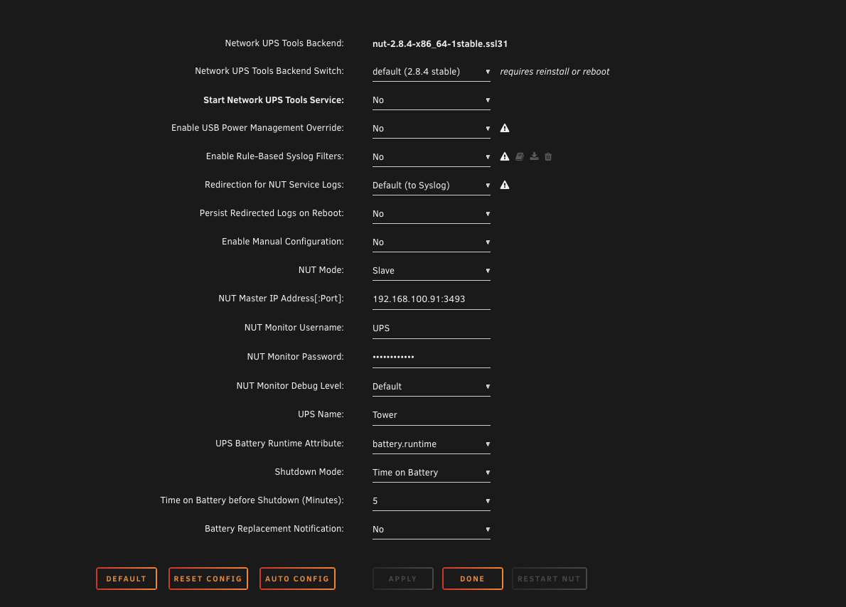

On 10/22/2025 at 10:26 PM, AngryHyena said:
I'm having issues with my UniFi UPS as well. I ran that command and I couldn't get it to connect unless I added the port I used as a socket at the end of the IP, so I'd have to do something like upsc [email protected]:123 otherwise I got a connection refused. It only works if I have the credentials disabled.
Is there a way in the manual config to point to a hostname or at least add the socket on the end of the IP?
I've added a UniFi workaround in the latest update, please try and report back if it works.
If using a custom port - the latest update allows adding the port to the IP address in GUI settings (if not the default of 3493).

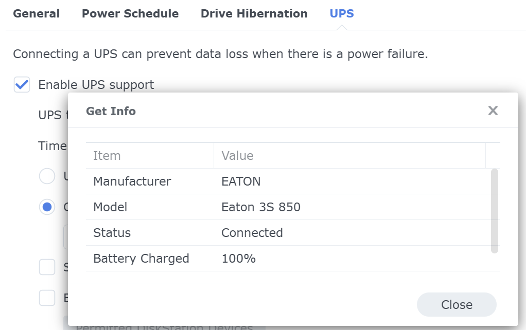

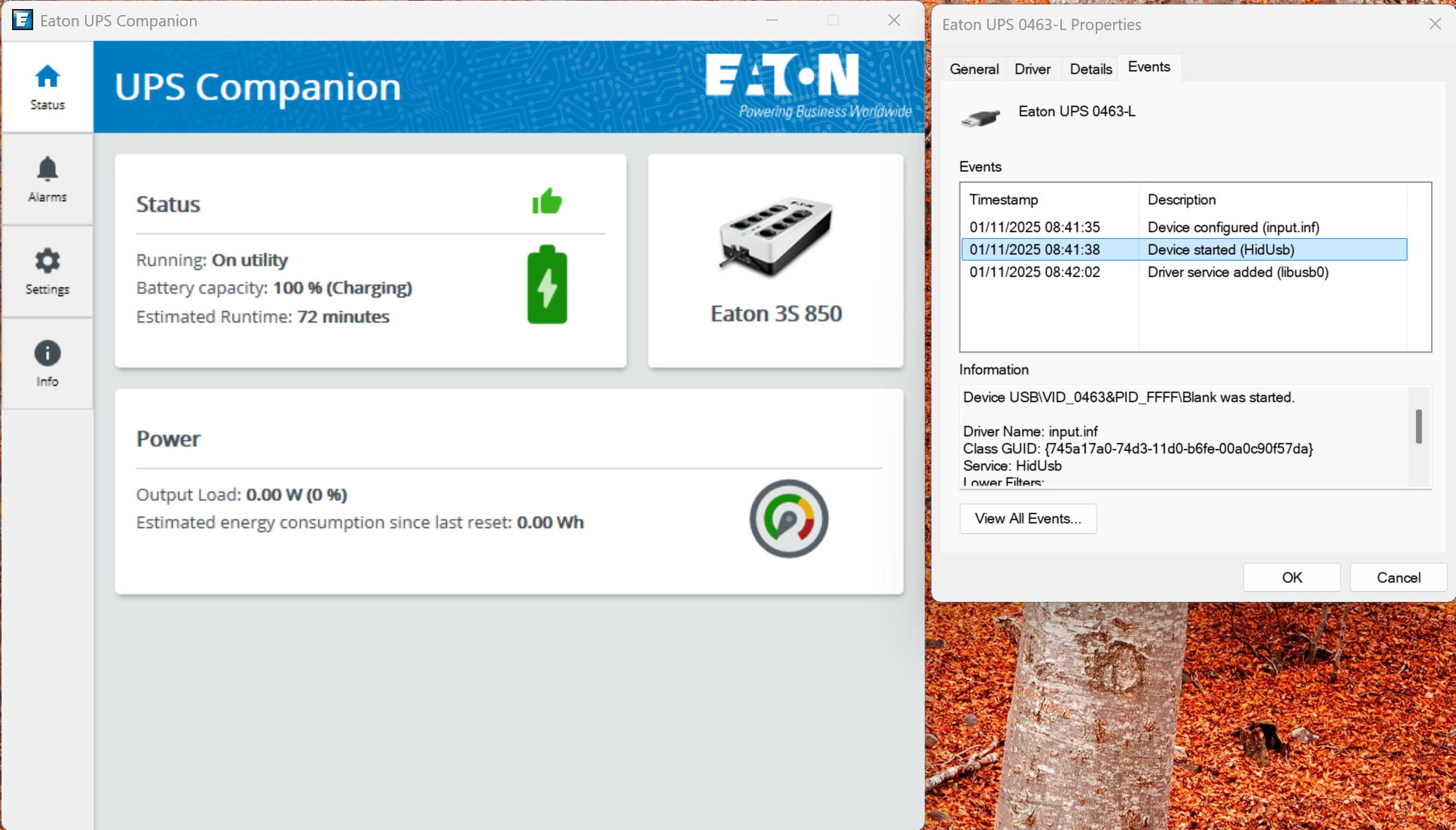

Recently purchased an Eaton 3S850B 3S Gen2 UPS, and have tried all drivers available in the NUT plugin config, but to no avail.
When trying to start the NUT server:
Nov 1 08:20:53 FWLONNAS01 rc.nut: Writing NUT configuration...
Nov 1 08:20:55 FWLONNAS01 rc.nut: Updating permissions for NUT...
Nov 1 08:20:55 FWLONNAS01 rc.nut: Checking if the NUT Runtime Statistics Module should be enabled...
Nov 1 08:20:55 FWLONNAS01 rc.nut: Disabling the NUT Runtime Statistics Module...
Nov 1 08:20:56 FWLONNAS01 rc.nut: Network UPS Tools upsdrvctl - UPS driver controller 2.8.4 release
Nov 1 08:20:56 FWLONNAS01 rc.nut: Network UPS Tools 2.8.4 release - Generic HID driver 0.67
Nov 1 08:20:56 FWLONNAS01 rc.nut: USB communication driver (libusb 1.0) 0.50
Nov 1 08:20:56 FWLONNAS01 rc.nut: No matching HID UPS found
Nov 1 08:20:56 FWLONNAS01 rc.nut: Driver failed to start (exit status=1)
Debug package is unable to be provided:
ERROR: The NUT Debug Package Generation Script has failed - no response from the bash backend.
Can you try raising the UPS Driver (not NUT Monitor!) Debug Level to 6 and post the syslog output?
Sure!
Nov 1 08:30:27 FWLONNAS01 rc.nut: 0.000000 [D1:1845439] debug level is '6'
Nov 1 08:30:27 FWLONNAS01 rc.nut: 0.000038 [D5:1845439] send_to_all: SETINFO driver.debug "6"
Nov 1 08:30:27 FWLONNAS01 rc.nut: 0.000046 [D5:1845439] send_to_all: SETFLAGS driver.debug RW NUMBER
Nov 1 08:30:27 FWLONNAS01 rc.nut: 0.001953 [D1:1845439] Succeeded to become_user(root): now UID=0 GID=0
Nov 1 08:30:27 FWLONNAS01 rc.nut: 0.001988 [D1:1845439] Signalling UPS [ups]: driver.exit (quietly, no fuss if no driver is running or responding)
Nov 1 08:30:27 FWLONNAS01 rc.nut: 0.002007 Can't open /var/run/nut/usbhid-ups-ups: No such file or directory
Nov 1 08:30:27 FWLONNAS01 rc.nut: 0.002011 [D1:1845439] Request for other driver to exit returned code -1
Nov 1 08:30:27 FWLONNAS01 rc.nut: 0.002026 [D1:1845439] Socket dialog with the other driver instance (may be absent) failed: No such file or directory
Nov 1 08:30:27 FWLONNAS01 rc.nut: 0.002039 [D1:1845439] PID file /var/run/nut/usbhid-ups-ups.pid not found; stat() returned -1: No such file or directory
Nov 1 08:30:27 FWLONNAS01 rc.nut: 0.002073 [D1:1845439] Saving PID 1845439 into /var/run/nut/usbhid-ups-ups.pid
Nov 1 08:30:27 FWLONNAS01 rc.nut: 0.002118 [D5:1845439] send_to_all: SETINFO device.type "ups"
Nov 1 08:30:27 FWLONNAS01 rc.nut: 0.002127 [D5:1845439] send_to_all: SETINFO driver.state "init.device"
Nov 1 08:30:27 FWLONNAS01 rc.nut: 0.002130 [D1:1845439] upsdrv_initups (non-SHUT)...
Nov 1 08:30:27 FWLONNAS01 rc.nut: 0.002134 [D2:1845439] Initializing an USB-connected UPS with library libusb-1.0.28 (API: 0x0100010A) (NUT subdriver name='USB communication driver (libusb 1.0)' ver='0.50')
Nov 1 08:30:27 FWLONNAS01 rc.nut: 0.003483 [D2:1845439] Checking device 1 of 3 (1D6B/0003)
Nov 1 08:30:27 FWLONNAS01 rc.nut: 0.024415 [D1:1845439] nut_libusb_open: invalid libusb bus number 0
Nov 1 08:30:27 FWLONNAS01 rc.nut: 0.024711 [D2:1845439] - VendorID: 1d6b
Nov 1 08:30:27 FWLONNAS01 rc.nut: 0.024721 [D2:1845439] - ProductID: 0003
Nov 1 08:30:27 FWLONNAS01 rc.nut: 0.024725 [D2:1845439] - Manufacturer: Linux 6.12.24-Unraid xhci-hcd
Nov 1 08:30:27 FWLONNAS01 rc.nut: 0.024729 [D2:1845439] - Product: xHCI Host Controller
Nov 1 08:30:27 FWLONNAS01 rc.nut: 0.024732 [D2:1845439] - Serial Number: 0000:00:14.0
Nov 1 08:30:27 FWLONNAS01 rc.nut: 0.024736 [D2:1845439] - Bus: 002
Nov 1 08:30:27 FWLONNAS01 rc.nut: 0.024739 [D2:1845439] - Bus Port: unknown
Nov 1 08:30:27 FWLONNAS01 rc.nut: 0.024743 [D2:1845439] - Device: 001
Nov 1 08:30:27 FWLONNAS01 rc.nut: 0.024747 [D2:1845439] - Device release number: 0612
Nov 1 08:30:27 FWLONNAS01 rc.nut: 0.024750 [D2:1845439] Trying to match device
Nov 1 08:30:27 FWLONNAS01 rc.nut: 0.024758 [D2:1845439] match_function_subdriver (non-SHUT mode): matching a device...
Nov 1 08:30:27 FWLONNAS01 rc.nut: 0.024794 [D2:1845439] match_function_subdriver (non-SHUT mode): failed to match a subdriver to vendor and/or product ID
Nov 1 08:30:27 FWLONNAS01 rc.nut: 0.024800 [D2:1845439] Device does not match - skipping
Nov 1 08:30:27 FWLONNAS01 rc.nut: 0.024987 [D2:1845439] Checking device 2 of 3 (0781/5583)
Nov 1 08:30:27 FWLONNAS01 rc.nut: 0.026407 [D2:1845439] - VendorID: 0781
Nov 1 08:30:27 FWLONNAS01 rc.nut: 0.026422 [D2:1845439] - ProductID: 5583
Nov 1 08:30:27 FWLONNAS01 rc.nut: 0.026426 [D2:1845439] - Manufacturer: USB
Nov 1 08:30:27 FWLONNAS01 rc.nut: 0.026429 [D2:1845439] - Product: SanDisk 3.2Gen1
Nov 1 08:30:27 FWLONNAS01 rc.nut: 0.026432 [D2:1845439] - Serial Number: 0101b24fa2eae5d36e6c56ab524c516452170f58879cc6bda7b0381660b92b2df4ee00000000000000000000166bb2aaff8647008355810725b3666a
Nov 1 08:30:27 FWLONNAS01 rc.nut: 0.026437 [D2:1845439] - Bus: 001
Nov 1 08:30:27 FWLONNAS01 rc.nut: 0.026440 [D2:1845439] - Bus Port: 003
Nov 1 08:30:27 FWLONNAS01 rc.nut: 0.026443 [D2:1845439] - Device: 006
Nov 1 08:30:27 FWLONNAS01 rc.nut: 0.026446 [D2:1845439] - Device release number: 0100
Nov 1 08:30:27 FWLONNAS01 rc.nut: 0.026448 [D2:1845439] Trying to match device
Nov 1 08:30:27 FWLONNAS01 rc.nut: 0.026453 [D2:1845439] match_function_subdriver (non-SHUT mode): matching a device...
Nov 1 08:30:27 FWLONNAS01 rc.nut: 0.026461 [D2:1845439] match_function_subdriver (non-SHUT mode): failed to match a subdriver to vendor and/or product ID
Nov 1 08:30:27 FWLONNAS01 rc.nut: 0.026464 [D2:1845439] Device does not match - skipping
Nov 1 08:30:27 FWLONNAS01 rc.nut: 0.026482 [D2:1845439] Checking device 3 of 3 (1D6B/0002)
Nov 1 08:30:27 FWLONNAS01 rc.nut: 0.026513 [D1:1845439] nut_libusb_open: invalid libusb bus number 0
Nov 1 08:30:27 FWLONNAS01 rc.nut: 0.026688 [D2:1845439] - VendorID: 1d6b
Nov 1 08:30:27 FWLONNAS01 rc.nut: 0.026696 [D2:1845439] - ProductID: 0002
Nov 1 08:30:27 FWLONNAS01 rc.nut: 0.026699 [D2:1845439] - Manufacturer: Linux 6.12.24-Unraid xhci-hcd
Nov 1 08:30:27 FWLONNAS01 rc.nut: 0.026702 [D2:1845439] - Product: xHCI Host Controller
Nov 1 08:30:27 FWLONNAS01 rc.nut: 0.026705 [D2:1845439] - Serial Number: 0000:00:14.0
Nov 1 08:30:27 FWLONNAS01 rc.nut: 0.026708 [D2:1845439] - Bus: 001
Nov 1 08:30:27 FWLONNAS01 rc.nut: 0.026711 [D2:1845439] - Bus Port: unknown
Nov 1 08:30:27 FWLONNAS01 rc.nut: 0.026713 [D2:1845439] - Device: 001
Nov 1 08:30:27 FWLONNAS01 rc.nut: 0.026716 [D2:1845439] - Device release number: 0612
Nov 1 08:30:27 FWLONNAS01 rc.nut: 0.026719 [D2:1845439] Trying to match device
Nov 1 08:30:27 FWLONNAS01 rc.nut: 0.026723 [D2:1845439] match_function_subdriver (non-SHUT mode): matching a device...
Nov 1 08:30:27 FWLONNAS01 rc.nut: 0.026729 [D2:1845439] match_function_subdriver (non-SHUT mode): failed to match a subdriver to vendor and/or product ID
Nov 1 08:30:27 FWLONNAS01 rc.nut: 0.026732 [D2:1845439] Device does not match - skipping
Nov 1 08:30:27 FWLONNAS01 rc.nut: 0.026750 [D2:1845439] libusb1: No appropriate HID device found
Nov 1 08:30:27 FWLONNAS01 rc.nut: 0.026754 No matching HID UPS found
Nov 1 08:30:27 FWLONNAS01 rc.nut: 0.026767 [D5:1845439] send_to_all: SETINFO driver.state "cleanup.exit"

FYI, plugged into my laptop:
Ignore the load, I only just installed it, it's now showing 27W.
Edited by flashback
FYI on my old Synology NAS it detects straight away:
I'll go and grab a USB drive and plug that in and see whether Unraid sees it.

Amazing. It's now working! What was the issue?
Proof of life:
Edited by flashback
The UPS is working...? I haven't changed anything in that regard, so maybe just a lucky coincidence.
If the UPS drops or doesn't get recognised in the future, it may be the hardware combination with that kernel version.
Some users had luck getting a cheap USB hub and seeing if that plays better than direct connection of the UPS to the motherboard.
'tis indeed, how unusual.

The latest update allows adding the port to the IP address in GUI settings, please try and report back if it works.
It seems to work now without any problems, it's just not possible to use authentication.
I needed to fill in some "fake" details in NUT, but after that it started to run perfectly fine.
Edited by Runaljod
Glad to hear, can you also take a screenshot of the variable table that's in NUT Settings now?
You can blank out the serial number, I just want to check which variables get exposed now.
7 minutes ago, Rysz said:
Well, glad it works for you now, some UPS also like to take a bit of time to get recognised...
But Eaton is generally the best (supported) choice for NUT (and UPS too in my personal opinion)...
Feel free to report back if you run into any problems later down the line... 😊
That would be a long time indeed, as it's been connected for 2 weeks! ;)
I wonder if unplugging/replugging seemed to sort it. Anyway, all good and thanks for the swift help.
Of course!
Thank you @Rysz !
It's working for me aswell.
Hello,
Sadly even after the update (thanks for that) my Unifi ups still doesn´t work.
Anything else i can try?
Confirming all is good for me with this update
Both UnRAID servers able to select any of the UPS devices
thanks @Rysz for the very fast turnaround.
1 hour ago, dam_j said:
Hello,
Are you sure this is not some firewall rule blocking the connection?
Please show a screenshot of the NUT server configuration on the UniFi side.
