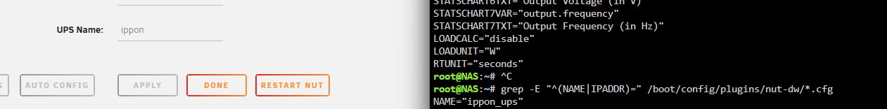

Bug in UI
If slave ups named something like "ippon_ups" onsaving all, including _, will be truncated for ex. to ""ippon" so no status\info on page\widget. (or no connection at all if non-manual)
Screenshot
Screenshot Also HERE
Manual ovveriding in /boot/config/plugins/nut-dw/nut-dw.cfg works perfect, like
 sed -i 's/^NAME=.*/NAME="ippon_ups"/' /boot/config/plugins/nut-dw/nut-dw.cfg
Edited by MERKATOR
