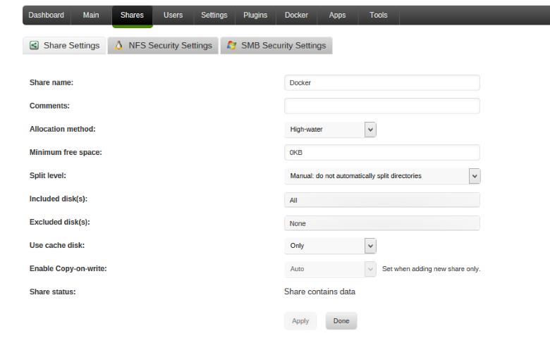

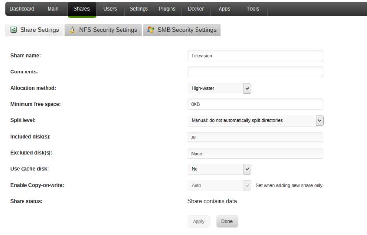

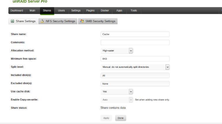

Attached are pics of the cache, docker user share, and television user share` settings. The television settings are typical of the other user share settings.
Below are the config directions of the two docker templates I have been trying to install.

Both dockers work but I would like to have the config files located on the cache disk.
I recommend that you not have a user share named Cache. It can only lead to confusion, and will literally confuse Windows if you ever try to look at the user shares and the disk shares.
And, it may have already confused you. The correct path to a user share named Cache is /mnt/user/Cache. And the correct path to the cache disk is /mnt/cache.
There is no path /mnt/Cache. Perhaps it is just a typo in your post, but if you are actually specifying /mnt/Cache/Docker instead of /mnt/cache/Docker, then your minidlna config is in RAM and will not persist.

Linux is case sensitive, so you must always be careful with case. It is not a question of using all lower case letters, it is simply a question of being consistent. Cache is not the same as cache, and Docker is not the same as docker.
Probably you accidentally created a user share named Cache. User shares are just the combined top level folders of cache and array disks. You will get a user share if a top level folder exists, even if you don't explicitly create that user share in the webUI.
Your screenshot seems to indicate that you do indeed have a user share named Cache, so at some point you must have specified /mnt/user/Cache or something like that. Or maybe you did create a user share named Cache in the webUI. So you now have a top level folder on cache and/or 1 or more array disks named Cache.
You also mentioned a path that started /mnt/Cache. That is not the same as the cache disk, which is at /mnt/cache. It is also not the user share named Cache, which is at /mnt/user/Cache. When you specify /mnt/Cache, that path isn't actually located on any disk. Instead, it is in RAM, since everything that is not on flash or a disk is in RAM. Anything at /mnt/Cache will actually disappear when you reboot.
Before you do anything else to clean this up, you need to fix your dockers so they are specifying the correct paths. Otherwise, you will just get the same mess again.
Then, you will need to delete all the files and folders in the Cache user share before you can delete that user share in the webUI.
And here is where it gets tricky. If you have your cache disk shared, and you also have a user share named Cache, Windows won't be able to tell them apart, and will just pick one to show you. So if you are trying to use Windows to delete the files/folders in the user share named Cache, it is possible that you will end up deleting everything from your cache drive instead.

Now, the question. I have a user share called "Cache" created from a a top level share on disk 4 by that same name. My cache disk is labeled "cache.
I need to delete the "Cache" share. Once I do this I think I will be fine. The problem is that I cannot delete the Cache share on disk 4. I have Googled this , but most solutions discuss what to use, and very little about what syntax to use. I can open telnet. but do not know where to go from there. With Midnight commander I am at a lost as to how to get my network, and the server. Someone suggested using a delete button on the share's setting page, but did not find one. By the way, the Cache directory on disk 4 is empty.

If the share is truly empty, you should get a delete button. Are you sure it doesn't also exist on other disks?
I have 6 disks plus the cache drive. Disk 4 only has the Cache share and it is empty. However, the cache drive has identical shares, and they are also empty.  I have included a pic for each of the two disks in question.

If these are screenshots from Windows, then like I said, Windows can't tell the difference between a user share named Cache and a disk named cache. So we don't know what you have there.
Go to Global Share Settings and turn off Disk Shares. You don't really need them to fix this problem, and I don't think you need Disk Shares at all if you use User Shares correctly. I always recommend not sharing disks and only using user shares. Not only can disk shares cause this problem, but you can also cause actual data loss if you mix user shares and disk shares when moving or copying files.
