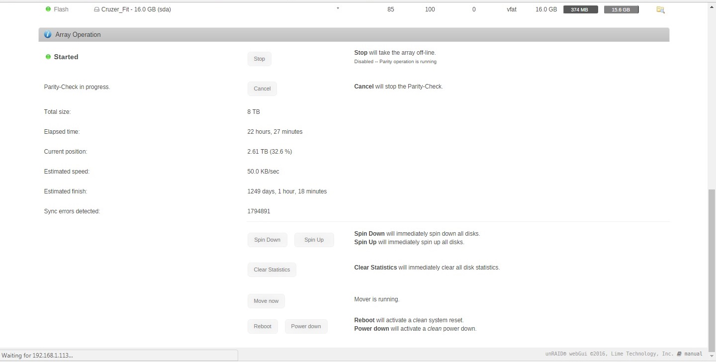

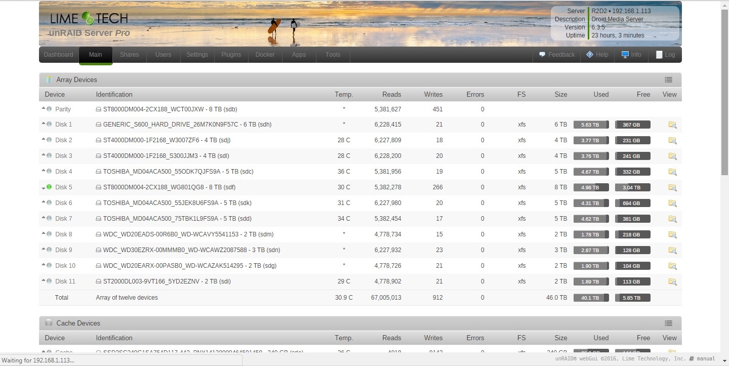

It's been awhile still have the same kind of problem going.
I have  updated the BIOS to the latest available recommended from help from MSI.  I also replaced thermal paste on the processor which appeared to be little aged. RAM memory test as a separate program from a USB jump drive even after doing a memory test which is the same program used in the unraid before launching unraid recommended from a computer tech friend to try. Both Mem test programs use passed without errors many times. I also tried a separate memory stick in the server one at a time for at least 5 passes some went longer from being away from the system.
Also Replacing the marvel chip SAS card that I had with a new 9211 card recommended here in the forums still no difference. Except a speed boost seems to be present. Weird but cool
Run parity check with all the dockers off I get through say 2tb the out of 8tb the and run into all kinds of errors tried to capture log before I notice it spun down at all drives except one. Number 5
I have an identical unraid server system as far as motherboard processor and memory are concerned have not replaced its Marvel SAS card I don't have any problems with that particular one on the same software 6.3.5 as it finishes parody checks without issue also 8tb.
Sure could use anyone's help in fixing my problem I feel like I'm down to motherboard or processor or maybe still memory or memory slots. Then again it could be anything else that's why I'm asking you the experts.
Thank you for your time I hope I can resolve this soon I had wondered about falling back one more software revision as I wasn't having problems before. But it's strange how I'm not having problems on the other system just talking out loud as it may not be software.
